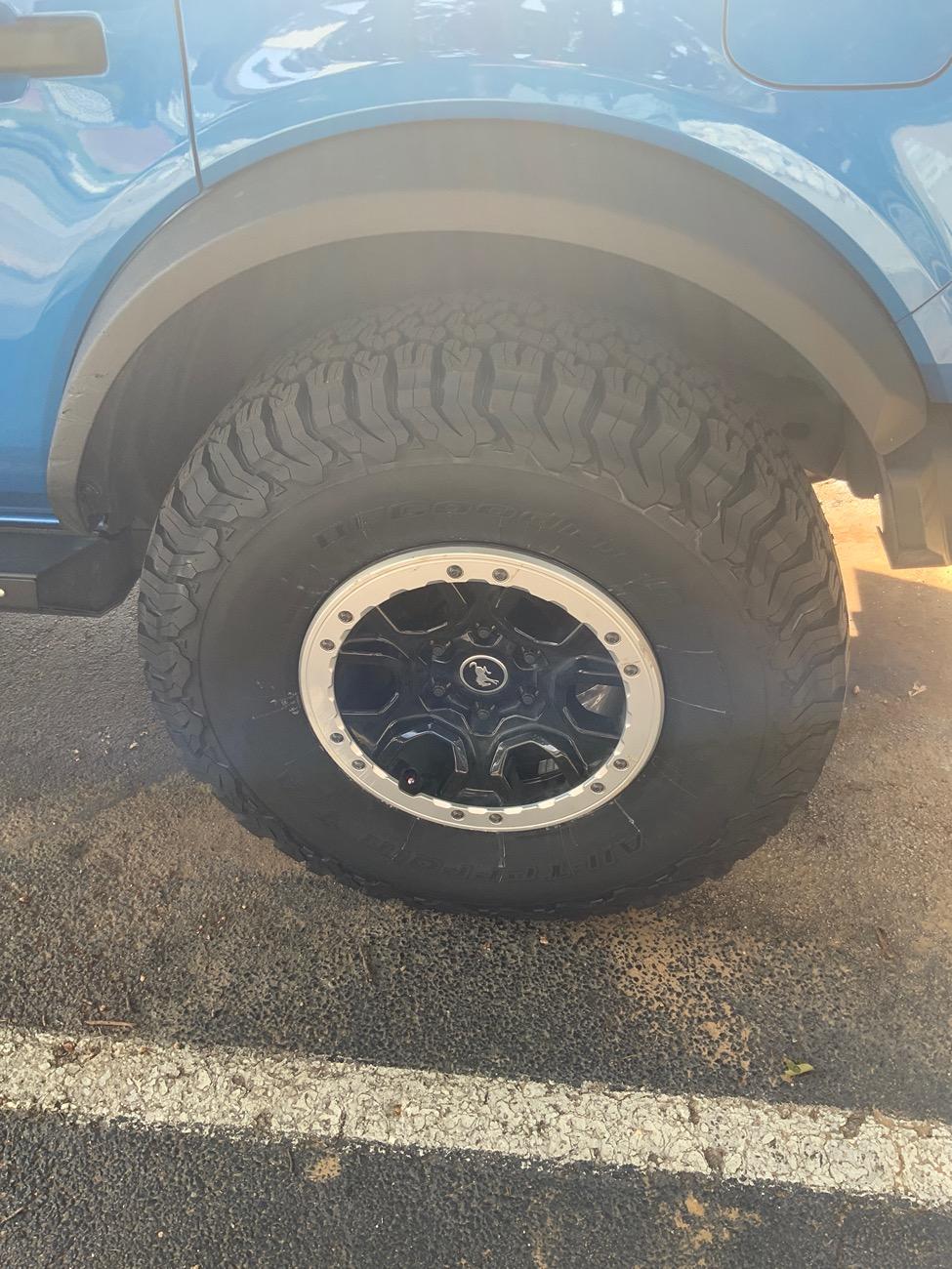

however…. This is what I ended up doing. I am NOW running KO2’s 36x12.50r17 on my OEM beadlocked rims. I didn’t want to change out my rims as I have the Beadlock rings put on it, and the cost of buying true beadlock rims is way more then I could spend on buying the beadlock rings ($850 for a set of 5)

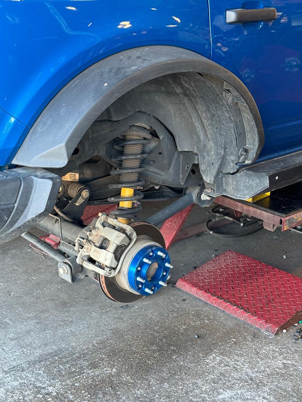

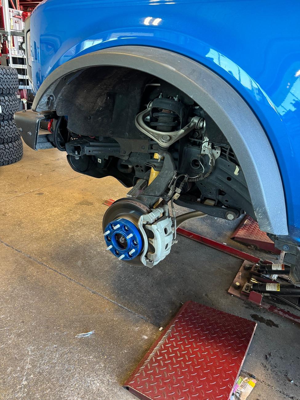

I Did the 1.5” pech collar mounts from BroncBuster, and did 1.25” hub centric. spacers from spidertrax.
Those two modifications are the only modifications I did, and I have Absolutly no tire rubbing anywhere Even under full turn left/right and under full flex with sway bar disconnected.
For me, all is right in the world.
just thought I would let others know who have a badlands SAS and want to run 37’s on their badlands SAS OEM beadlock capable rims.
Updated with photos:
Ford Bronco Bronco Badlands SAS on 37" Tires + Factory OEM Wheels…. For What It’s Worth. img_1411-jpe
Ford Bronco Bronco Badlands SAS on 37" Tires + Factory OEM Wheels…. For What It’s Worth. img_1410-jpe
Ford Bronco Bronco Badlands SAS on 37" Tires + Factory OEM Wheels…. For What It’s Worth. img_1409-jpe
Ford Bronco Bronco Badlands SAS on 37" Tires + Factory OEM Wheels…. For What It’s Worth. img_1405-jpe
Ford Bronco Bronco Badlands SAS on 37" Tires + Factory OEM Wheels…. For What It’s Worth. img_1406-jpe
Ford Bronco Bronco Badlands SAS on 37" Tires + Factory OEM Wheels…. For What It’s Worth. image-

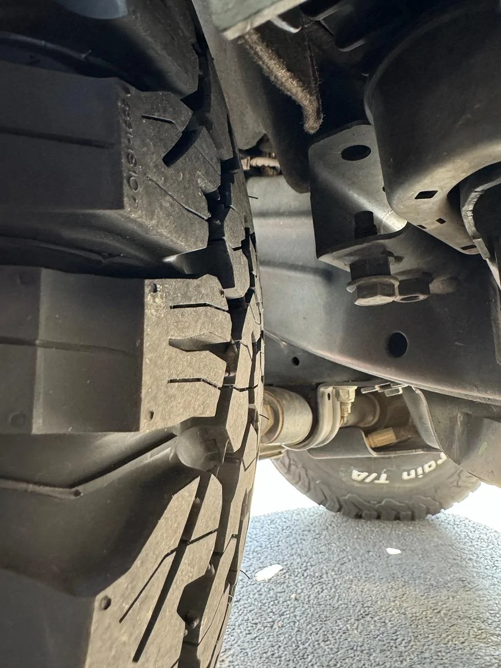

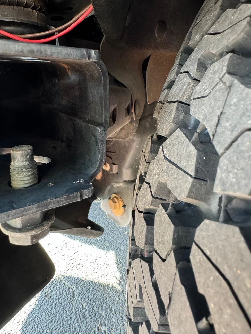

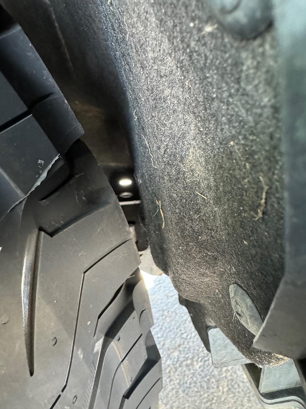

It Seems a little tight on hard turns, and even when flexed it was close, but I will admit it wasn’t extreme flexing when I checked. But then again because of strains on steering components and cv axels, I don’t plan on doing anything where I would need extreme hard turn and extreme flex at the same time.
i have been wheeling for years with various vehicles and have never had to do any hard left right steering while doing extreme flex at the same time.
i guess if I started to come across that with issues, I could add a spacer at the top of the coil over, and go to 1.5” wheel spacers instead of the 1.25” spacers.
or even just get the JKS kit installed. My JKS didn’t include anything for the rear tires.
Also if the issue is with the rear crash bar mount and not the front, one could easily do a partial install of the JKS kit as removing rear crash bar mounts are much easier then removing front crash bar mounts as well.
i don’t plan on going bigger then these KO2’s
all the clearances in the pics We’re no less then 1.25”

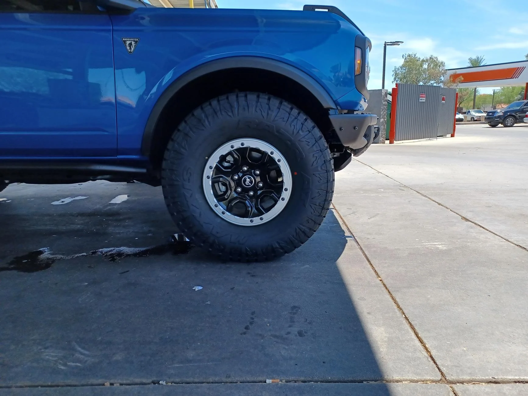

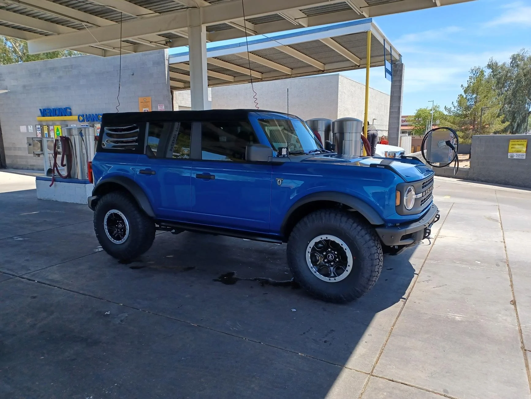

Yeah I did this a few years ago. Have some posts on the forums in threads also. Stock rims have the best offset for 37s , I used no spacers. Have wheeled it with stock sasqatch suspension, and now with just a 1in level kit in front. My tires are a hair smaller like BFGs than other 37s also which helps. It is possible
Ford Bronco Bronco Badlands SAS on 37" Tires + Factory OEM Wheels…. For What It’s Worth. inbound5385424601436886111
Ford Bronco Bronco Badlands SAS on 37" Tires + Factory OEM Wheels…. For What It’s Worth. inbound7873126952775335542
Ford Bronco Bronco Badlands SAS on 37" Tires + Factory OEM Wheels…. For What It’s Worth. inbound2526681024130329646
Ford Bronco Bronco Badlands SAS on 37" Tires + Factory OEM Wheels…. For What It’s Worth. inbound542085317926986838

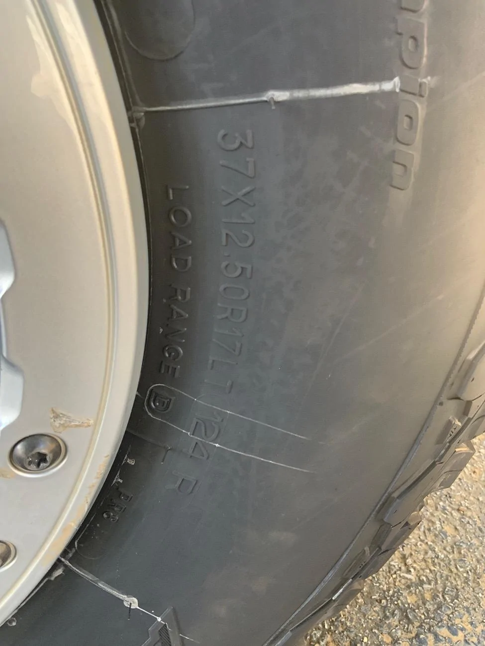

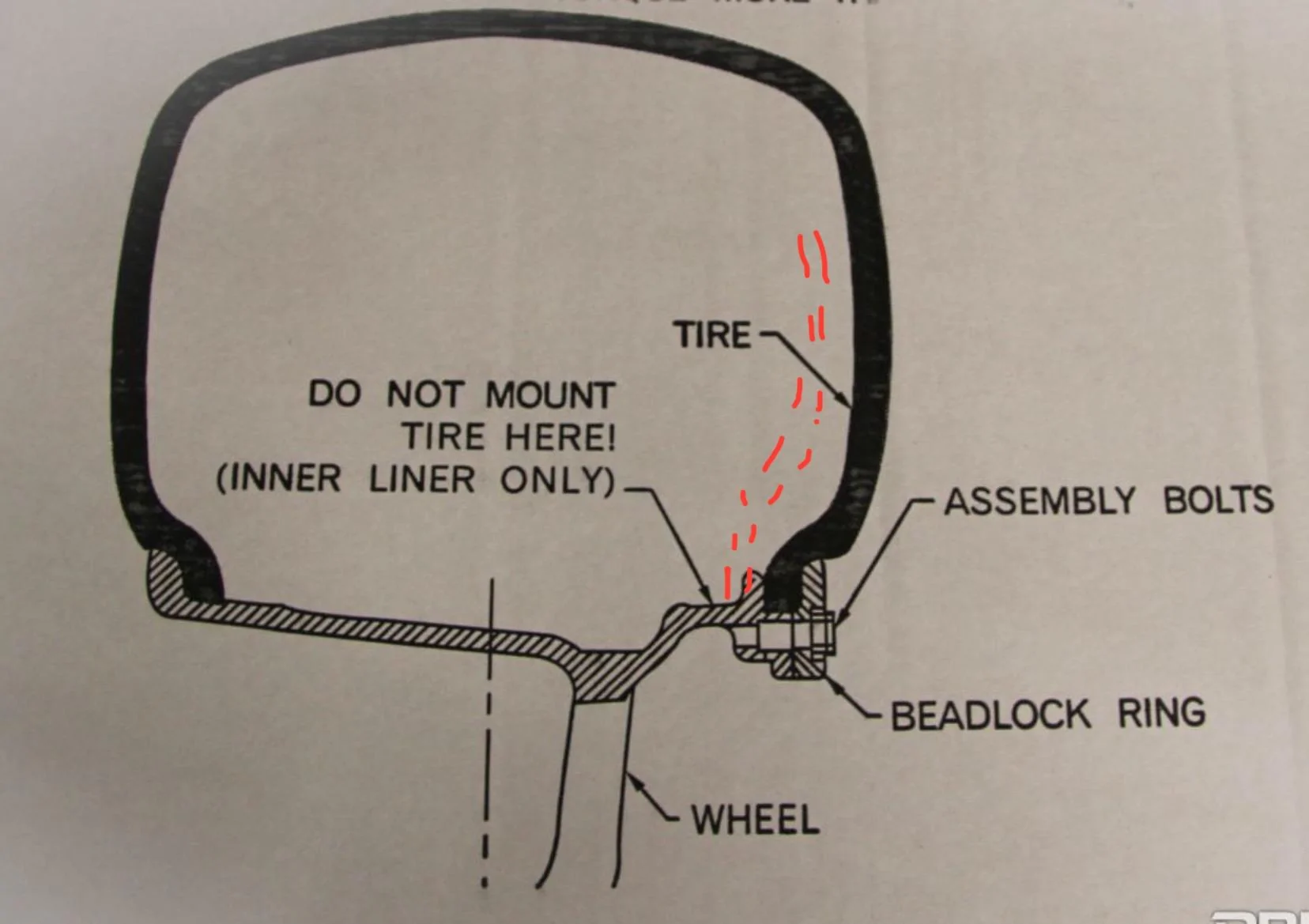

Your pictures and words don’t match. Pics are beauty rings not true beadlocks. When/if you go to actual beadlocks the tire will set outside the normal wheel bead (when beauty rings are used) and be secured by the true beadlock kit.
I mention because the mounting variation pushes the tire out a little so on tight fitment/clearance true beadlocks may be helpful.
Diagram below shows red marks to identify where tire would mount with standard wheel beads/beauty ring setup. The back/inside wheel bead doesn’t change but the shift of the outer bead position positions the tire a little differently, similar to a wider wheel where you don’t get as much sidewall bulge
I also like less negative offset solutions. Less scrub radius and wear/tear effects.
But you hit the nail on the head IMO. *Actual* tire size matters greatly. Some tires run larger than others and may mean the difference between fitting or not when all else is equal.
