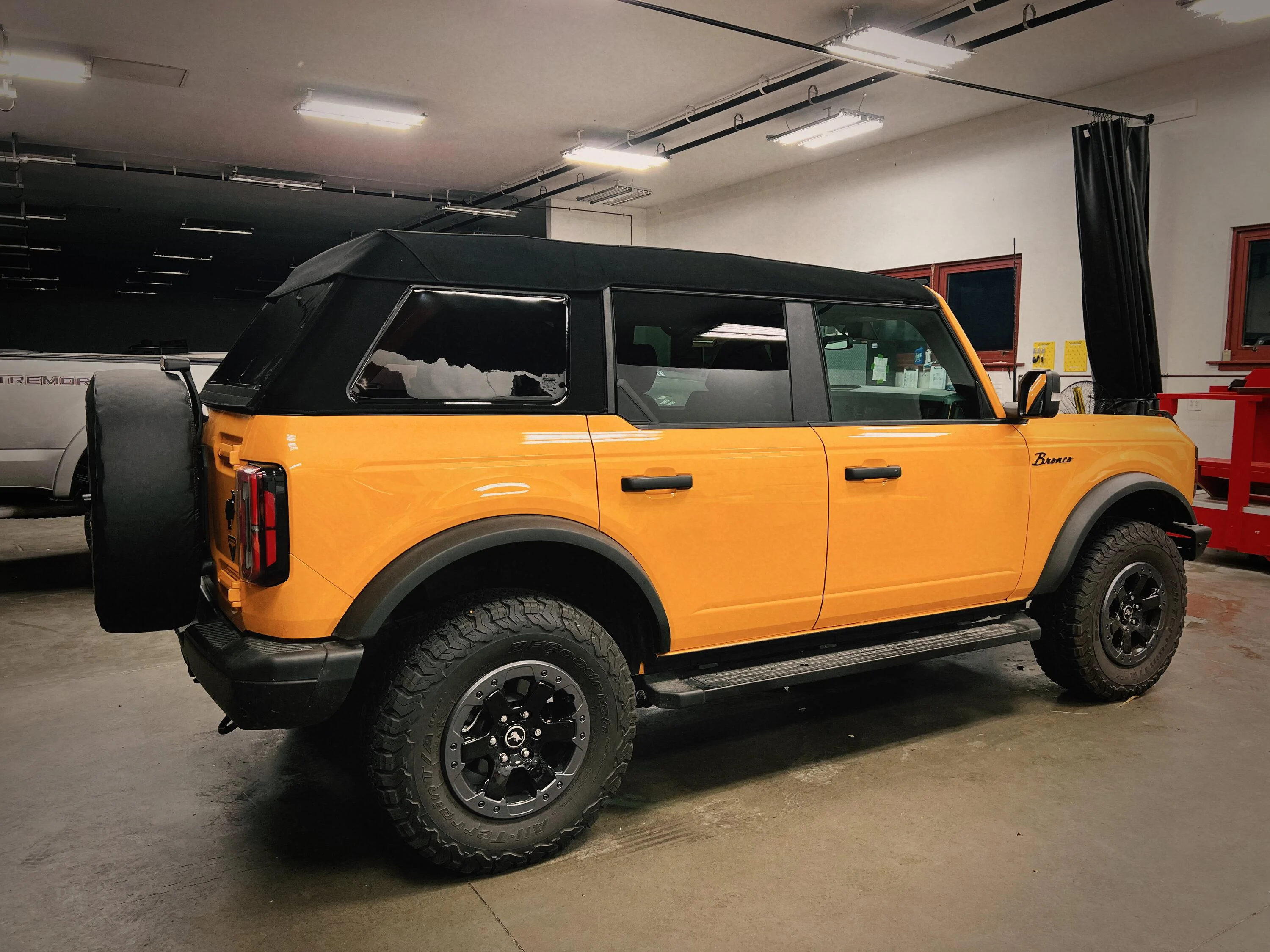

Hello!! We just installed the Bronco BestTop last night on my four door Badlands. Looks awesome and love it! BUT having latch issues. Drivers side will unlatch (by the visor same as the factory soft top) however the passenger side just can’t get. It’s like I unlatch it then the top wants to spring up, catching the latch hook, before it releases. Only way to get it is to have someone push down hard on the top while a second person tries to wiggle the latch out. I let it sit overnight to see if the top would stretch and it seemed to only get tighter. It does seem to be a known issue but only saw ideas on Wrangler forums and none work for me. Anybody have ideas?!?

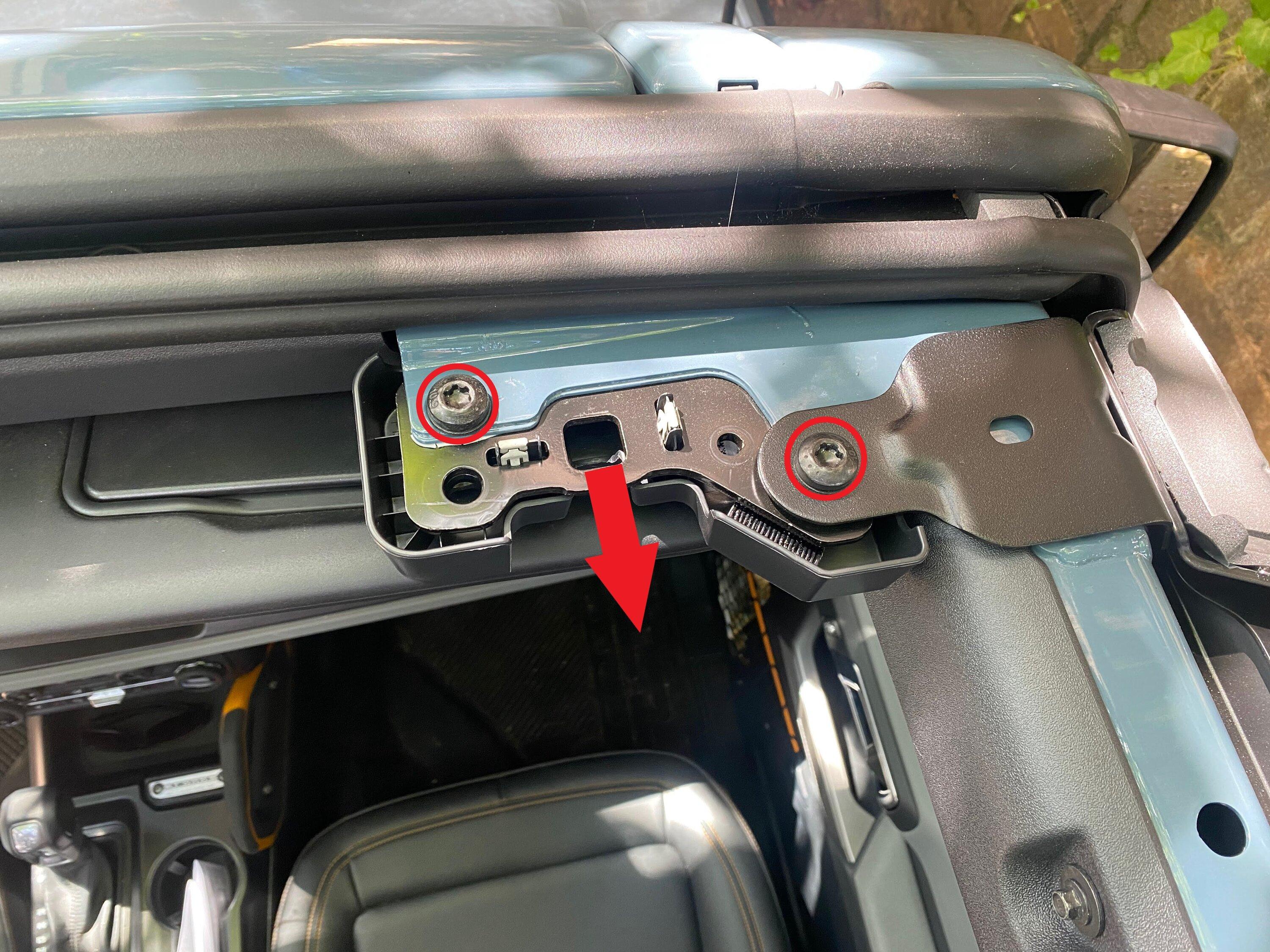

I loosened the bolts on the attachment point above the passenger and pulled the plate toward the rear of the truck and then re-tightened the bolts. It helped a lot but if I let it get crooked it is still hard to open.

So here is what I'm talking about, loosen those two bolts and pull the black plate back with a pair of pliers while re-tightening the bolts.
