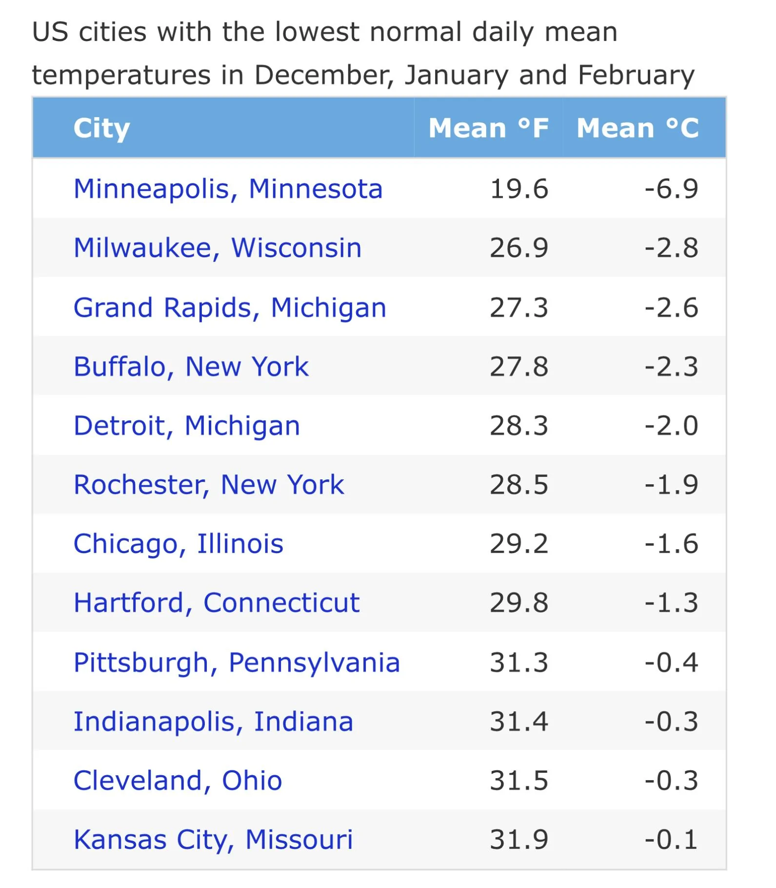

FWIW, Iā€™m in Minneapolis which is by far the coldest large city during the winter in the U.S. Itā€™s fun to know that we will be wintering in Naples from now on which along with Miami is the warmest winter spot in the USA outside of Hawaii. :)
