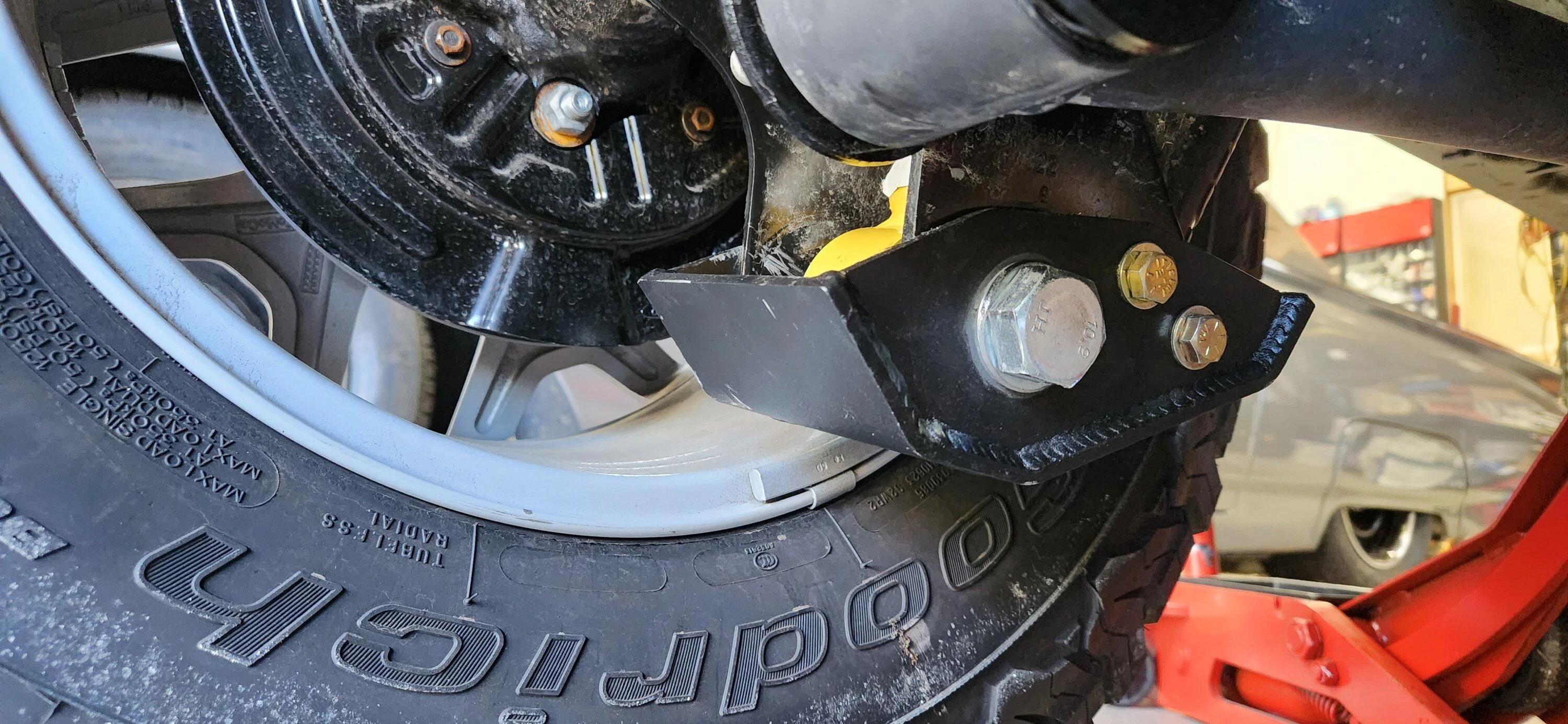

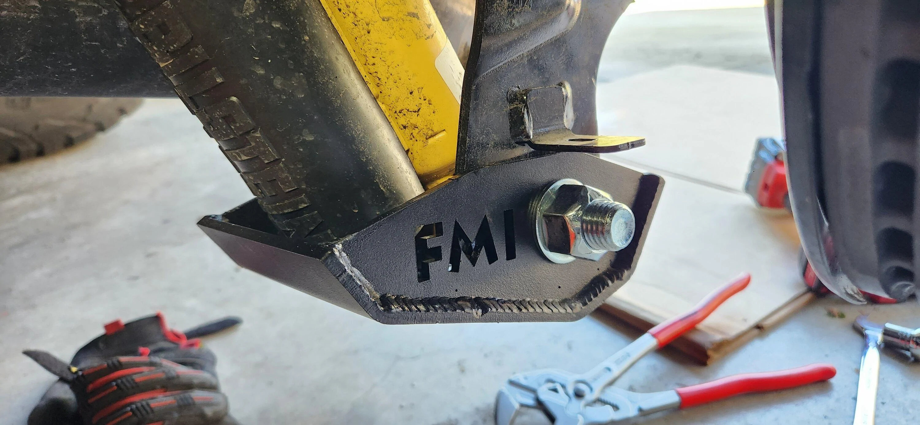

Just wanted to chime in that I have your non-HOSS rear shock skids and, IMHO, they are the best skids in terms of robustness, coverage, materials used and design.
Where others have the vertical plates take the load against the weld, you have a stout plate take all the abuse without angled or formed side plates wanting to slide off of obstacles.
The down side is that in a few hundred years they will have rusted through. Hopefully the rest of the Bronco lasts that long!
Ford Bronco Bronco HOSS 3.0 specific shock skids by Foutz Motorsports 20230215_120132
Ford Bronco Bronco HOSS 3.0 specific shock skids by Foutz Motorsports 20230215_115422
Note for anyone on the fence:
I was able to install these by myself about 3 weeks prior to spinal disc replacement surgery. As long as you're using an adequately robust impact gun, you can remove/reinstall the shock mounting bolt no problem.
• The impact gun I used is a Milwaukee 1/2" drive mid-torque M18 fuel with 5.0 MaH battery (2962-20) for reference. Had no problems with the bolt.

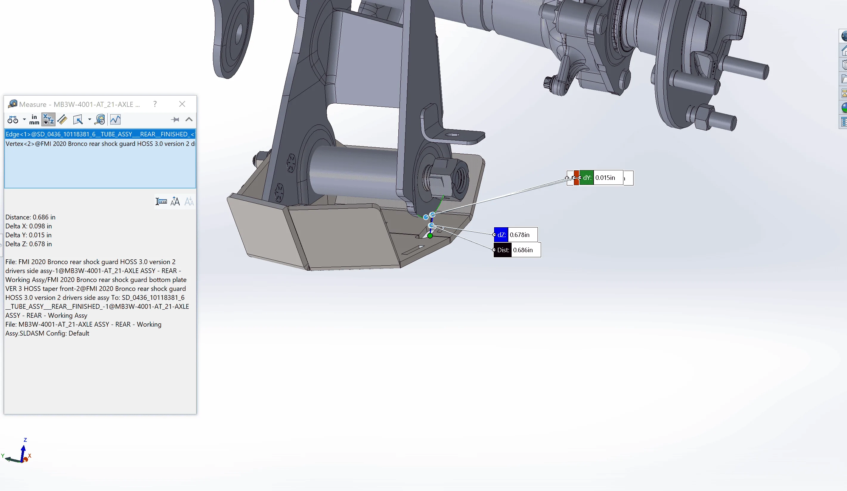

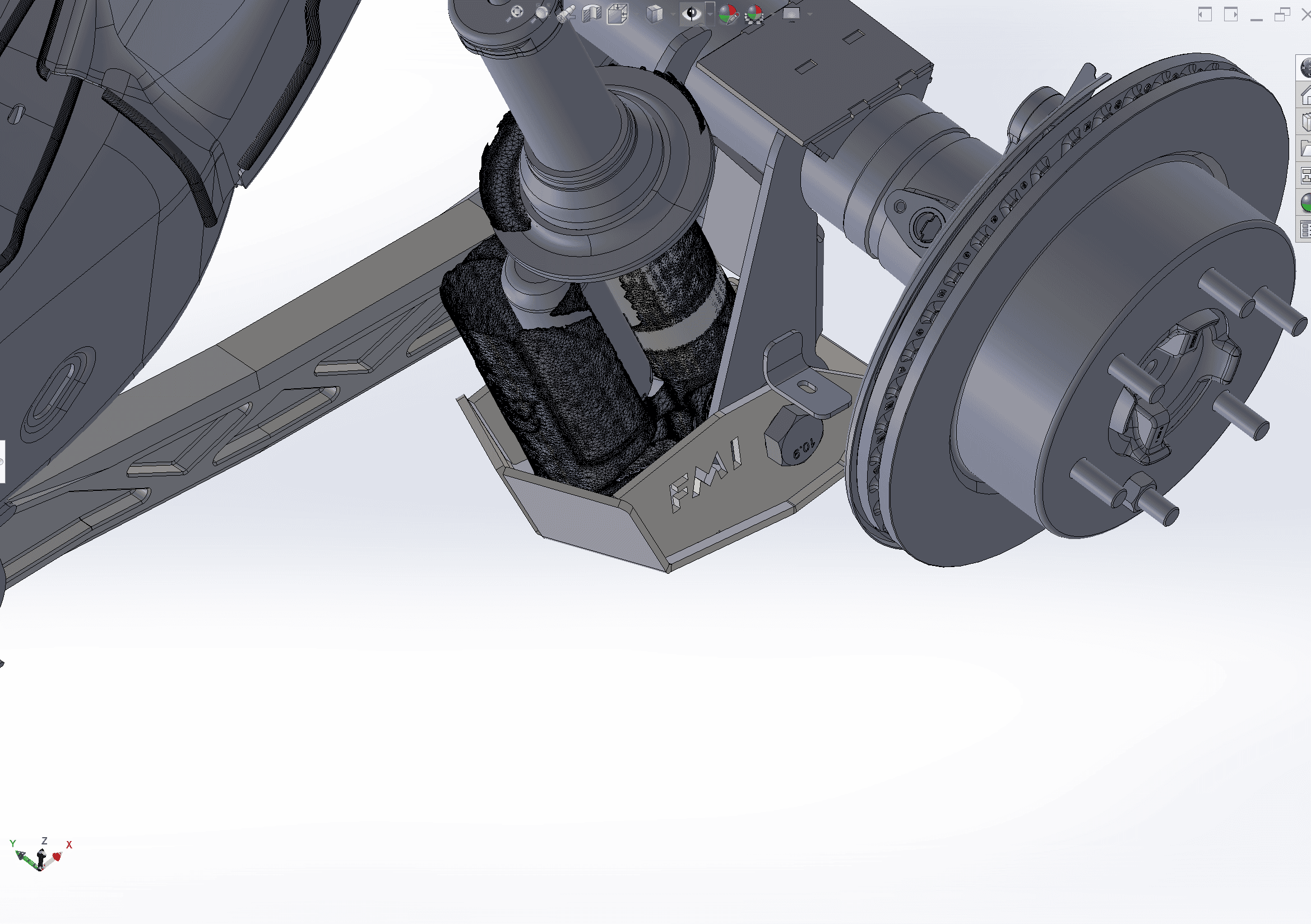

Should these work with other aftermarket coilovers? King, Icon etc? These 3.0 give more space under the bottom of the shock compared to the standard Shock skids correct? Thanks for all your help… Love all your products 😎🇺🇸
I would think so. here are a few screen shots to help That is the HOSS version which is bigger and allows more room toward the front.
Ford Bronco Bronco HOSS 3.0 specific shock skids by Foutz Motorsports 1699632529843
From the bottom of the shock mount to the top of the bottom guard plate there is over 5/8" room so I think they should all fit with no problem.
Ford Bronco Bronco HOSS 3.0 specific shock skids by Foutz Motorsports 1699632741000
Does that help?

EXCELLENT!! Thanks for the information.. Time to switch out my Barnes and buy these 😎
