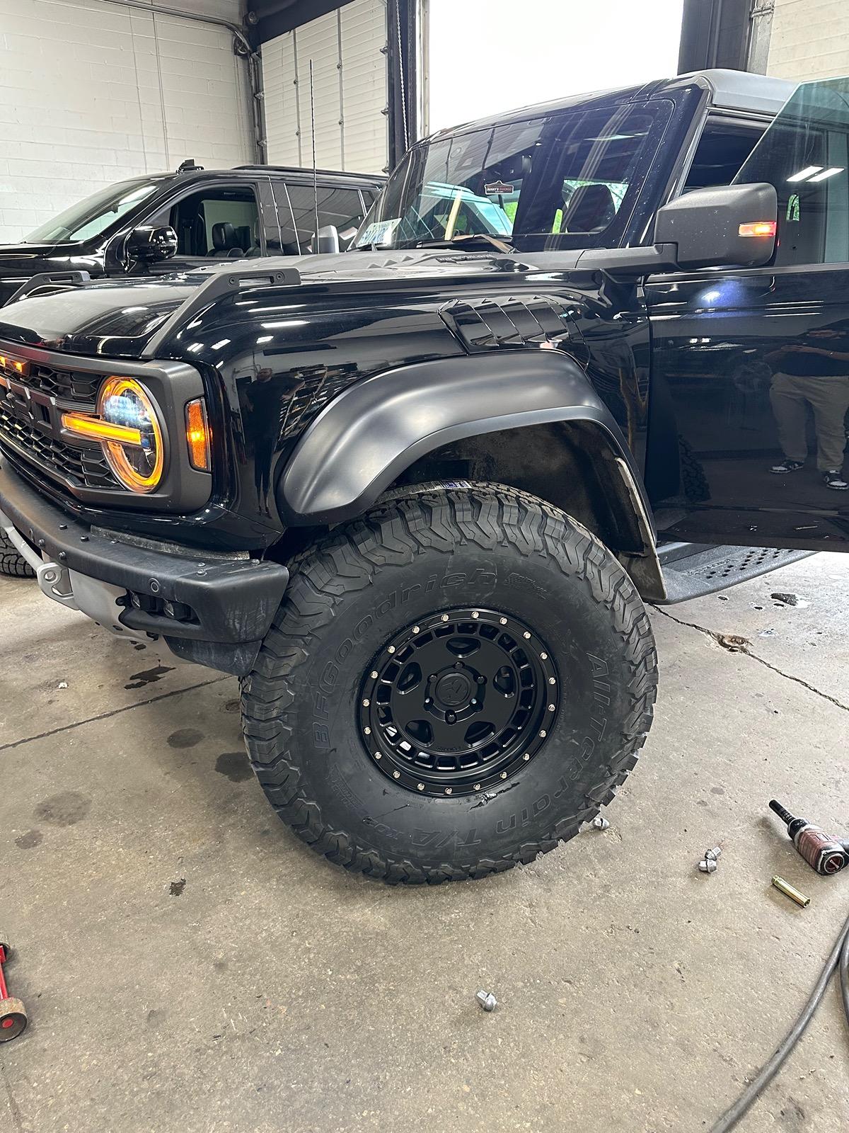

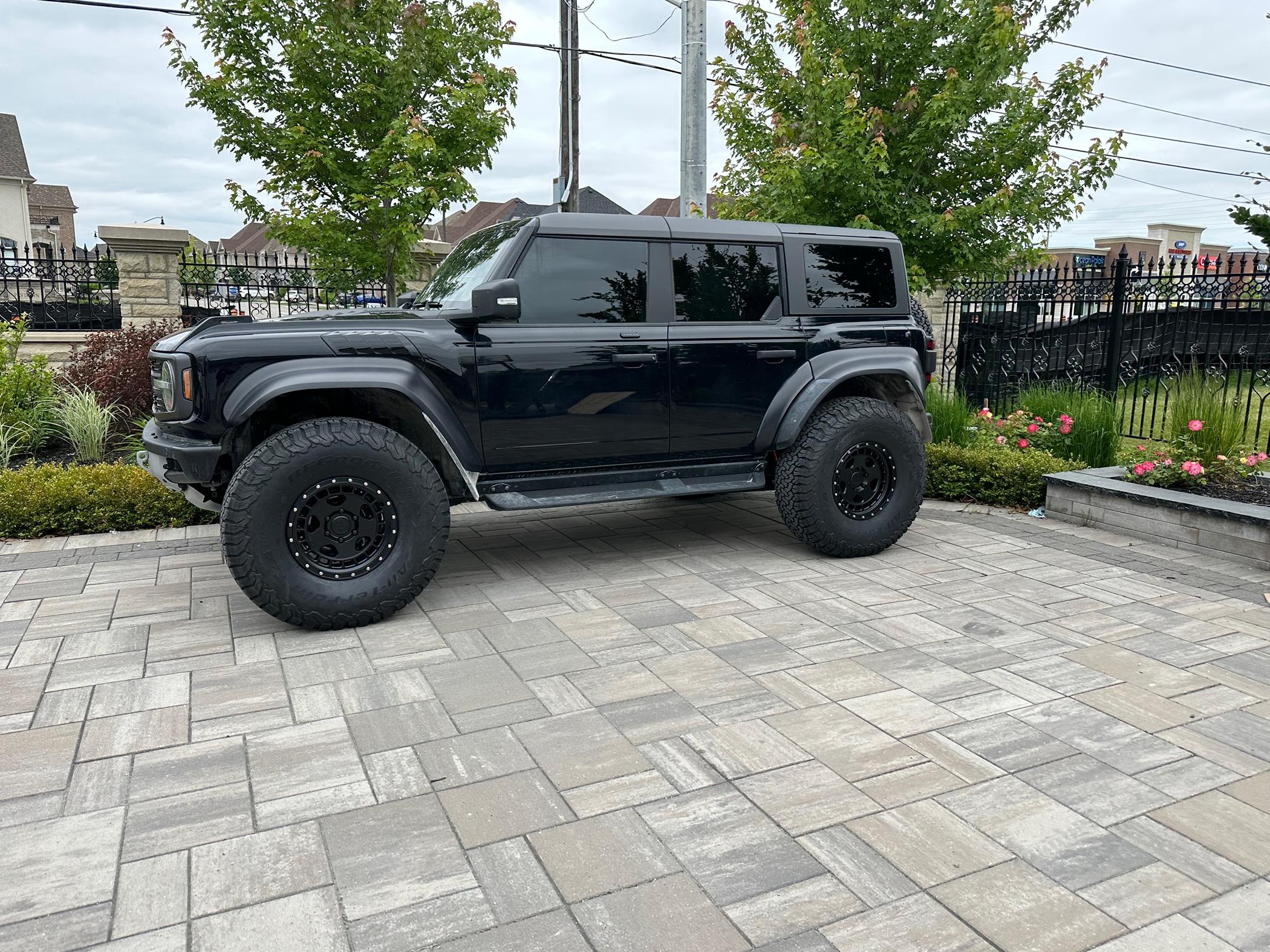

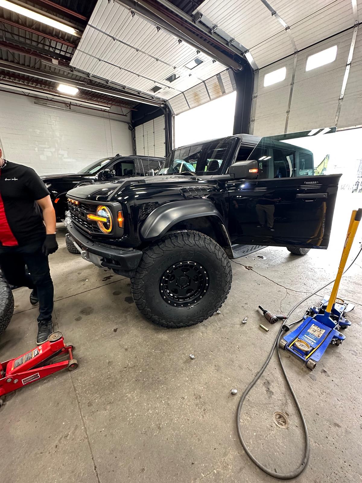

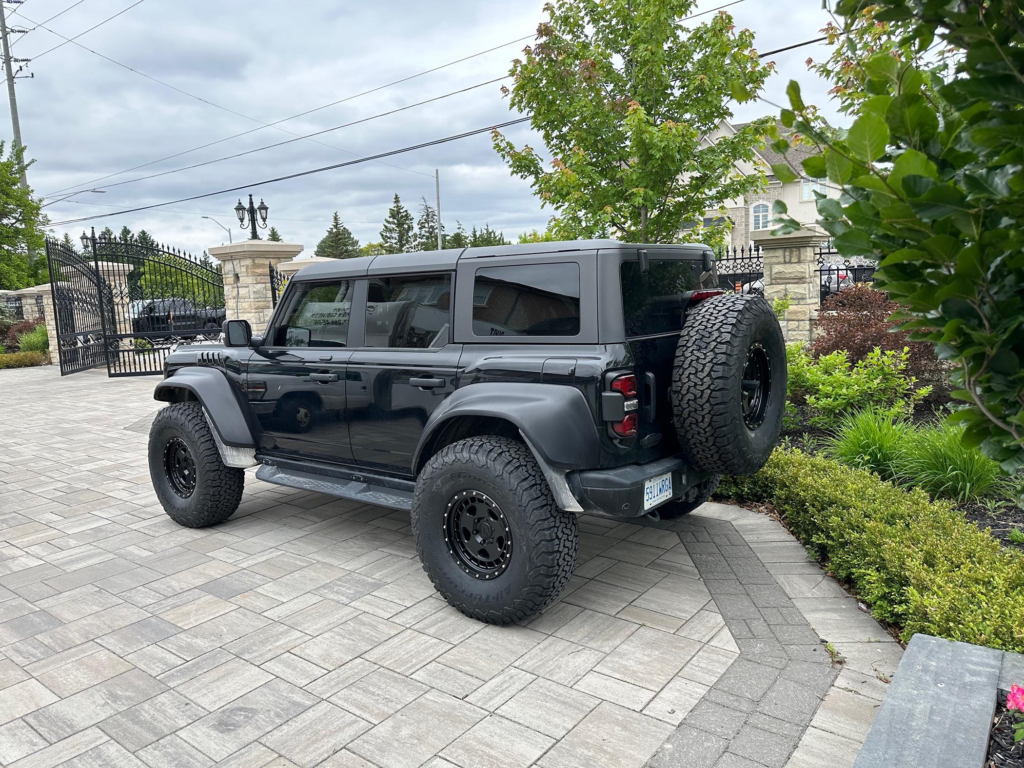

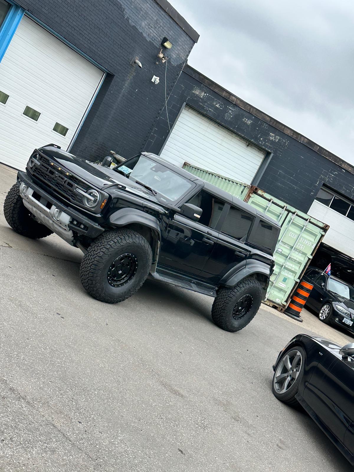

very minor rubbing on the front plastic piece under the front bumper. I just had it removed and it looks even better now. You can actually see the fox shocks from the front now
Ford Bronco Bronco Raptor on 39s AEAAB8B5-C497-464D-BC2F-664A75475BE8
Ford Bronco Bronco Raptor on 39s 8CD861DA-A31A-4A20-8494-82E6CCCB9E7F
Ford Bronco Bronco Raptor on 39s 960E2968-B06A-46F1-A172-37BA1E9C6BF7

I didn’t remove the light. It just got slightly covered by the tire. Still fit nicely.

I'd be highly concerned about your steering rack.
Look at the 74Weld if you are going to run that large of a tire.
Fitting big tires at ride height isn't hard.
You need to cycle the suspension at various steering angles to actually see if they fit.

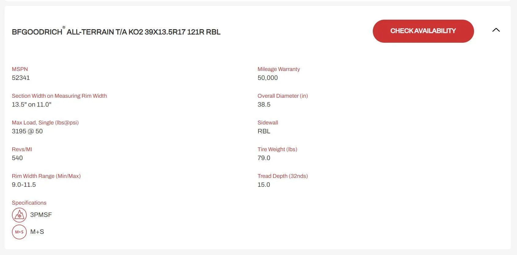

you can bust the rack with the OEM 37s if you try hard enough lol. 39 KO2s are small and dont weigh near as much as real 39s plus without any lift, you will rip the flares off before getting into harder stuff.

Maybe 15 lbs more than stock, but still 2" more diameter and an inch wider.
