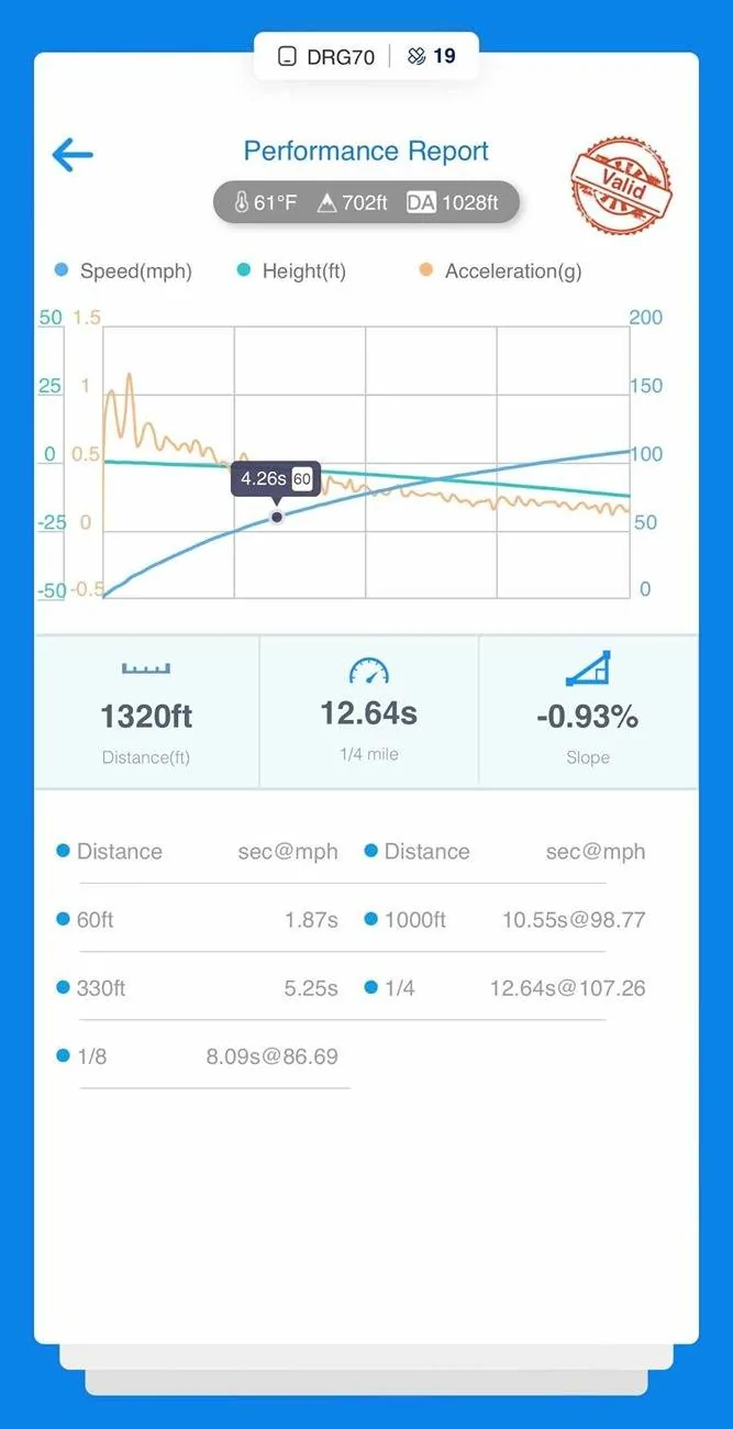

Check out these REAL-WORLD Bronco Raptor draggy results with our CUSTOM E50 tune!
Ford Bronco Bronco Raptor with ZFG Racing e50 tune draggy results! 1f680
Ford Bronco Bronco Raptor with ZFG Racing e50 tune draggy results! 1f4a8
Equipped with an S&B Filters intake and a Whipple Superchargers intercooler, this beast is ready to roar! Mid 12s on those 37" tires? Not bad at all!
Ford Bronco Bronco Raptor with ZFG Racing e50 tune draggy results! 1f60e
Ford Bronco Bronco Raptor with ZFG Racing e50 tune draggy results! 1f64c
Stay tuned for more amazing performance updates!
Mid-12's is crazy for the Braptor. As usual, Adam is going frickin awesome work!

Upcoming cooler weather should improve my run hopefully a bit. Kinda wanna borrow some stock c rated 37's off someone local and do a run. For science.
