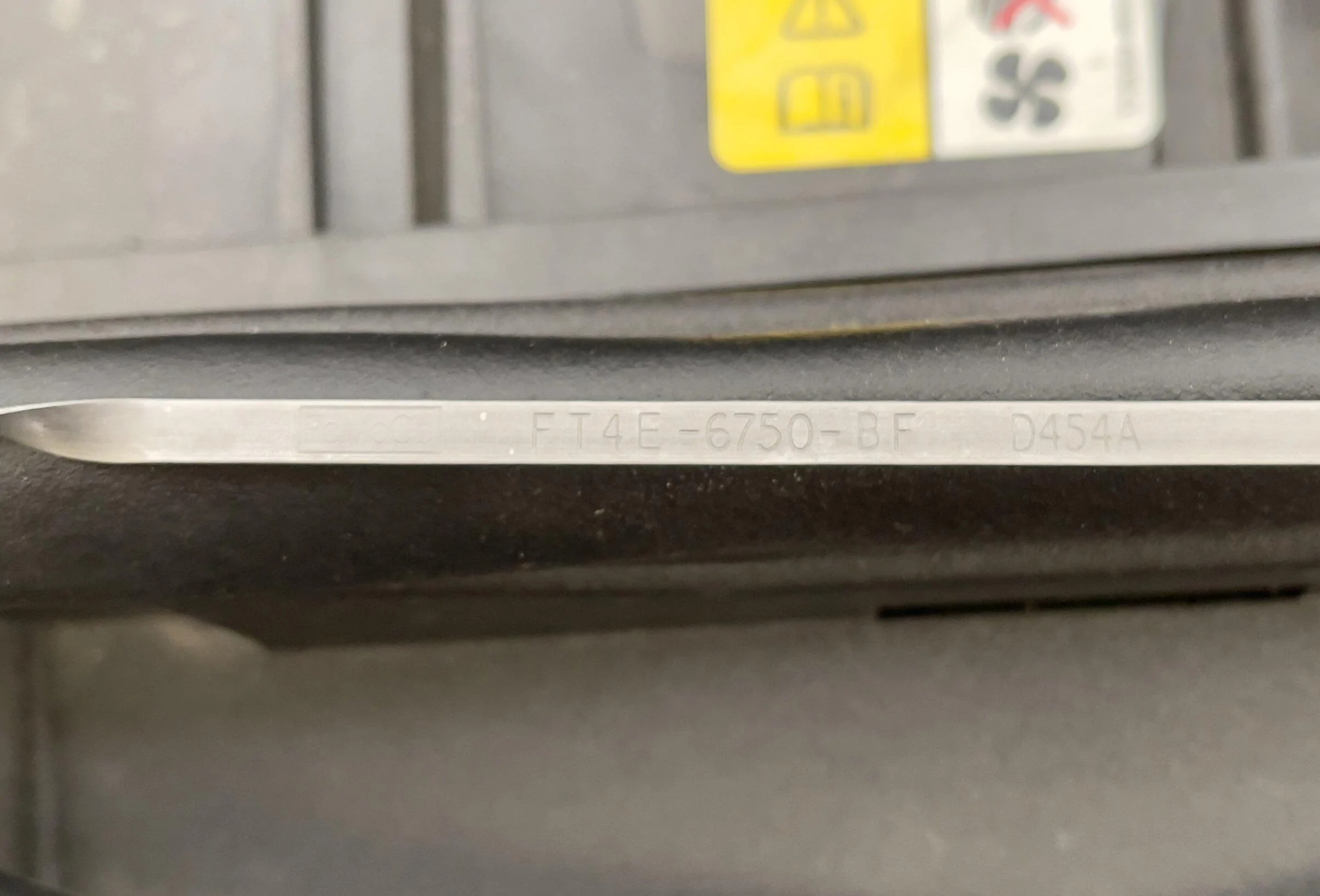

It was barely over the full line if i was to guess its probably 1/4 quart over the mark. When i checked it before the oil change it was also a little over so i'm leaving it as is. Here’s a pic of the stick numbers.

Ok, so here are the results, Now I specifically asked, and the service guy assured me, he put in exactly 7 quarts of Motorcraft oil. My dipstick now reads right where my fingernail meets the dipstick, above the MAX line. I checked 8 different times just to be sure. It read the same each time, and its bright and sunny out. So about my readings before and it being right on the MAX line the other day, either I misread it, (it was after dark when I did it) or it may have been underfilled and the dipstick was used as the factor for volume. So a little mystery there. Here is my dipstick and the part stamped onto it. My original build date was 7/23, then dirt mountain.

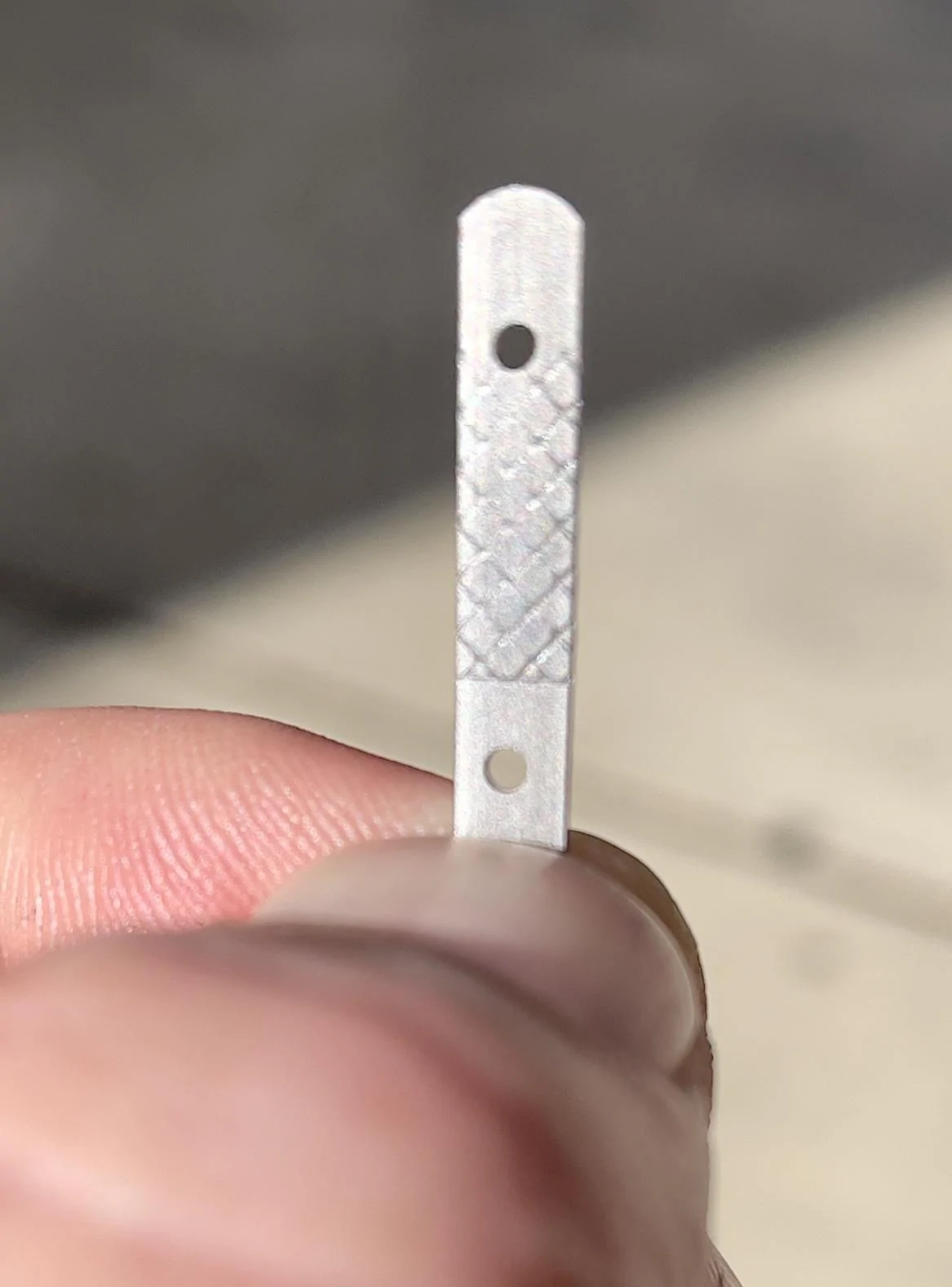

That looks like a different dipstick!! this is what mine looks like .... is your engine a 2.7?
Ford Bronco Bronco Team Engineering Confirms 7.0 Quarts for 2.7L Engine Oil Change is Correct dipstick
Same dipstick part number (engineering number, actually) as the rest, it appears...and (according to that particular stick) overfilled with 7 quarts. The mystery remains unsolved. At least yours is not halfway up the twist at 7 quarts. Part of the fun factor of owning a new Bronco I guess...diverse oil readings! It would be interesting to hear what your service advisor says if you bring up that after they changed your oil that it reads over the max line (which, according to the manual, should be immediately drained down to no higher than the full mark). I imagine your initial reading reflected most but not all of the oil prior to the full drain back time elapsing.
