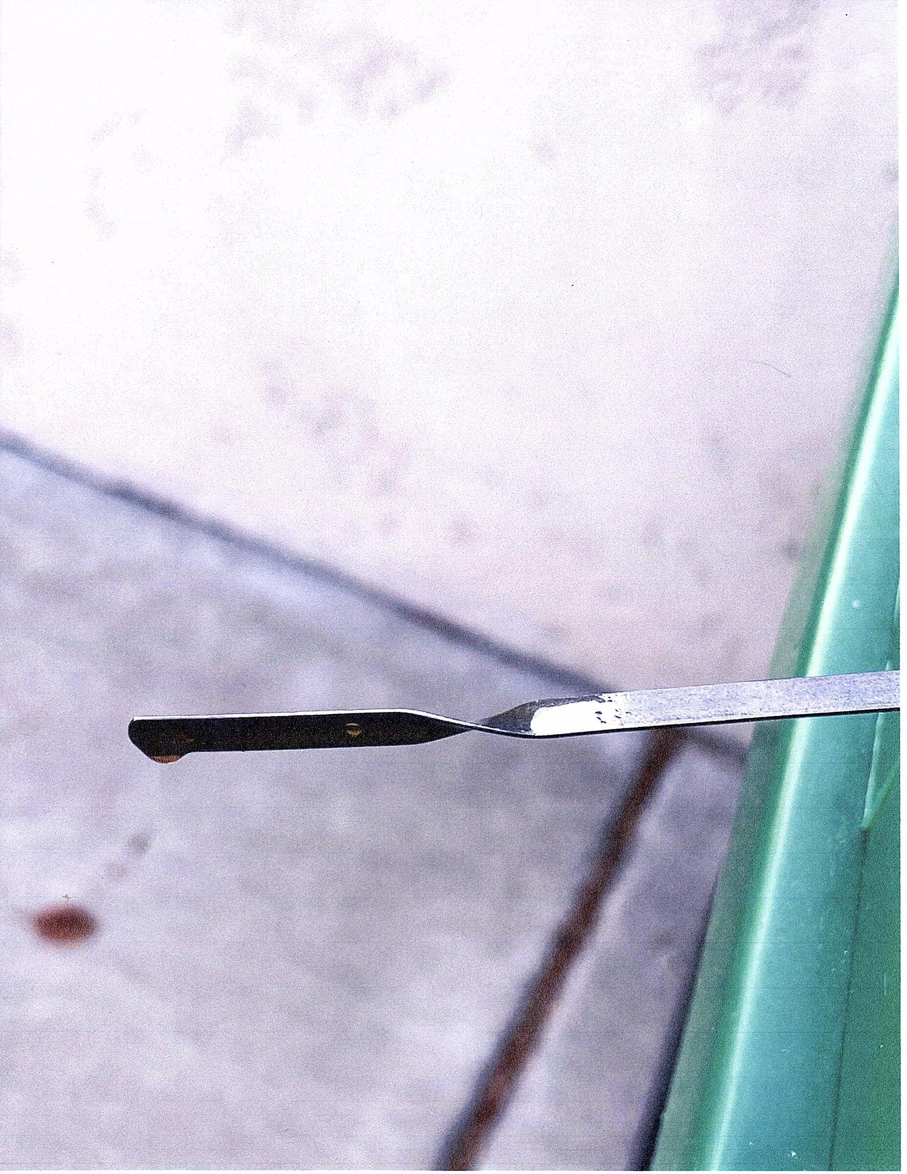

Someone probably already posted the dipstick reading before 1st oil change, but I just checked mine out of curiosity. I have 900 miles on it and it is just about 1/4” over the top mark.
That's where mine reads after exactly 7 quarts.

Same dipstick part number (engineering number, actually) as the rest, it appears...and (according to that particular stick) overfilled with 7 quarts. The mystery remains unsolved. At least yours is not halfway up the twist at 7 quarts. Part of the fun factor of owning a new Bronco I guess...diverse oil readings! It would be interesting to hear what your service advisor says if you bring up that after they changed your oil that it reads over the max line (which, according to the manual, should be immediately drained down to no higher than the full mark). I imagine your initial reading reflected most but not all of the oil prior to the full drain back time elapsing.
i refilled mine with 6.5qts
@Frankie945 doesn't look like it has the twist or ribbon whatever its called ... dont see the 2 holes either
They just are out of frame to the left. Compare where his numbers end on the left to mine. You Can just see it start to twist far left. It's the same.

They’re there just didn’t get it in the pic. Was snowing and cold I did it in a hurry. Tried to get pic of the actual oil level on the stick but but my phone wouldn’t focus on it. Wish the iPhone 12 had a macro camera lens.
