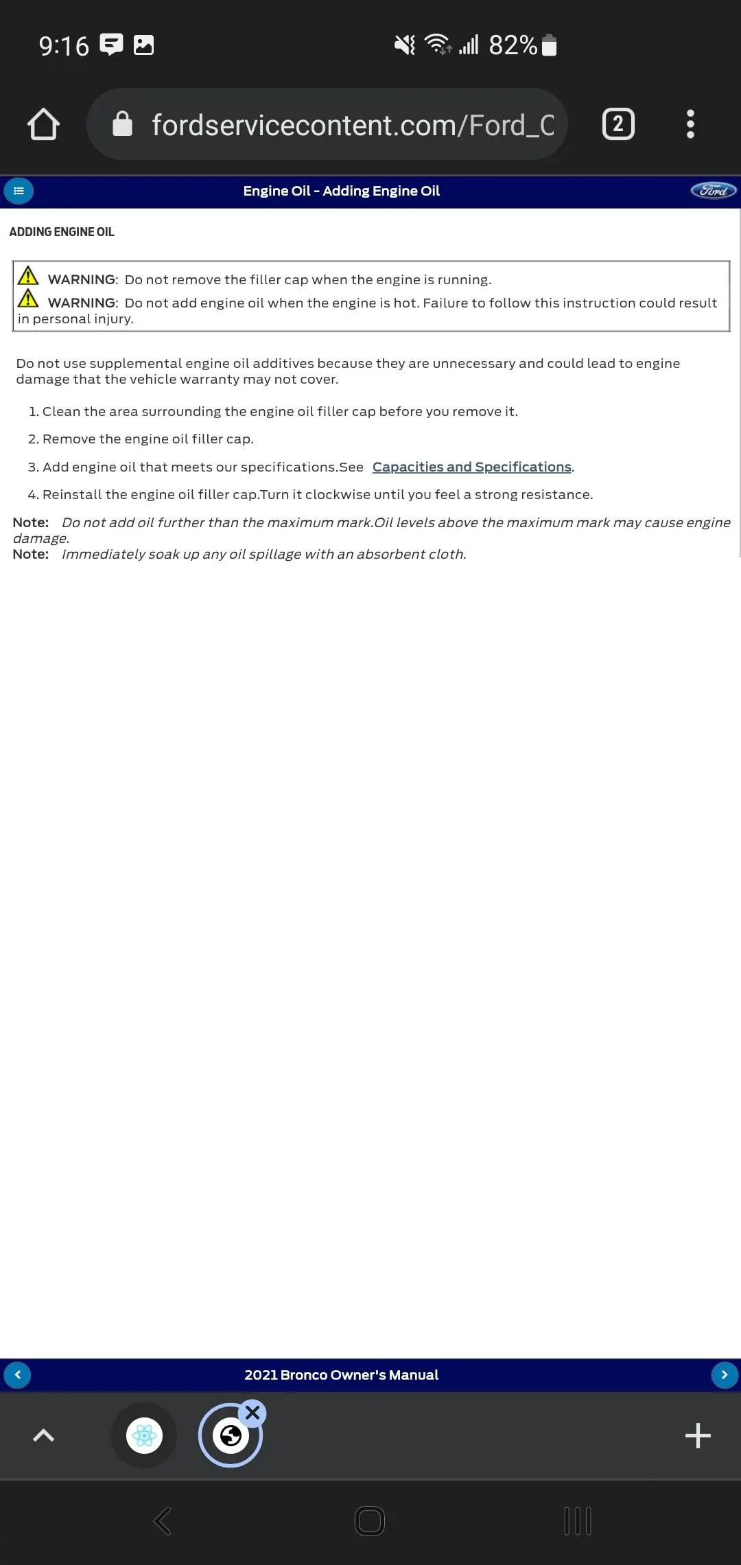

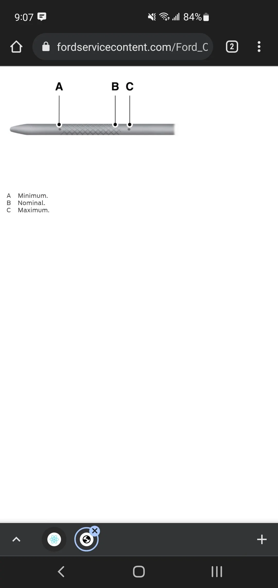

Maybe Ford needs to produce only electric cars if their engineers can't figure out how to provide an accurate dipstick (something they used to be able to do even many decades ago). Additionally, let's try to find some common ground and define "a little." I personally consider "a little" as, for example, the distance between point B and C on the attached image. On my stick, and as shared by many other folks on this forum regarding their sticks, at 7 quarts our "full" mark is 1/2-5/8 inch above the MAX mark. That seems more like "a lot." ESPECIALLY when "the manual" clearly indicates "do not add oil above the maximum mark (even" a little) or engine damage may occur.

I am still confused because although the manual calls for 7 quarts it also indicates (warns) to not add oil above the max level on the stick. Conundrum...
YEP .... and Ford is doing nothing about this EVEN though they are fully aware of their contradictory instructions
