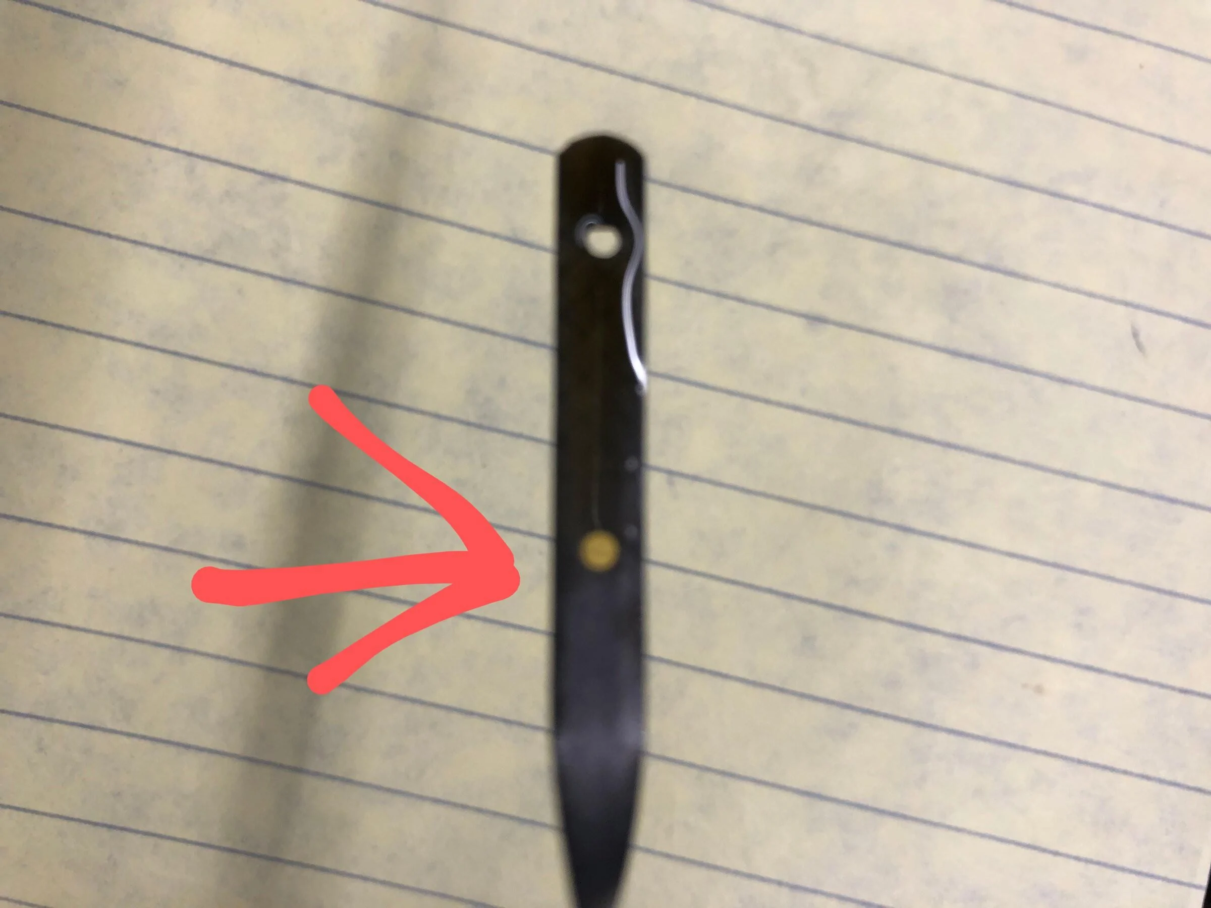

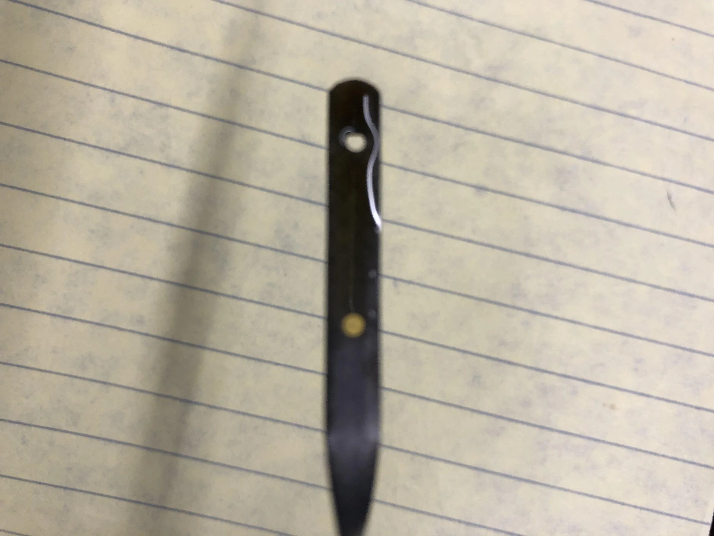

Based on your pic, you are either a quart low, or they finally fixed the dip stick.
Looks like your oil is right at the max and NOT into the twist like everyone else's.

How can you tell when his pic is blurry?
I have old eyes, but is not that blurry 😁
You can see the wet oil stops and the middle of the stick is dry right at the red line.

Note too all .... If you are going to post a pic where details are important, please do NOT post a blurry pic.

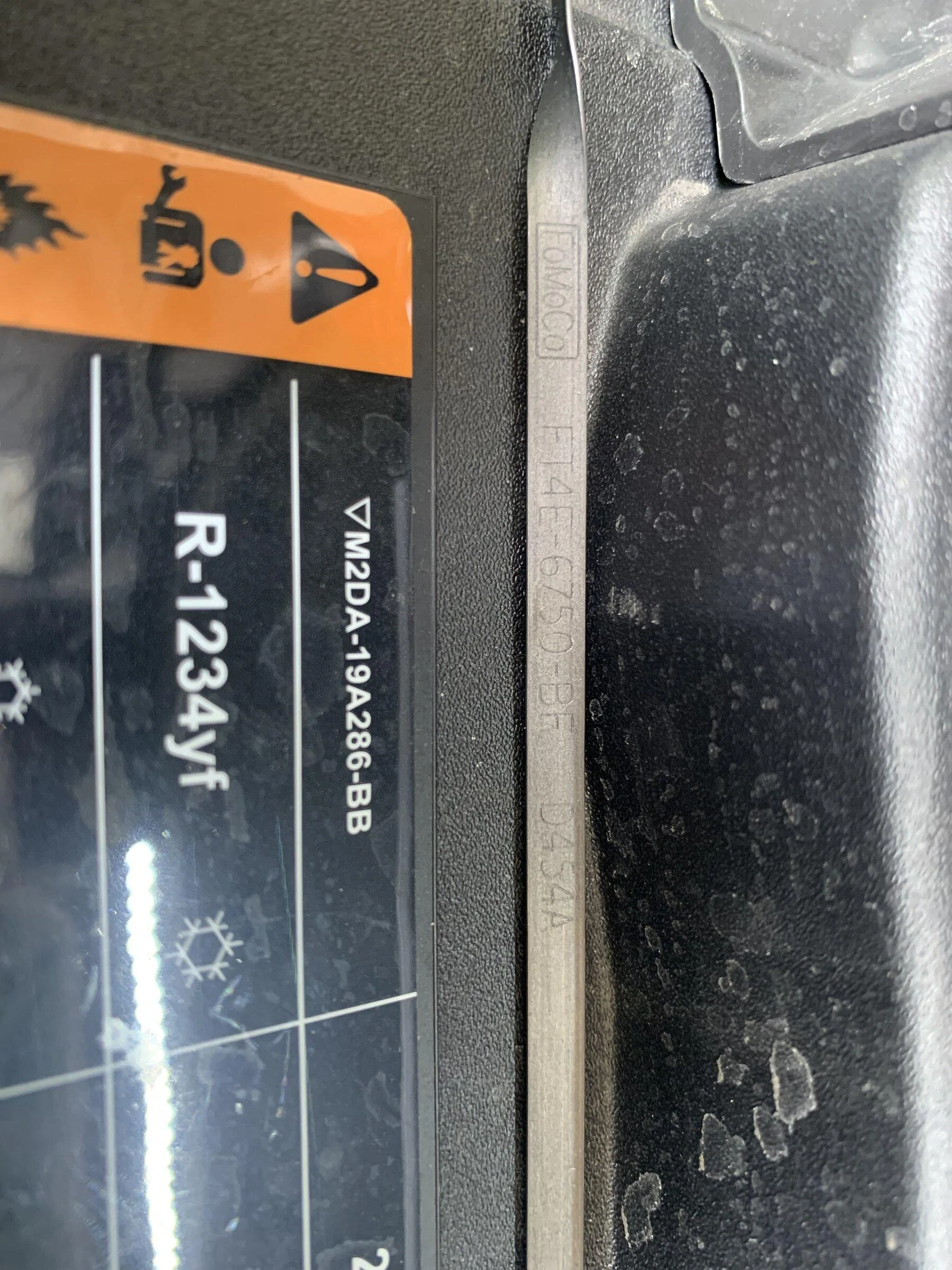

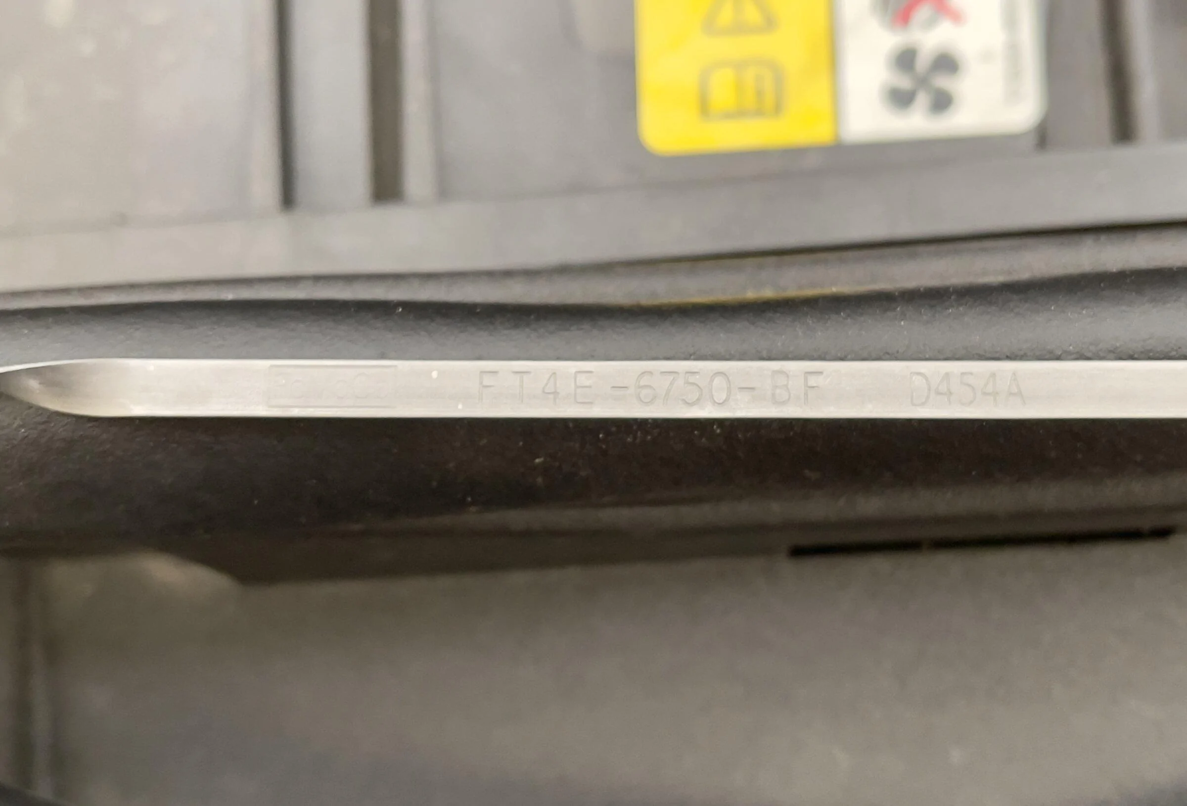

Can you post your dipstick part number?

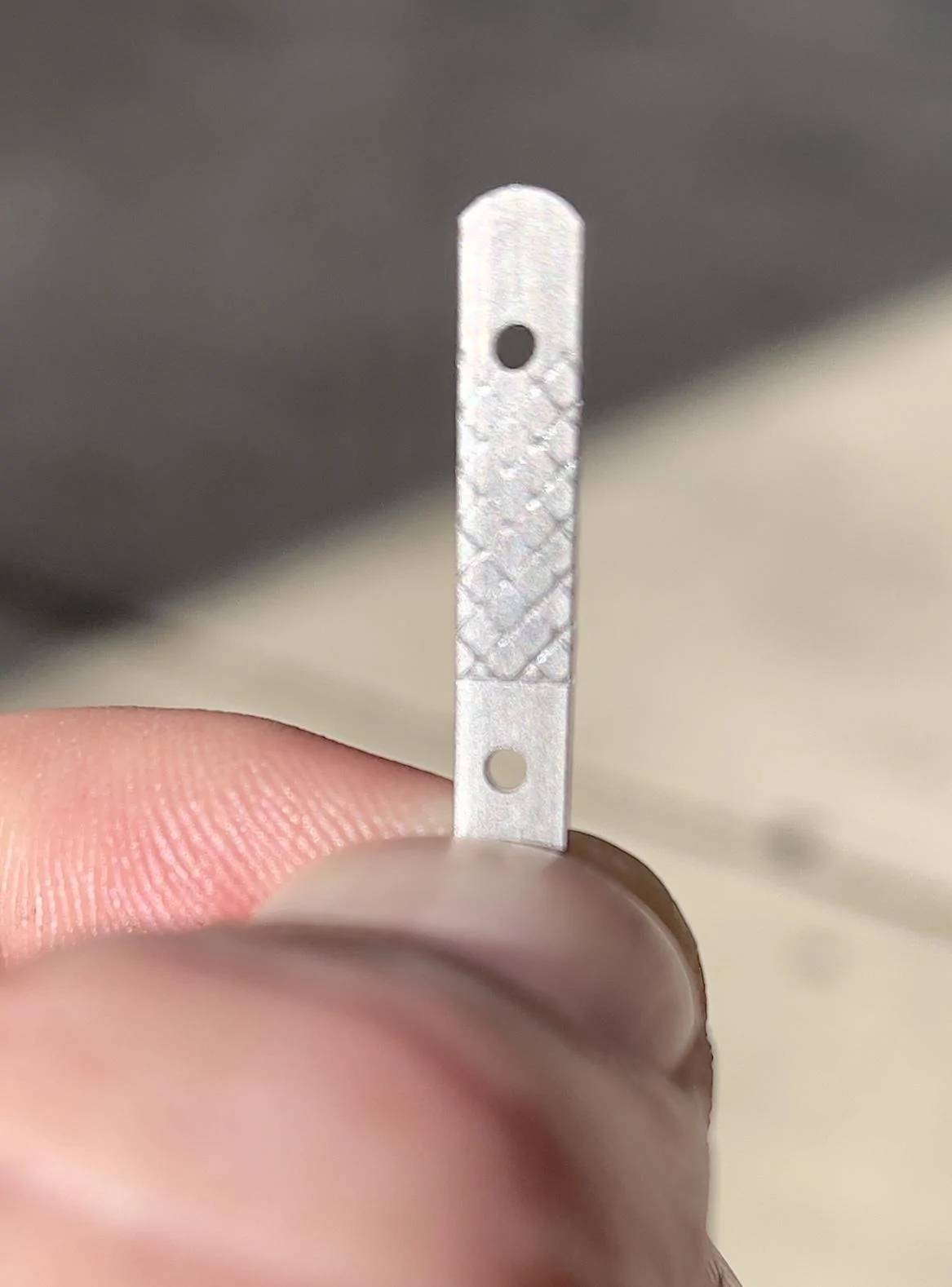

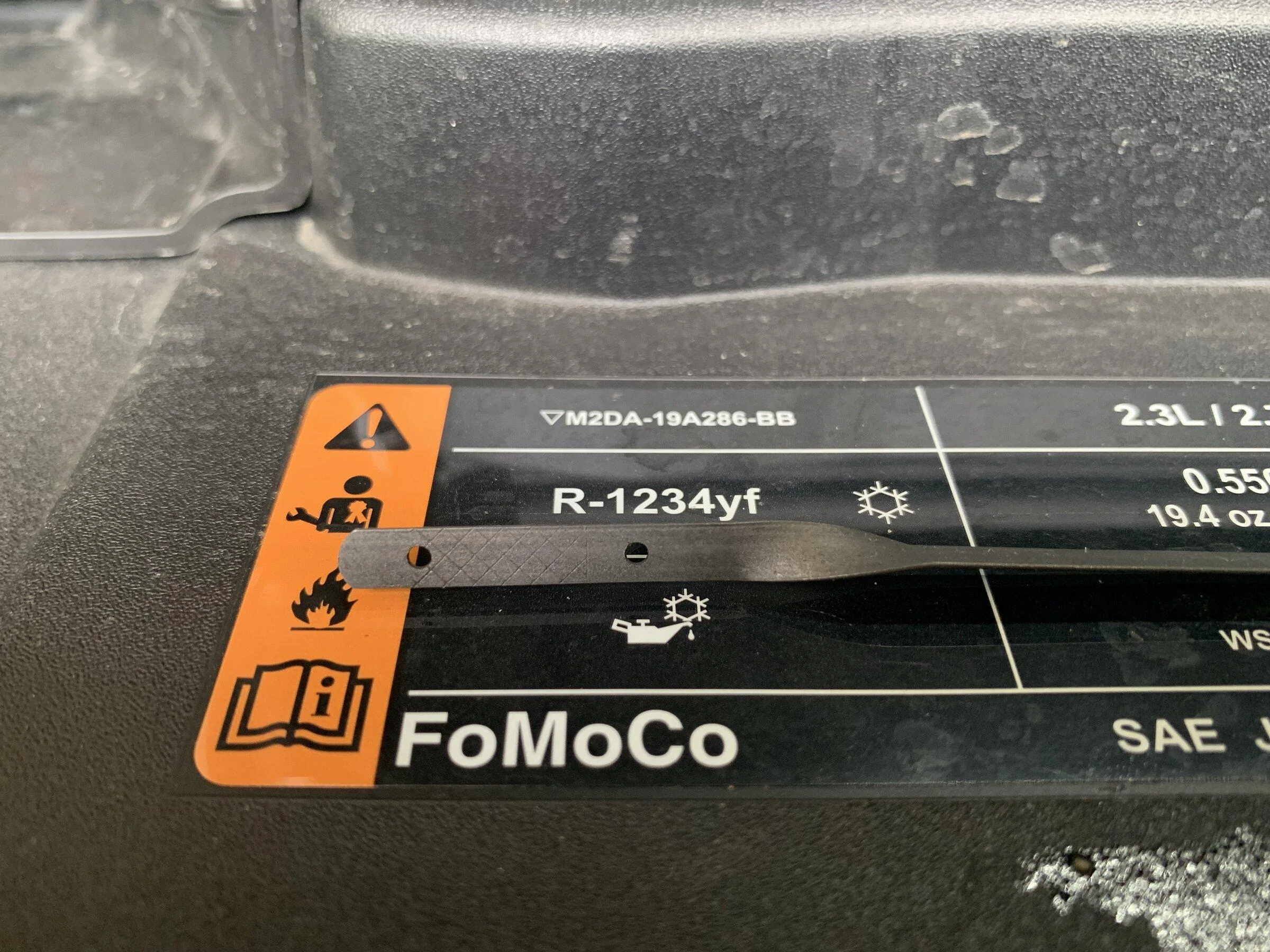

Just did my first oil change, and wanted to see if others on this thread have seen this? You know there is this whole thing about….does it really take 7qts of oil? In my case, it did. My dipstick is not like the ones being talked about, with the hash marks, mine just has two holes, one for minimum and one for maximum. I first put in 6qts, just to be safe and it ended up at the bottom hole, put in one more and it ended up at the top hole…like I expected.
My question is, do others have this new dipstick too, or do others have the one with hash marks on it? I wouldn't be opposed to pulling out the dipstick to measure it versus someone that has the one with hash marks, if anyone is interested. Curious minds want to know ;-)
This is the first I've heard of a revised dipstick. Do you have any pictures of the tip, and by chance a legible part number for it?
