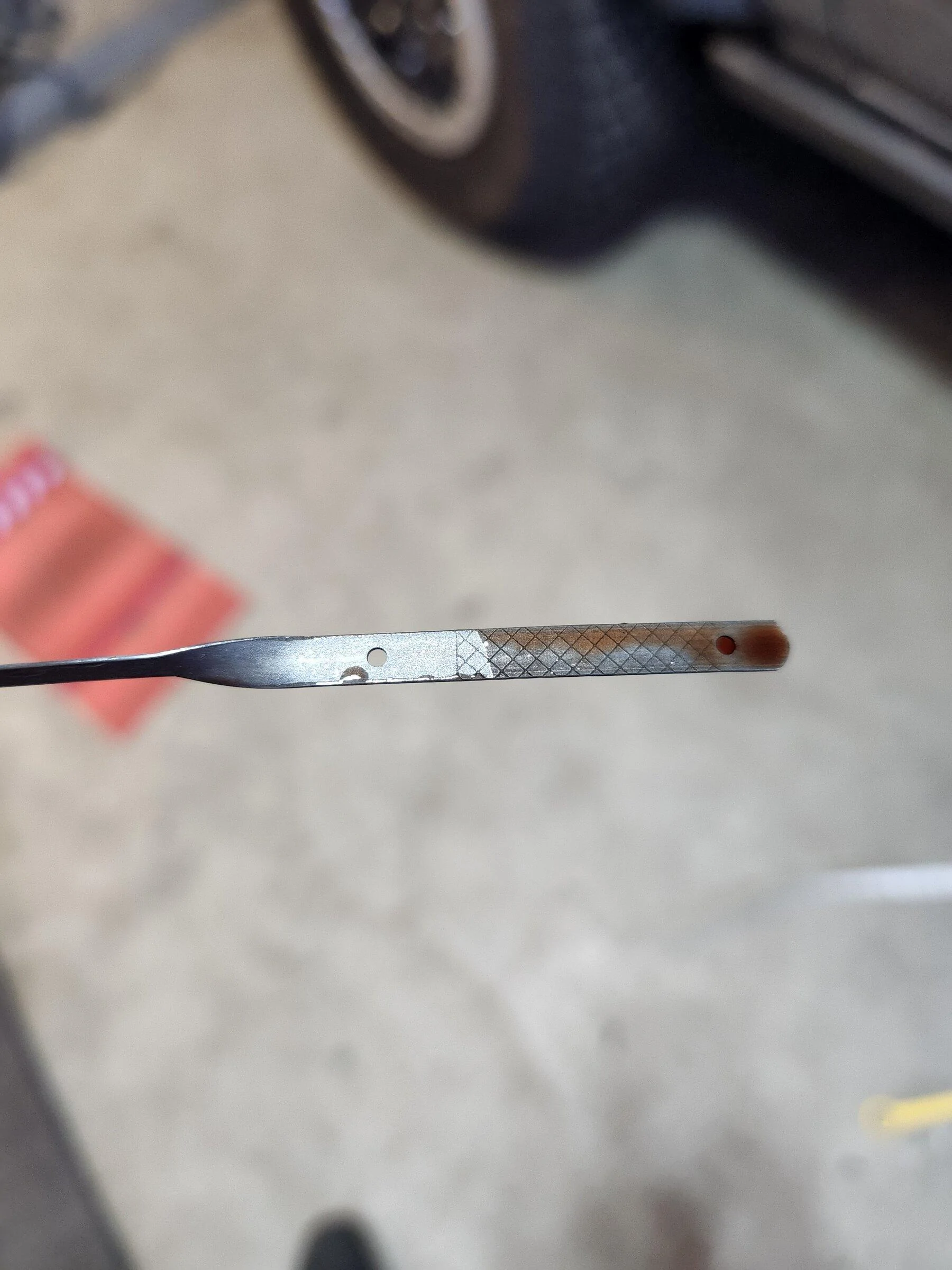

Here it is...the definitive answer to our issues! The facts:
The correct stick is PN MB3Z-6750-B
It is 7/8 of an inch shorter from the base of the handle to the MAX line than the current sticks in our Broncos.
Note the pics...showing side by side comparisons of overall length and max mark lengths. Also note my oil position as measured PER THE MANUAL on the "new" stick. If you want an accurate oil measurement using the procedures indicated in the manual, with 7 quarts, buy the MB3Z-6750-B. I ordered it from my dealer Friday, it came today...19.45.

Yes on the MB3Z...if you buy one and if you have 7 quarts in your pan your level on the stick will fall in the hash mark range like so...finally!
Ford Bronco Bronco Team Engineering Confirms 7.0 Quarts for 2.7L Engine Oil Change is Correct 20220601_162733
Not trying to look a gift horse in the mouth, but seems to me that if a person were to fill to the proper dipstick level (top of hash) they would now be overfill at over 7+ qts?
Just seems like even this new dipstick isn't really the perfect match.

7 quarts puts me at just under the top line of the hash mark, which is ideal. Per Ford, anything in the hash mark area is acceptable.

All dipsticks work that way. There is no need to ever keep topping off the oil level with minute amounts of oil. People are way over-obsessive about engine oil level. For most all automotive engines, the hash area represents approximately 1 quart/1 liter, which is the top quart (i.e. 7th quart) of oil in the engine.
Exactly...and now mine actually does that! Never have I been so excited to open a package containing only a dipstick...
