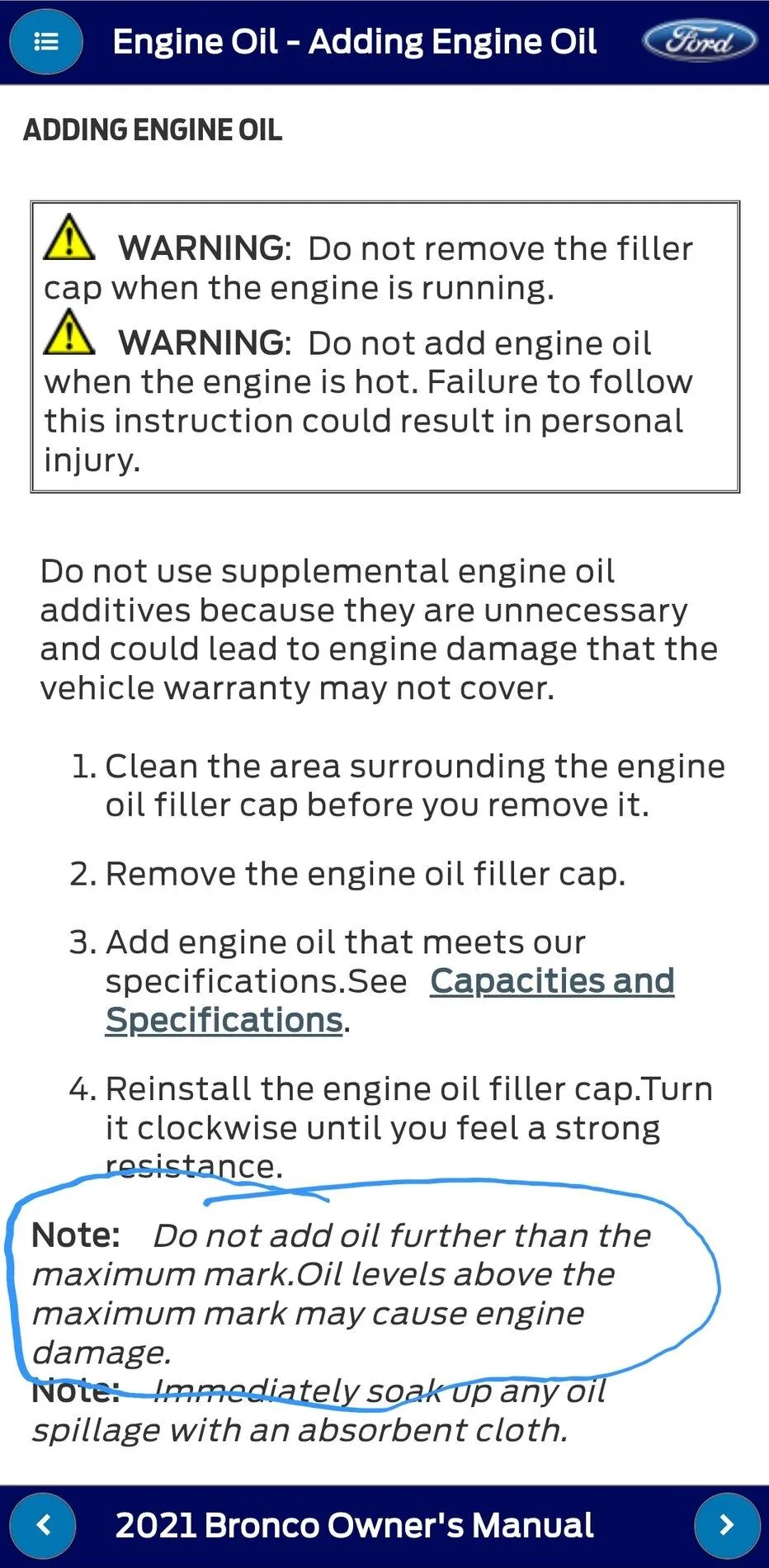

Ford also says this:
Ford Bronco Bronco Team Engineering Confirms 7.0 Quarts for 2.7L Engine Oil Change is Correct Screenshot_20211123-104604_FordPass

and that note is correct if the dipstick markings is correct. If the dipstick markings are NOT correct than you are starving your engine by 1 quart.
...and that, with due respect to flip, is the question.
