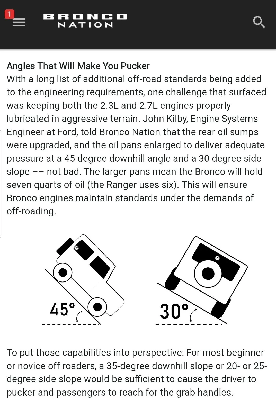

Thats a good point, and Ford addressed your concern in the engine desugn, according to this May 12 article on Bronco Nation, to prevent oil starvation on the trail:
Except, the Owners Manual states that the 2.3L (Ranger equivalent ) takes 6.2 qts.

evidence has been presented that Ford added 1 extra quart from 6 to 7 for the bronco application.
And I bet the screenshot you posted is standard copy in every Ford product.
regardless, it's your Bronco so at the end of the day do what you want.

Here is the May 12 post on Bronco Nation that explains why the oil capacity is greater for the Bronco version of the 2.7 Eco:
Regardless of the intent of the 7 quart capacity, the reality is that adding 7 quarts after draining 7 quarts puts the oil level way over the full mark. If Ford's answer to having enough oil in the engine to address extreme angles is simply to overfill our engines, that is not confidence-inspiring. I don't think it is too much to ask of Ford to simply clarify why the dipstick does not reflect an accurate oil level (or, if it does, why the "proper" oil level is so far over the max mark on the dipstick). Oil pans designed for extreme angles typically have baffles and/or a windage tray...or the motors will run a dry sump.
