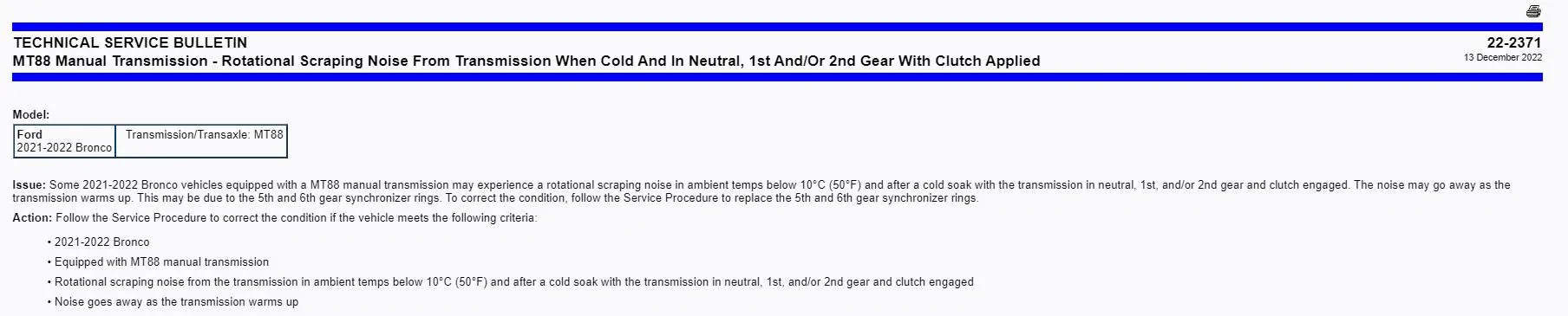

Ford Bronco Bronco TSB and SSM Notices bronco 22-2371
