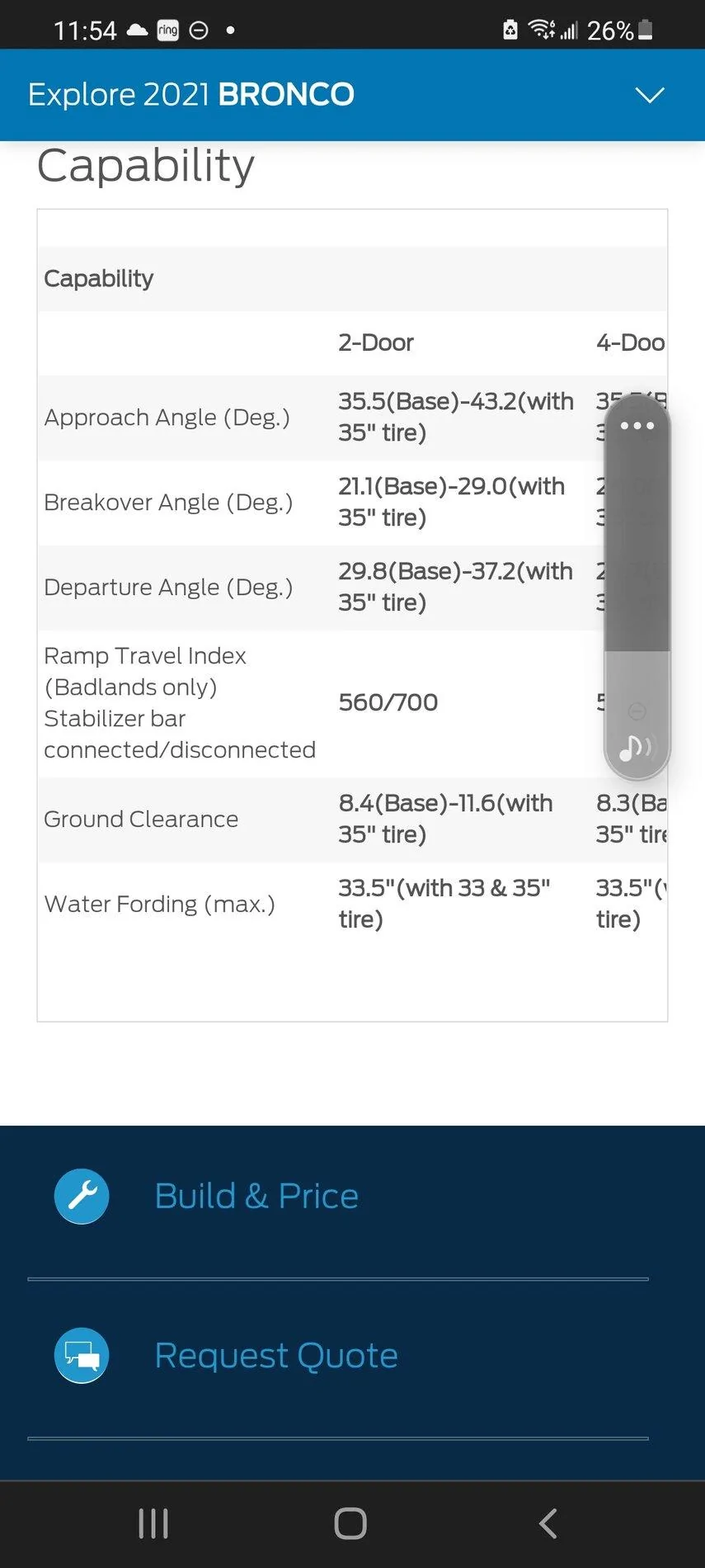

Ford Bronco Bronco Water Fording Capability Screenshot_20211015-235444_Chrome
If water gets in the engine it will get hydrolocked. https://en.m.wikipedia.org/wiki/Hydrolock
Sure, but the air intake is already at the top of the hood. I can’t imagine taking a commercial vehicle like this through that much water without getting pushed around by the current or ruining some of the other systems. I guess I’m trying to figure out if the snorkel is actually practical or just for show. 33.5 inches is already an awful large volume of water.

Since the existing air intake is already so high and designed to avoid water intrusion into the cylinders (plus considering the potential electrical issues), I’m going to assume that the snorkel is an extra layer of protection that doesn’t really increase fording height as much as it provides insurance in case of misjudging water depth.
