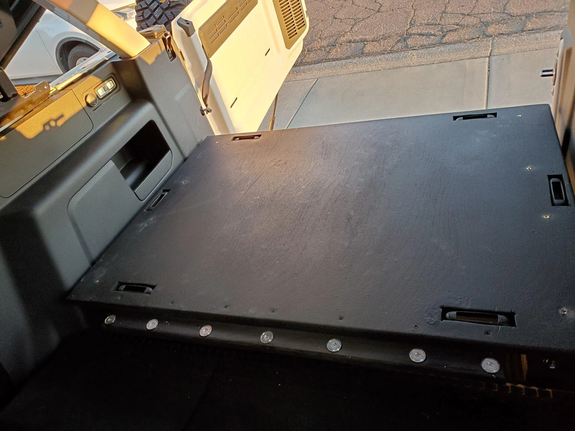

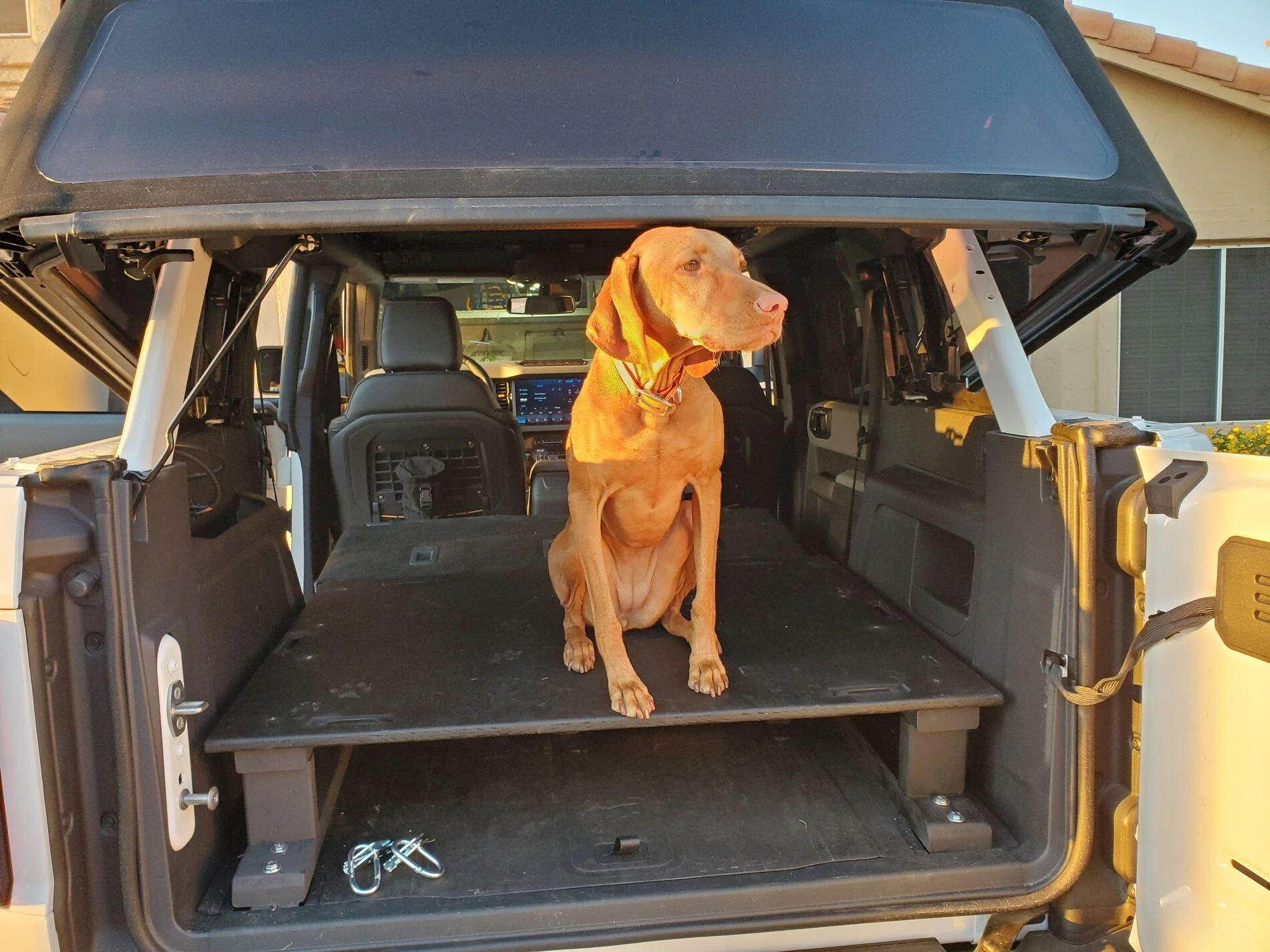

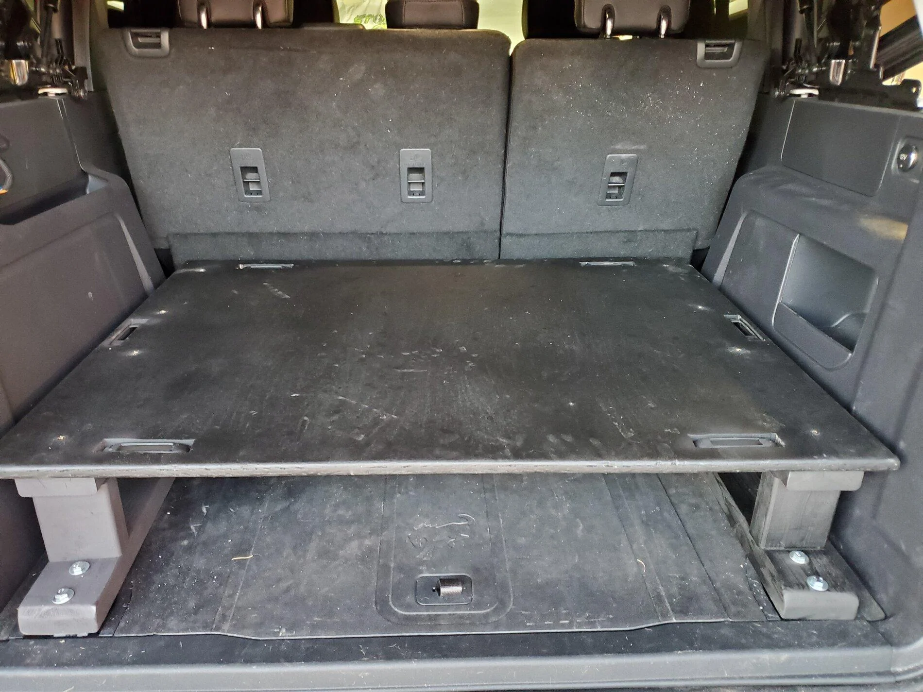

I built a rear platform that bolts into existing tie down locations. It is out of wood, I used 3/4 inch oak plywood for strength and coated it with the spray can version of Bed liner. Features are:

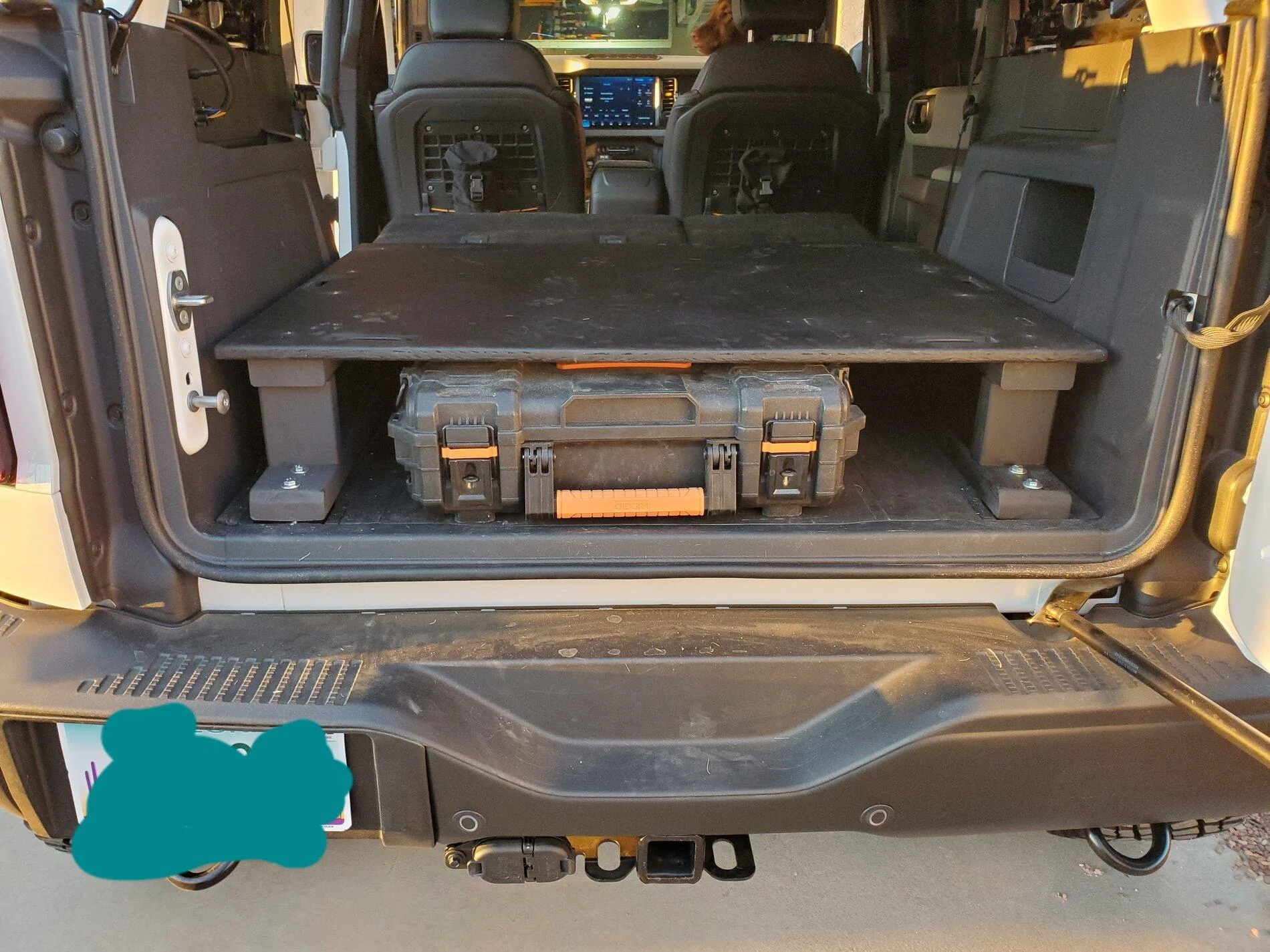

- Just high enough to store two Rigid boxes underneath

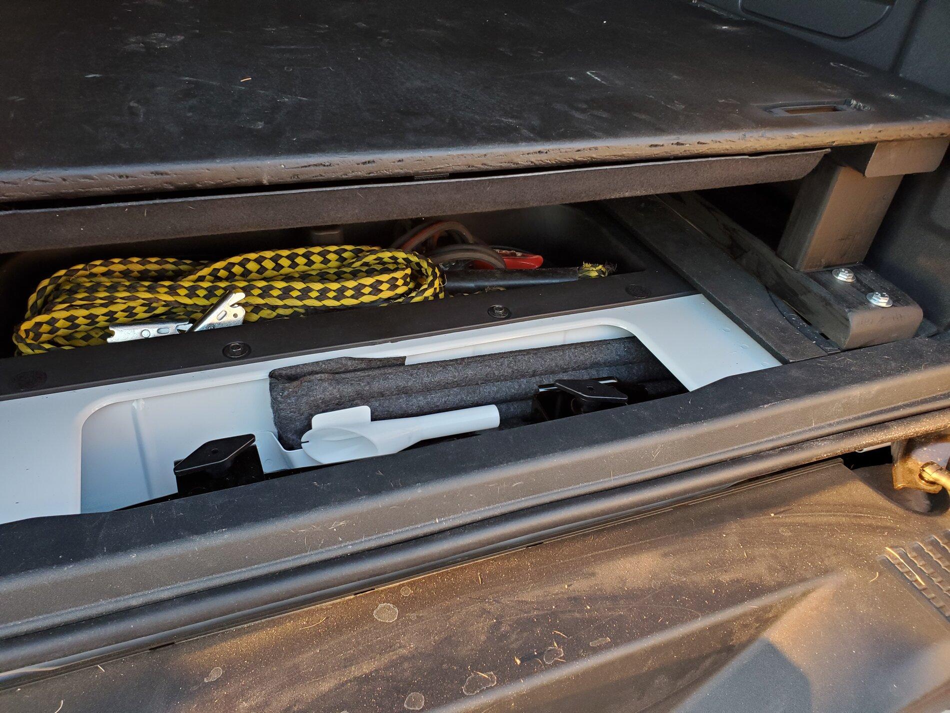

- Still have access to factory back storage

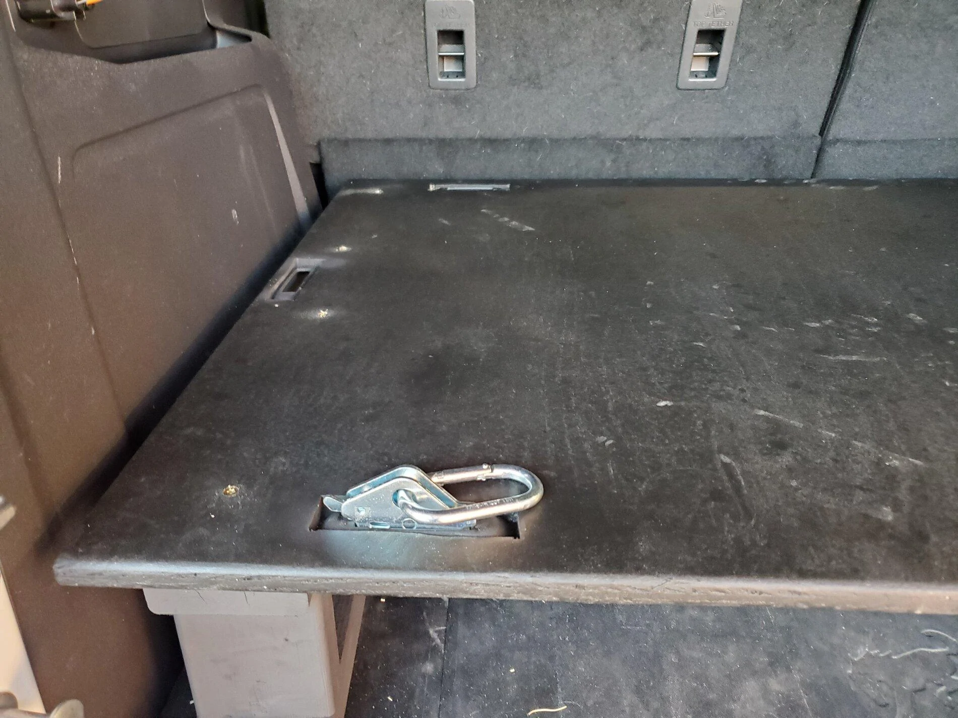

- embedded E-track, 6 points removable tie downs or any E Track attachment.
-On the front of the platform I added a plate with rare earth magnets to attach another panel for a completely flat sleeping surface

Nicely done! Was thinking of doing something similar myself. Do you have an pics with the other panel installed?
