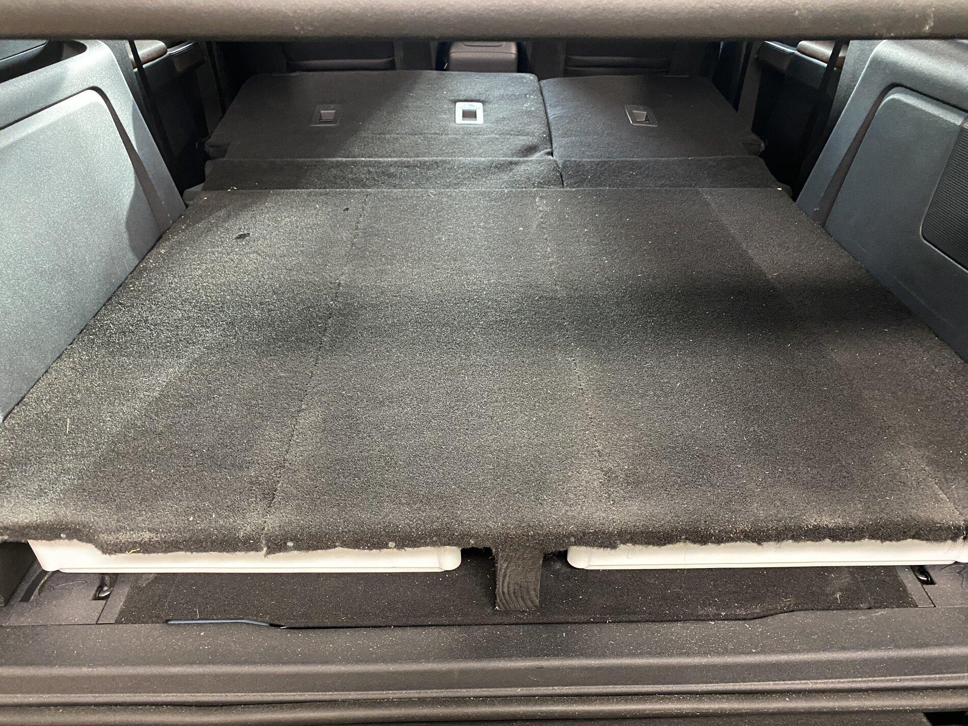

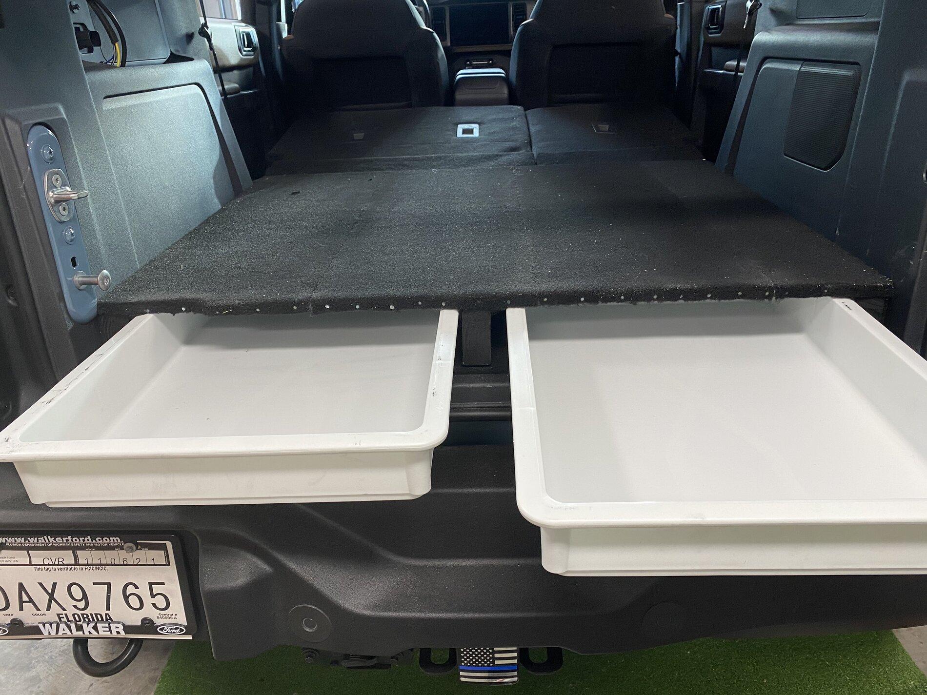

Kept it simple. 4 door outer banks. 3.75 “ raise, flush with floor when back seats down. Put auto carpet over the plywood to match the cargo carpet. Purchased a couple of low profile containers that slide well on the cargo carpet and they are about 20” deep. Works out pretty well to store some items out of site.

So it looks lovely and functional, but is this secured to the floor in anyway? I'm probably gonna be doing something, but I am unsure on how I'm going to affix to the floor.

The other panel is in process, I started it but now I want to make it a little longer. On the attachment end I routed an area so that a piece of one inch strap steel mounts flush and that is what attaches to the magnets. Each magnet has 60lbs of adhesive power so once attached, it's solid.
I never understood that... if those magnets are that strong each, times a whole row of them, how are you gonna separate them when you actually want to? Lol. I haven't actually started taking any measurements myself yet but was thinking of doing some sort of piano hinge or something so that you could basically fold down the rear seats and then flip the 2nd panel up from the cargo platform and down on top of the seat backs. Not sure if there enough height to do so...

I had the same concern with the number of magnets. I figured itbwould be easier to subtract then add. As it turned out it does require some effort to detach it but it's not too bad. You have to slide forward with some upward pressure to get it to release. I did consider the piano hinge (that was plan A, also an issue with having the tie down locations available)however there is not enough clearance with the roll bar.
