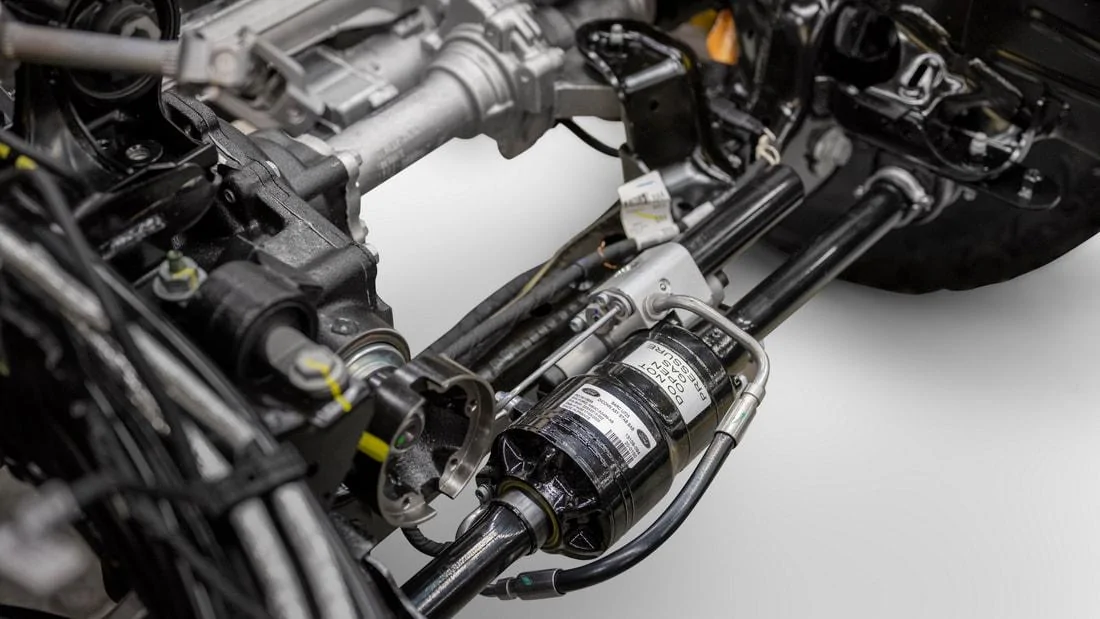

UPDATED THREAD with new and additional information:
Bronco Stabilizer Bar Disconnect Operational & Service Information

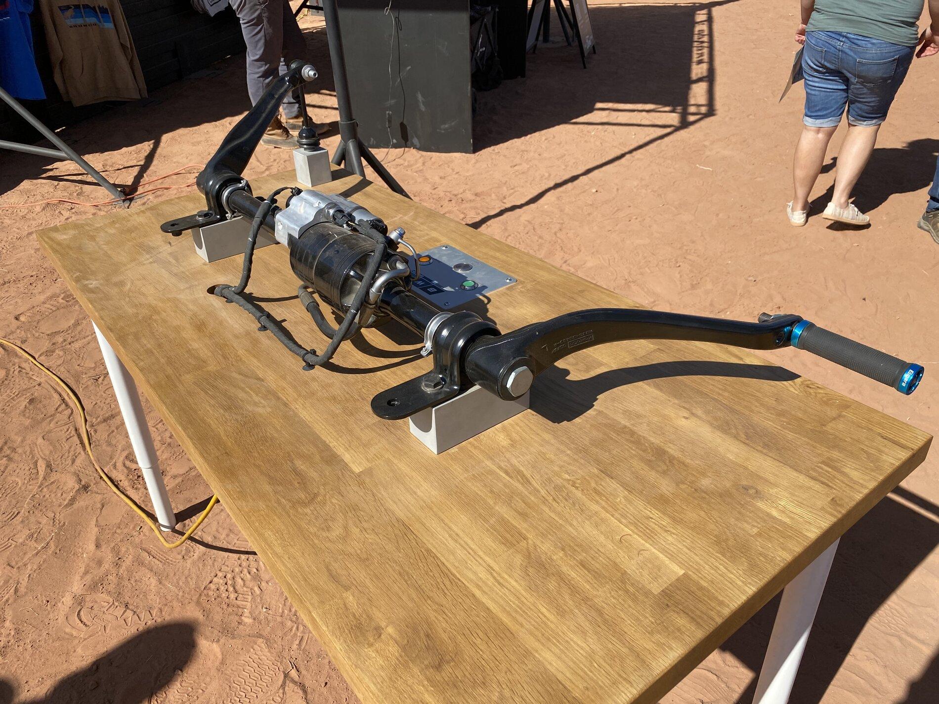

I found the July 13th announcements below that show the BWI Group is building the Bronco's Front Stabilizer Bar Disconnect, thanks to a tip from @Aman in another thread that they were the supplier. Below is some of the information on how the unit functions. This unit is only available on the Badlands and First Edition trims, there has been no information to indicate it will be an a la carte option on any other trims. As a reminder, this is a hydraulic system unlike the Jeep Rubicon's electronic sway bar disconnect system.
What are your thoughts, it seems like some very innovative engineering.
"electro-hydraulically actuated front stabilizer bar disconnect system from BWI Group that can disengage while under load. Once disengaged it automatically re-connects at speeds of 20-plus mph, then automatically disengages again when speeds drop sufficiently"
https://www.motortrend.com/cars/ford/bronco/2021/2021-ford-bronco-first-look/
BWI Operational Video
BWI product page
BWI Group Front Stabilizer Bar Disconnect announcement 7/13/2020
BWI Bronco Front Stabilizer Bar Disconnect
7/13/2020
Ford Bronco BWI Bronco Stabilizer Bar Disconnect Technical Information BWI Bronco Front Stabilizer Bar Disconnect
The available front stabilizer bar disconnect off a unique to the segment design for increased articulation across the vehicle to help you up, over and around large obstacles.

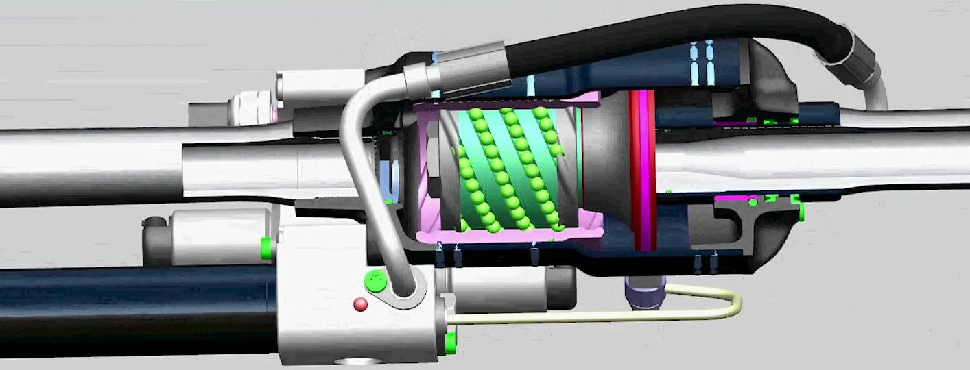

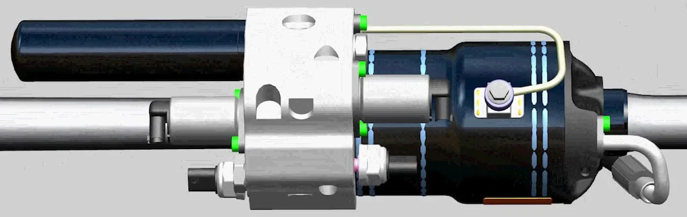

Piston
Ford Bronco BWI Bronco Stabilizer Bar Disconnect Technical Information stabilizer-2_or

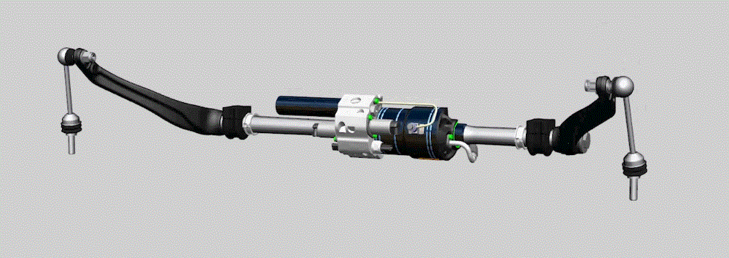

Stabilizer bar ends are disconnected and free to move on their own.
The solenoid valves are open and the piston (immersed in fluid) is free to move as fluid flushes in and out of the chambers on both sides of the piston.
Full suspension travel is possible. Wheel articulation is not limited by the stabilizer bar.

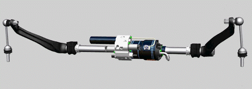

Ford Bronco BWI Bronco Stabilizer Bar Disconnect Technical Information stabilizer-3_or
Stabilizer bar ends are now connected.
Both solenoid valves are closed, preventing fluid flow. The piston is hydraulically locked.
Total suspension roll stiffness is increased and vehicle body roll angle limited while cornering.

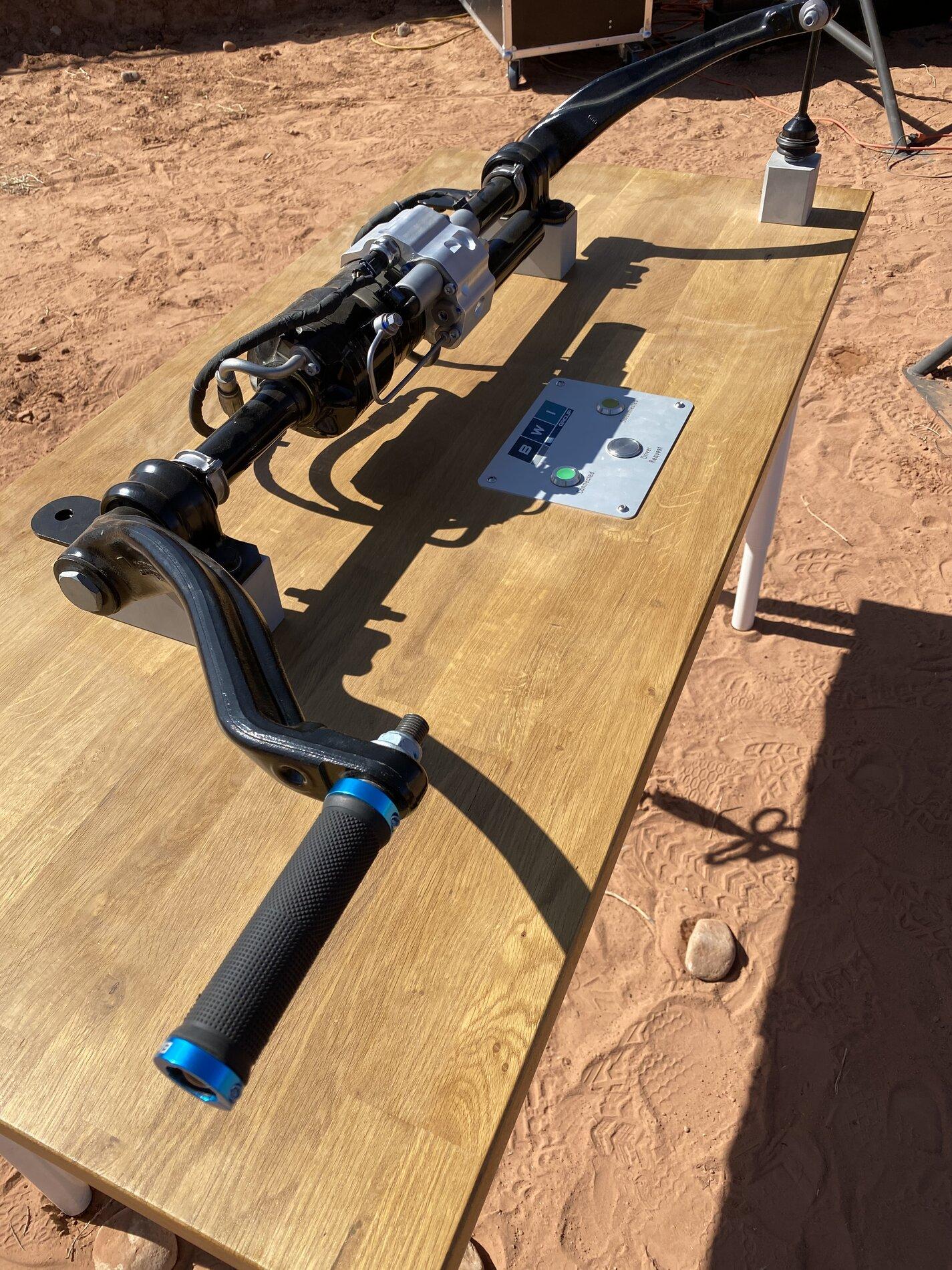

Update 4-5-2021, photos from Moab by @The Bronze
Ford Bronco BWI Bronco Stabilizer Bar Disconnect Technical Information img_7468-
Ford Bronco BWI Bronco Stabilizer Bar Disconnect Technical Information img_7483-

I take this to mean that a loss of fluid from a leak etc would cause it to fail in the disconnected position?
I'm not sure of the failure modes but I'm not really concerned, how many years have we been driving with hydraulic power steering, the design elements are well understood and the bash plates will keep the unit protected. Also, this is not a brand new design for BWI, they have designs on other vehicles.

I think there is also a locking pin involved also actuated by noid. Failure if I recall is to the locked or connected position.
I'm none too concerned about failure either, more my interest is academic. If customers ask me what would happen if it didn't work right...most likely because the fluid leaked out?
The solenoids failure mode SHOULD be the closed position - similarly if there is a leak the piston will no longer be immersed, and the swaybar would behave as connected.
I'm sure BWI did a simple FMEA and made the failure modes at least point to failing as a connected member.
