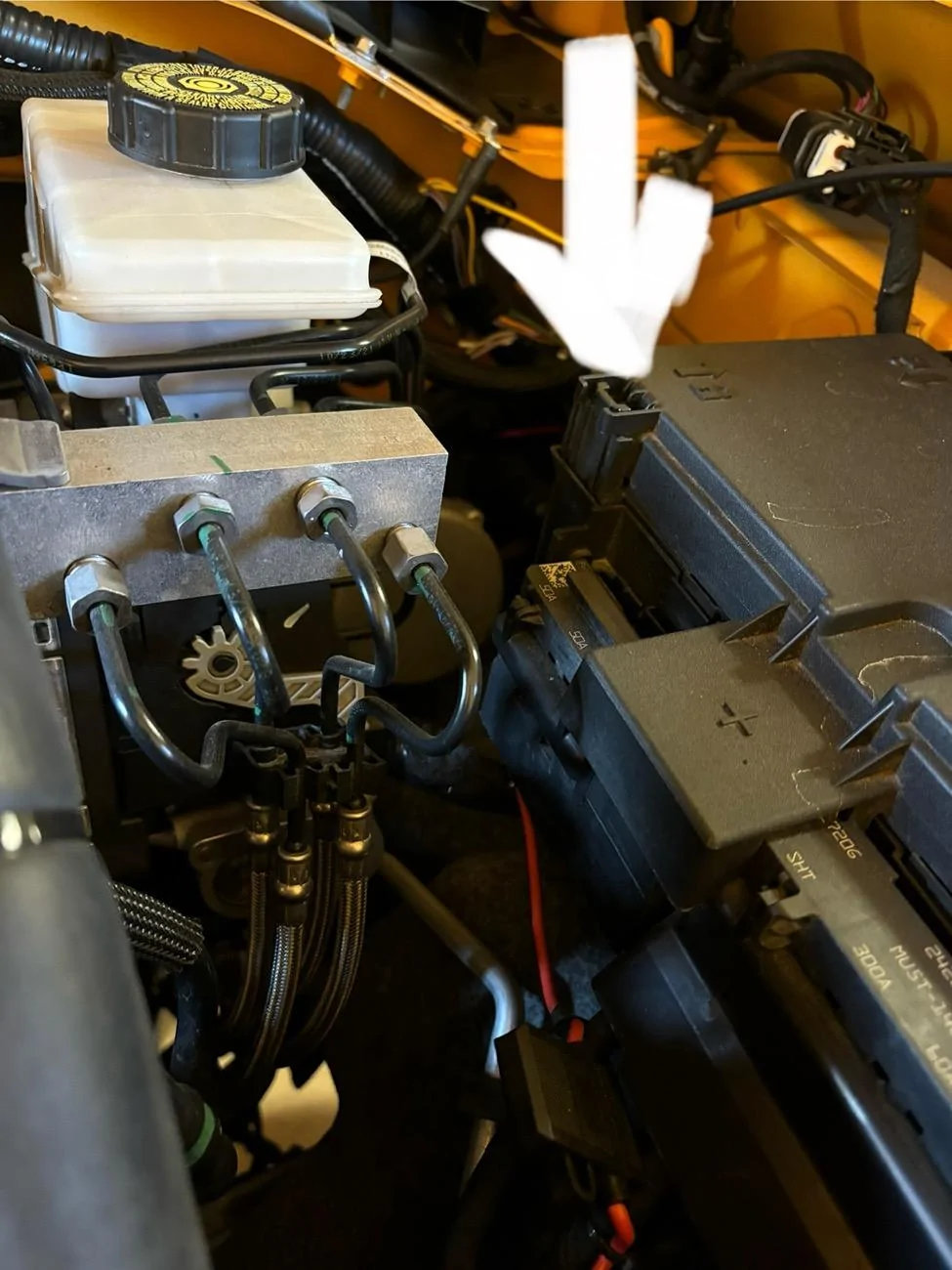

This is where I ran my amp wire. 2dr 2.7 auto.
Thank you I was looking for a possible grommet on the driver floor. I’m about to go check it’s just 100 degrees in Texas and the concrete is not my best friend right now lol.

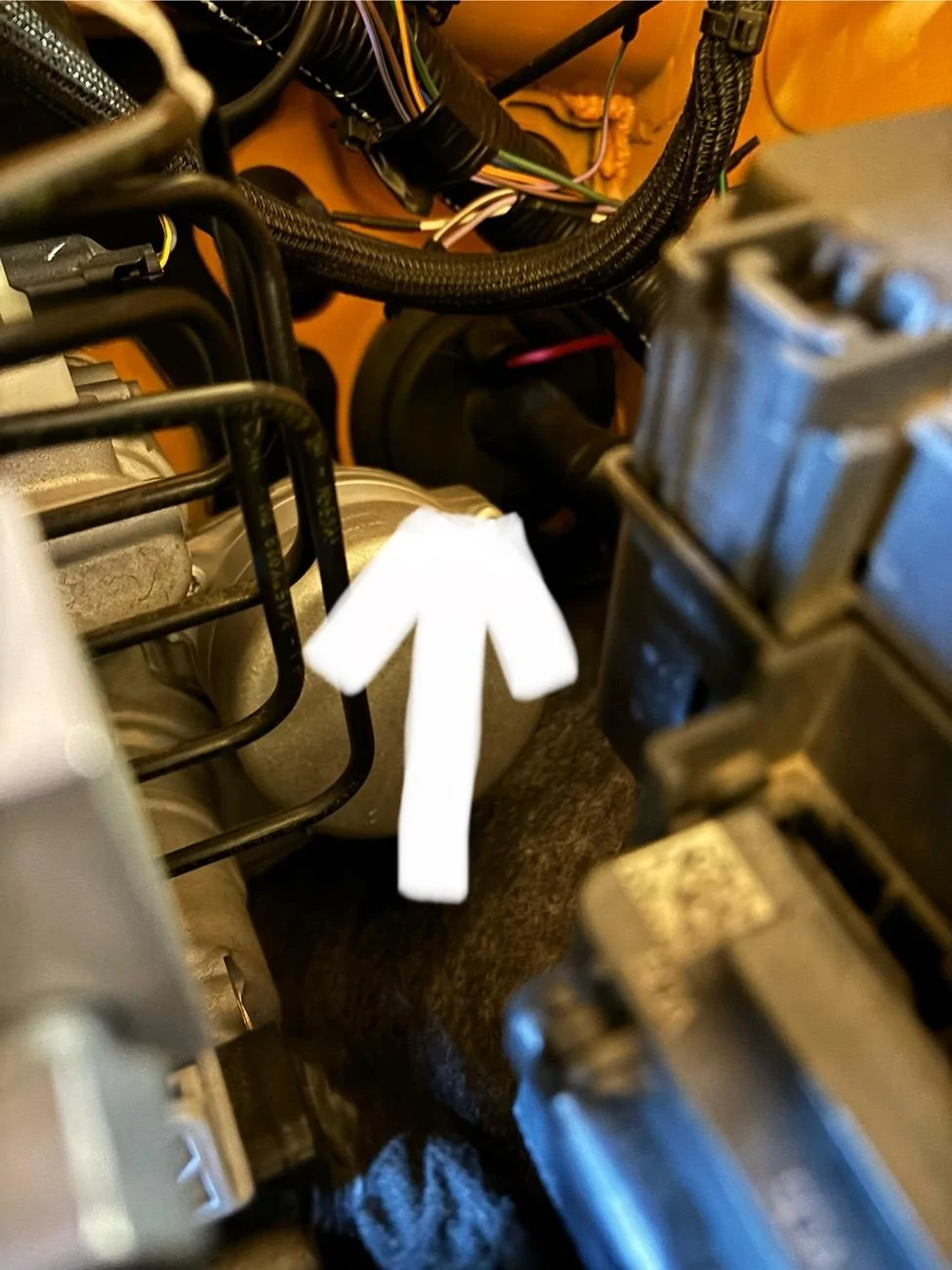

Save yourself some busted knuckles. Pop the grommet out, poke a hole in the nipple with flathead screwdriver or cut X with a box knife razor big enough to get wire through then reinstall. Absolute pain trying to cut the hole while the grommet is in place.
Chapito
Jul 3, 2024
Laredo, TX
2023 Bronco Wildtrak
I ended up using the smaller grommet right above the main one on the firewall. Popped it out and cut it.
