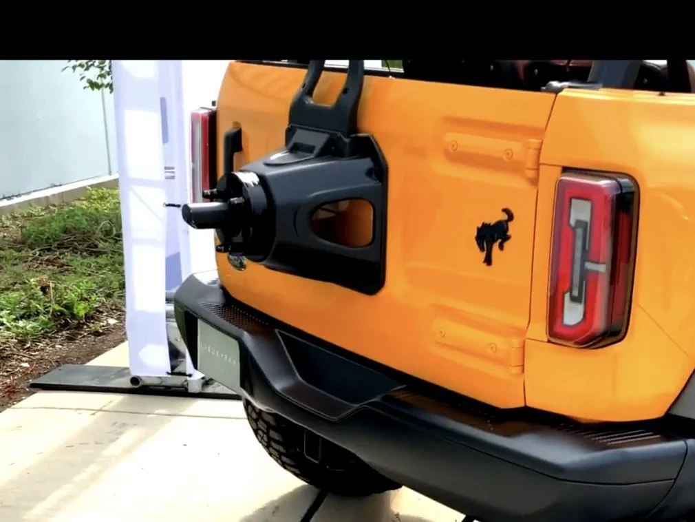

I asked this very question to the Ford rep at the event I was at yesterday. The answer he gave me was that there are several different brake lights for different tire sizes. So you may need to purchase the correct light for 35’s. My issues is how will a 37 fit.

Interesting that it is quite different from the jeep. There is no exterior mounting plate. This leads me to believe that if you delete the carrier all you would have is x number of holes. With some body matching plugs it could come out clean.
I think it might be a cool look not to have a spare tire and/or carrier on the back. Perhaps you could get the FORD letters from an EB site and re-create the original look.

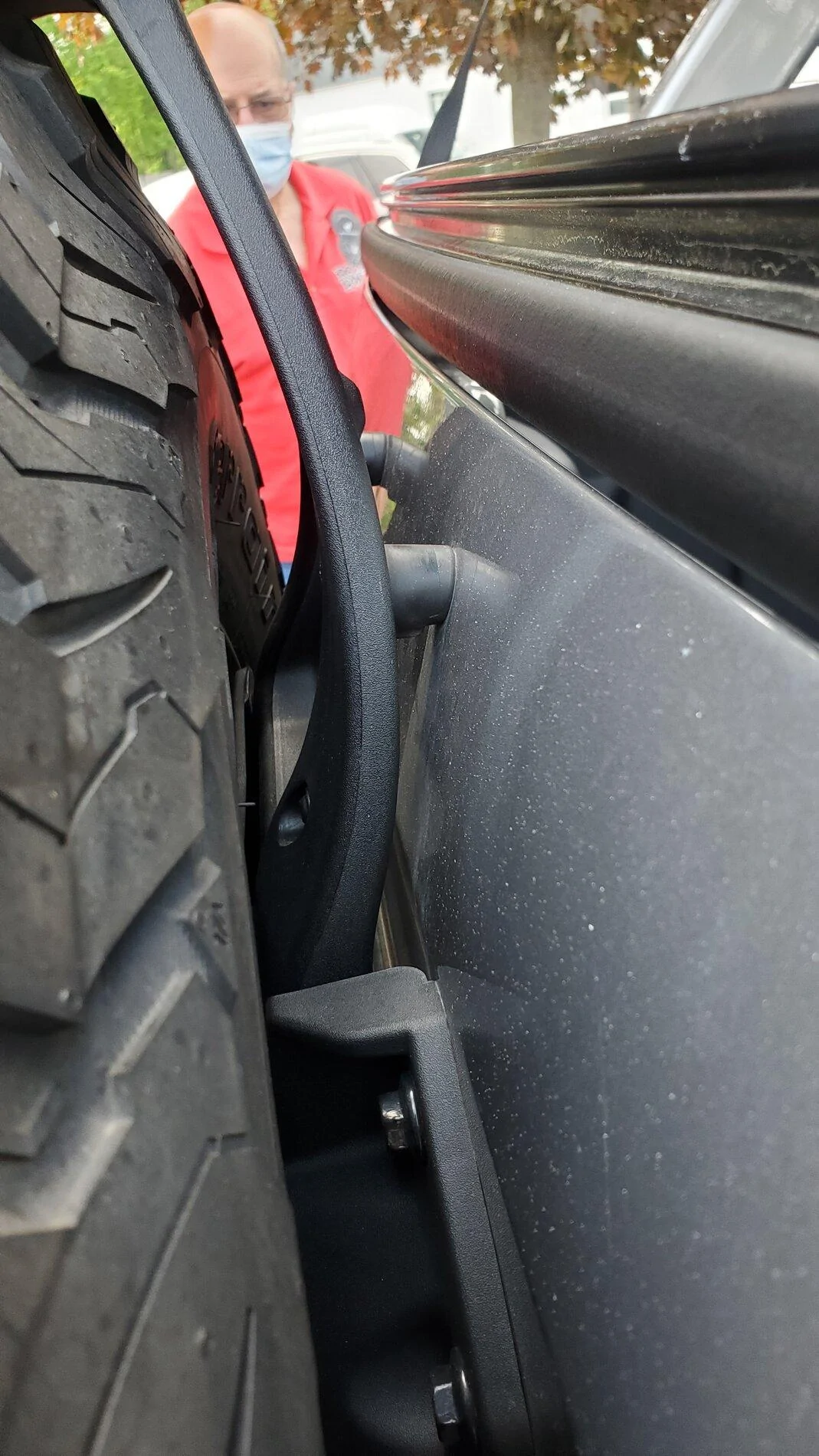

FWIW I have paid close attention to this when I was looking at a Badlands and First Edition at a local dealer event and found that the third light mounts are slightly different and do not seem to be adjustable. The Sasquatch version of the mount sits noticeably higher on the tailgate and thus also needs longer rubber bushings that rest on the tailgate itself. I am positive the aftermarket will come out with a solution. Whether that is a light that mounts in the wheel via the spare tire lugs or just an extension.

I was at the Bronco event at Bangor Ford yesterday (non-squacthed BL and a squatched BD) and can confirm that the brake light brackets are different sizes...roughly 2" taller on the squatch so no, the 35s won't fit on the 33s carrier w/o hitting the light. For 37s guessing aftermarket will come up with something or wait for Warthog parts to become available.

Ford Bronco Can a 35” tire fit on the back of a badlands bronco 20210522_152853
I took this picture and examined the spare tire holders on the badlands vs sasquatch.
The picture shows a 33" on the badlands. Those rubber bumpers are higher up on the 35".
It almost looks adjustable. There are pairs of holes down lower behind the wheel. Only one pair was used. It looked like if you moved one set of holes up, it would be taller. It was hard to see good though.
But those rubber bumpers wouldn't reach the tailgate if you raised the brake light. So... IDK.

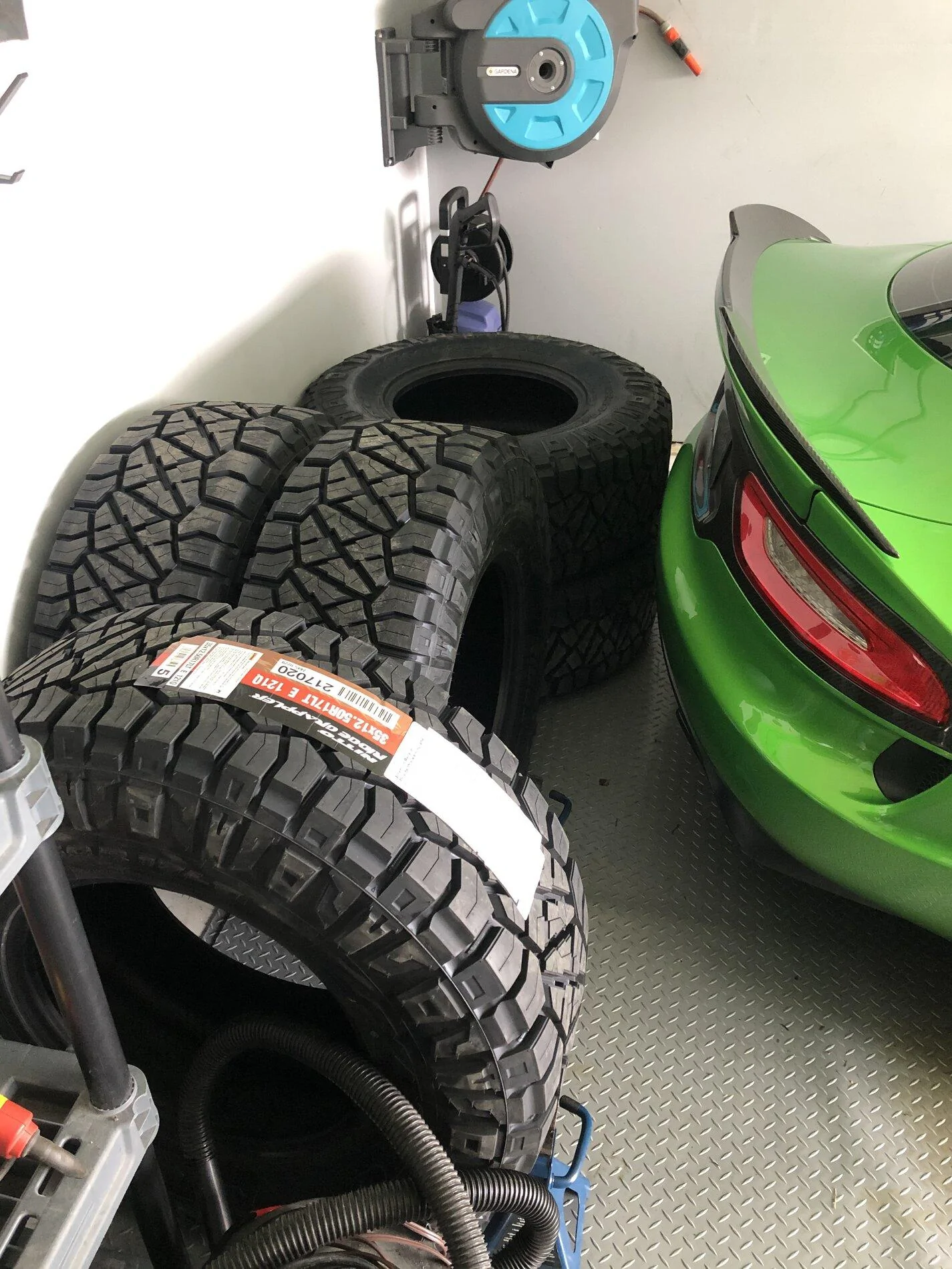

Got my 35’s 🔥🔥
