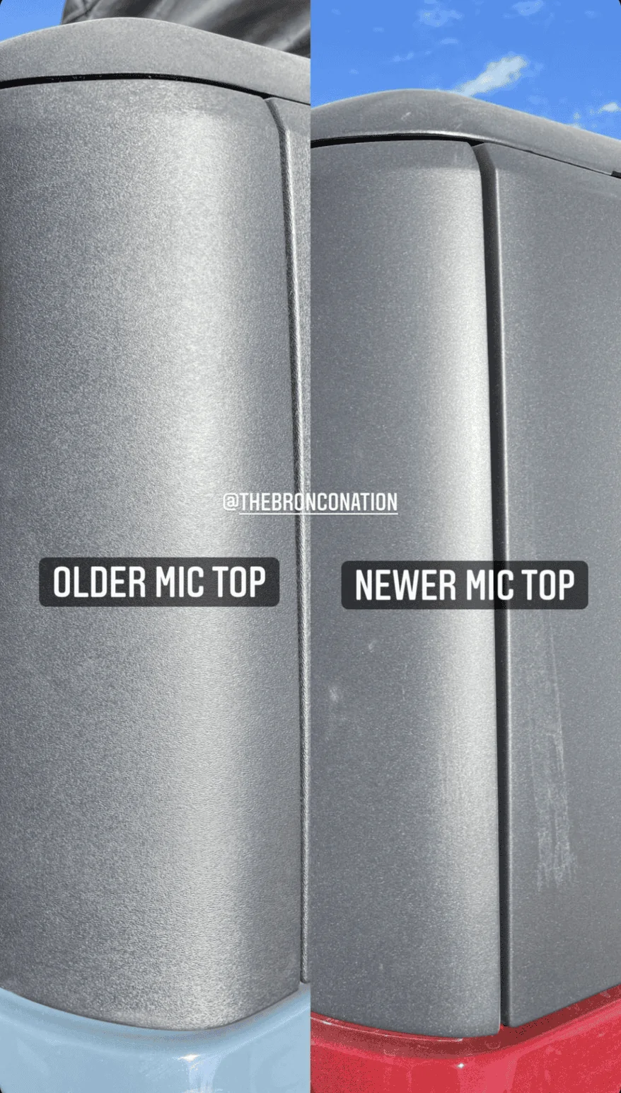

Not trying to sound like an abrasive guy, but It has been discussed in probably a dozen threads already.
The older version of the MIC top I saw in person had a lot of texture to it. Identical to the grain and texture in a lot of aftermarket speaker pod Harley parts I have painted in the past.
I did everything textbook perfect with adhesion promoter, scotchbrite (sanding will reduce the texture in an uneven manner unless you sand ALL the texture off and featherfill prime, block sand it), etc. Some adhered just fine and looked good, some failed.
The newer version no one has seen in person yet other than the people on here who actually work at the factory.
The grain looks considerably less.
At the end of the day, everything can be painted, in theory.
I have begun using Tamco products, and they swear they have a primer that will adhere to anything, even chrome.
Until I try it myself I can't attest to that or defend it.
IF that is the case, in theory you should be able to scotch the whole thing, apply this primer (with some adhesion promoter to be safe), sand, and paint and be just fine.
I have done many Jeep tops in my day, both in paint and bedlining.
No failures, but their top in a considerably smoother surface (and what appears to be a different plastic) than what i saw in October at the TN show.
I can say 100% dipping it, plasti-dip, and wrapping are not going to end well just due to the grain. Your two solutions are really a urethane-based quality bedline material or paint based on the above assumptions.
Not a great high def image, but helps maybe a little to see difference.
(the new tops were on display at KOH)
