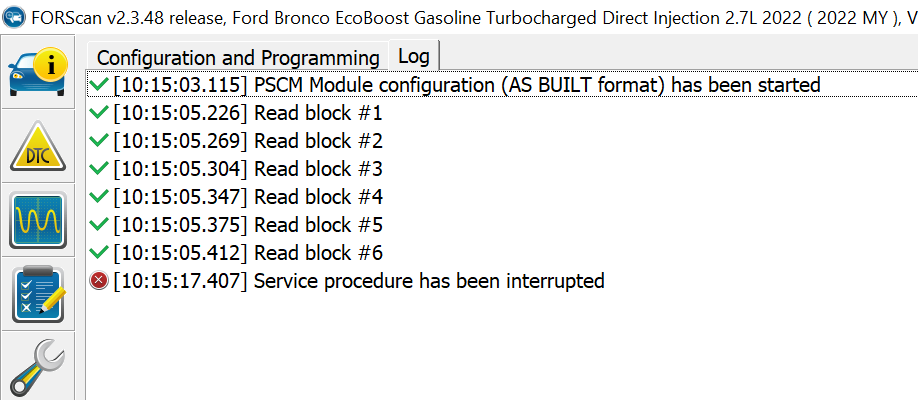

I have successfully changed tire size and used the 'plan English" programming to disable the horn beep when leaving with the key.
I cannot program anything using the as built sections. I tried the horn beep using as built and got the same error.
"Service procedure has been interrupted"

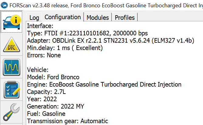

Running the newest Forscan 2.2.48 and OBDLinkEX firmware 5.6.24

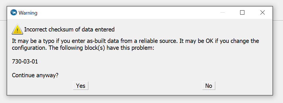

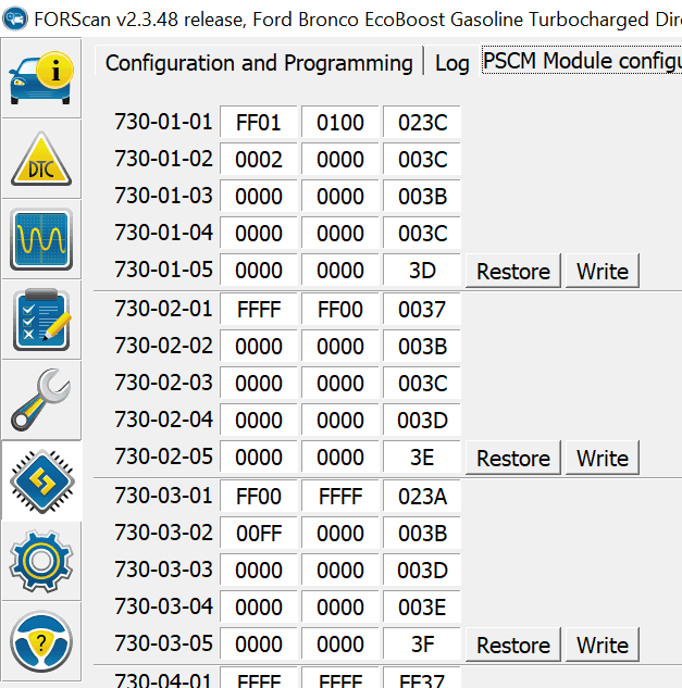

Trying to change 730-03-01 023A to 003A to disable Auto Start/Stop. I get the checksum error and press OK.
Ford Bronco Cannot write changes using AS BUILT "Service procedure has been interrupted" 1e
Ford Bronco Cannot write changes using AS BUILT "Service procedure has been interrupted" 3e
I tried entering checksum manually (0038), I get no checksum error but still fails the write with "Service procedure has been interrupted".

I was able to disable Double Honk and add Baja
Unable to disable Auto stop and get "Service procedure has been interrupted"
Tried 2.3.48 and the last 4 versions for Forscan for Windows
Using Paid 1 year Extended License
Updated the firmware on the OBDlinkEX
Still no luck with Auto Stop

I have been in contact with Forscan.
They sent me a newer test version and I was able to disable ASS PSCM 730-03-01
You may want to wait until version 2.3.49 is released before buying the Eliminator
