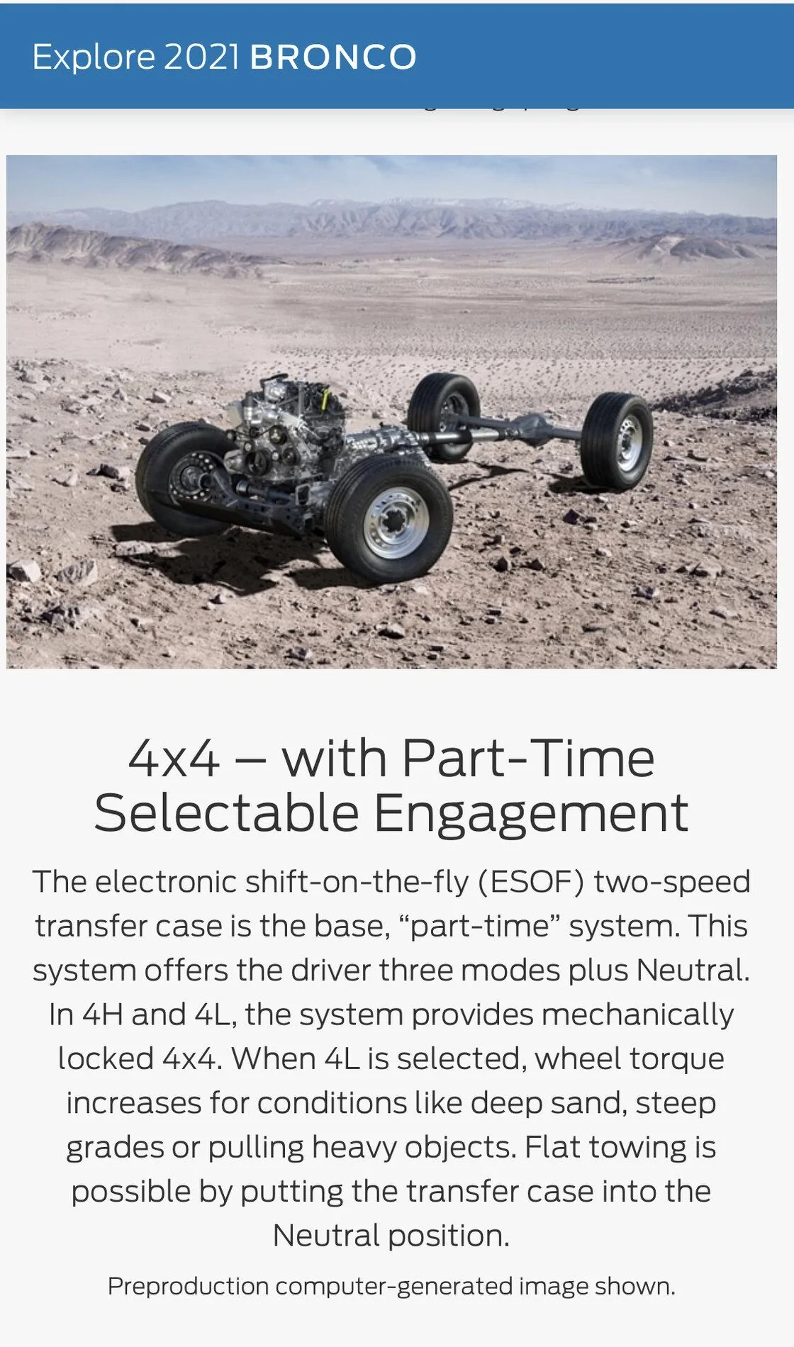

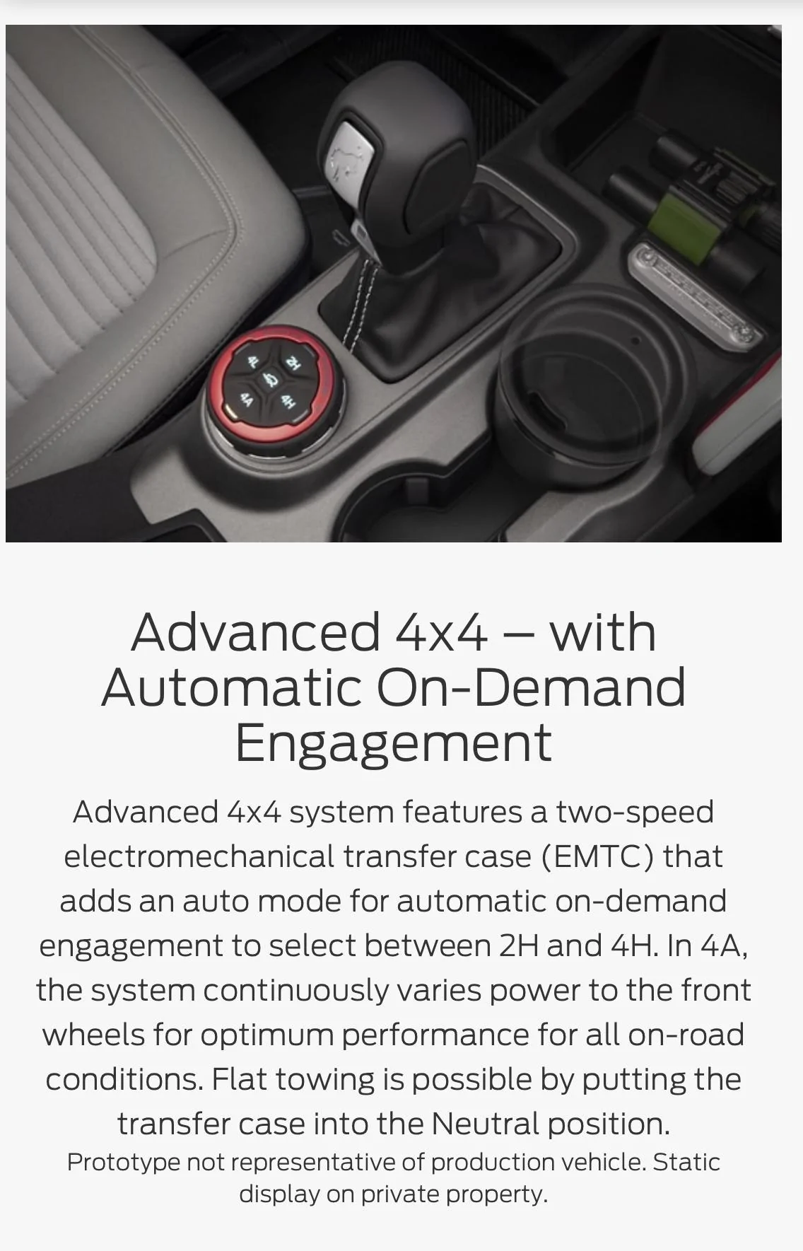

the Ranger is flat towable as is the Bronco:
from the Ranger Product Manager and the Owners Guide found on fleet.ford.com - Yes. 4wd only. put transfer case dial in 2wd, push ignition button to release shifter and place in neutral. Use steering wheel buttons to operate info center to place vehicle in "neutral tow mode", and turn ignition off. That's why I ordered one.

This is the one question I think the Rep got wrong. His answer was correct for the Bronco Sport, but not for the real Bronco. Transfer case in neutral is OK

Good point, my bad. Still think he's in error though. It's stated many places in Bronco info and in the Ranger Owners manual. Neutral transfer case tow is OK.
