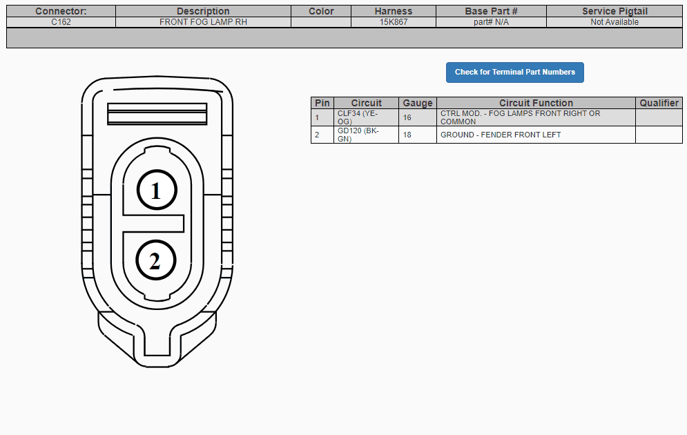

Does it look like this?
Ford Bronco Capable Bumper Factory Fog Light Plug Style? 1664287619701
Or this?
Ford Bronco Capable Bumper Factory Fog Light Plug Style? 1664287683514
Or this?
Ford Bronco Capable Bumper Factory Fog Light Plug Style? 1664287729309

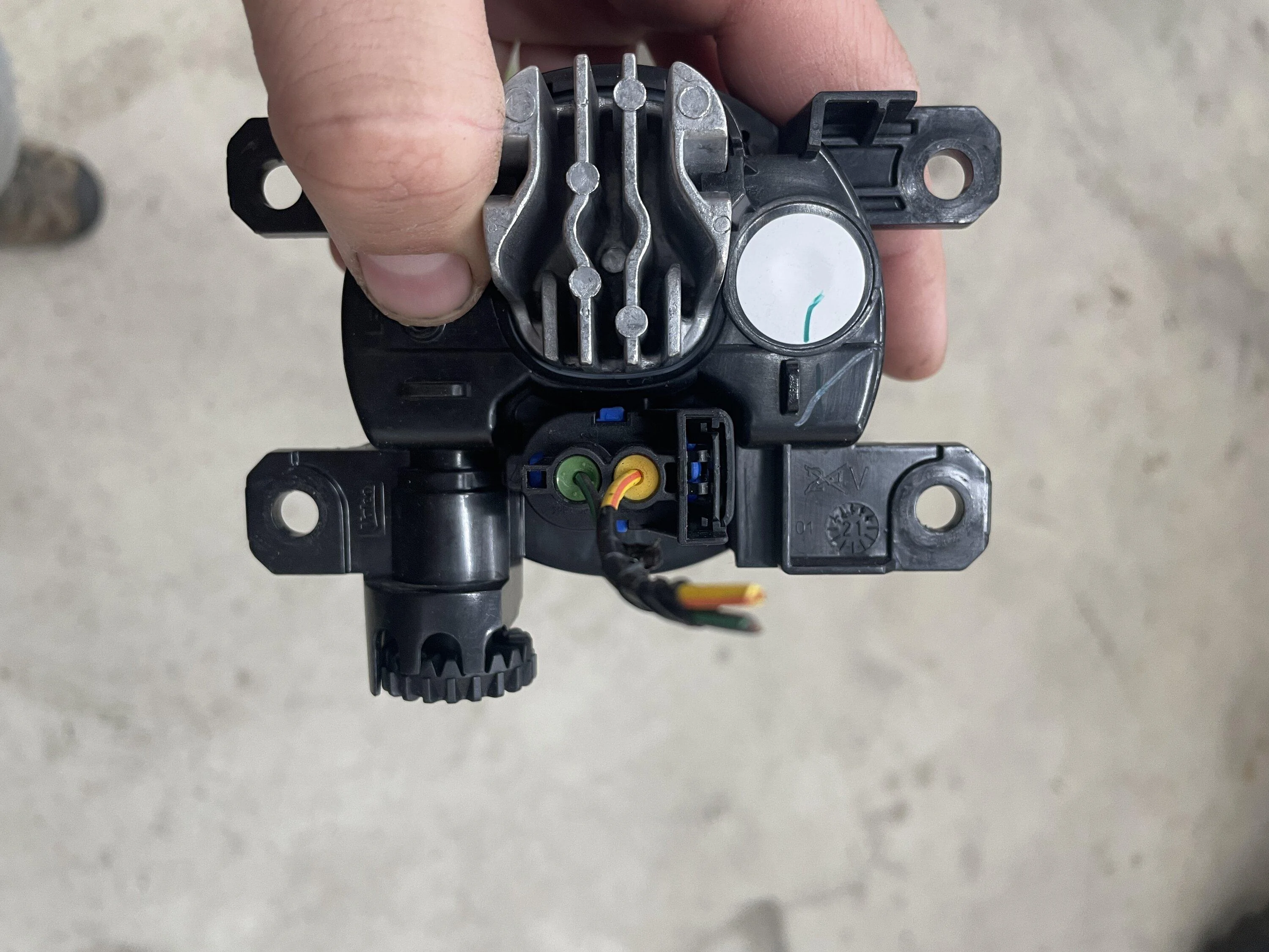

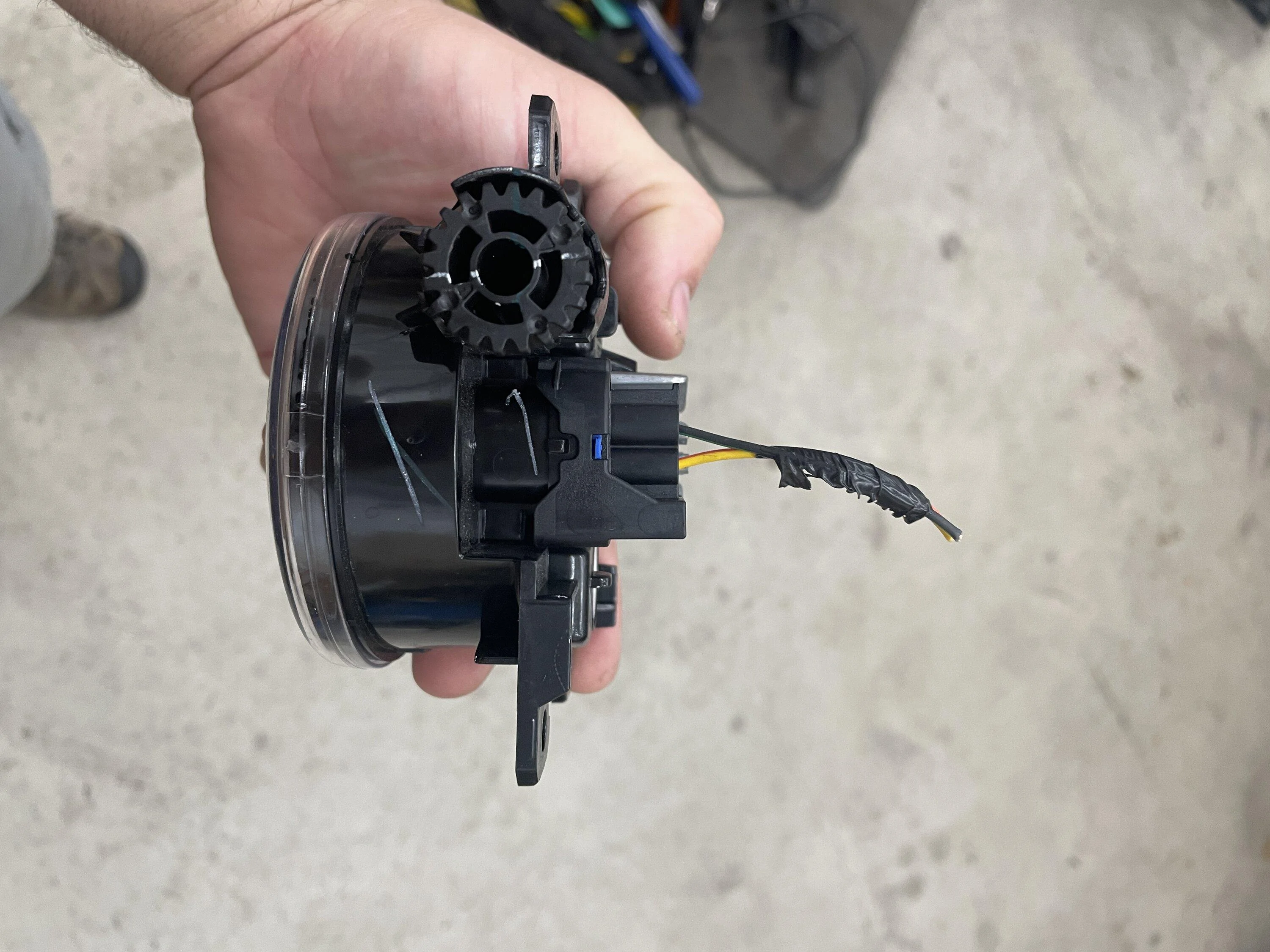

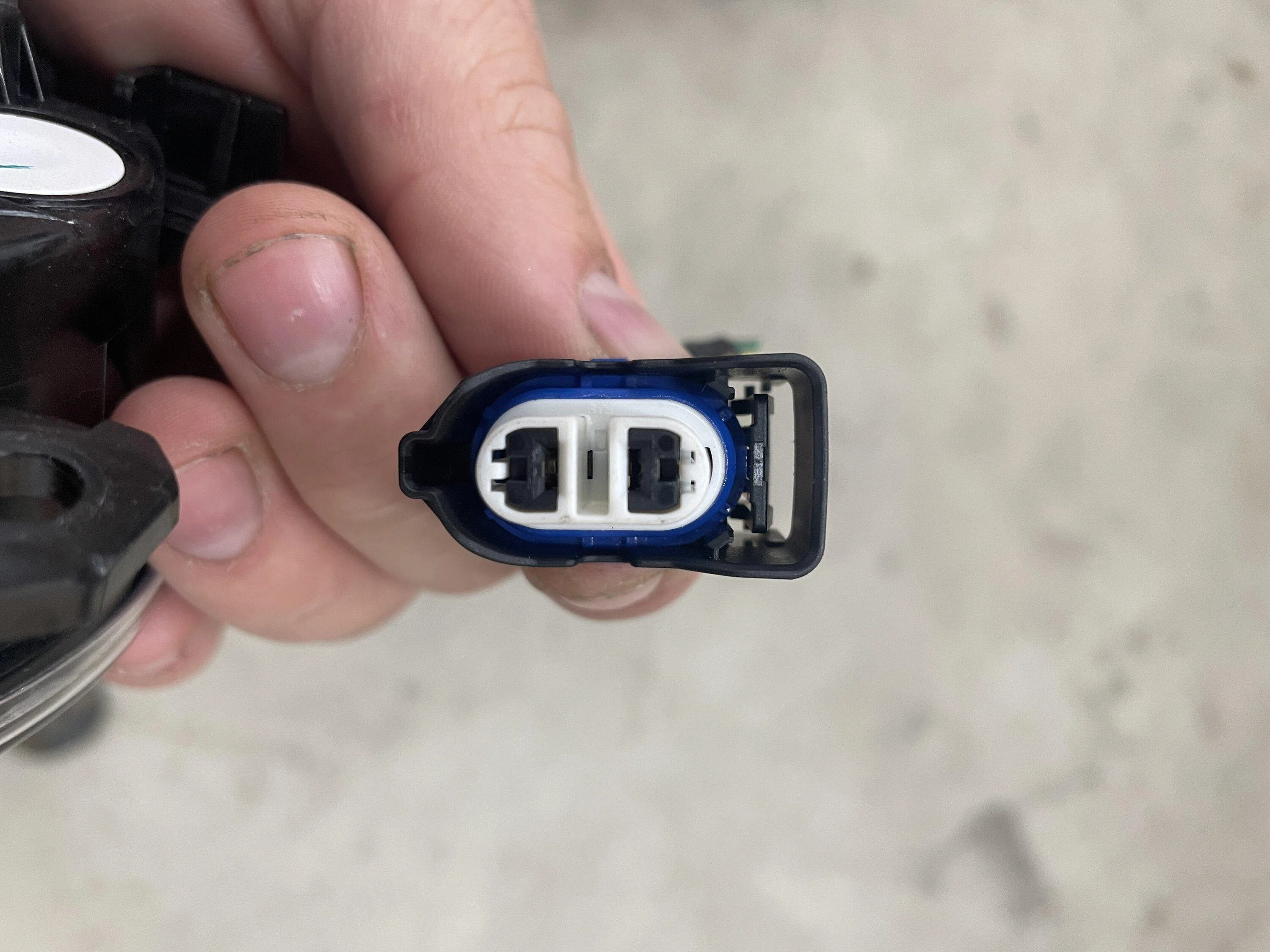

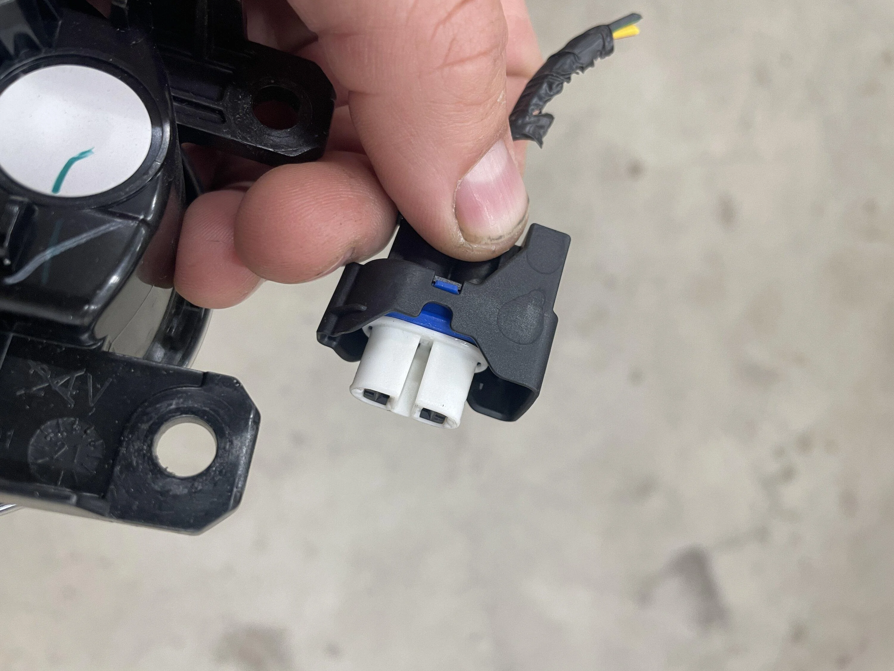

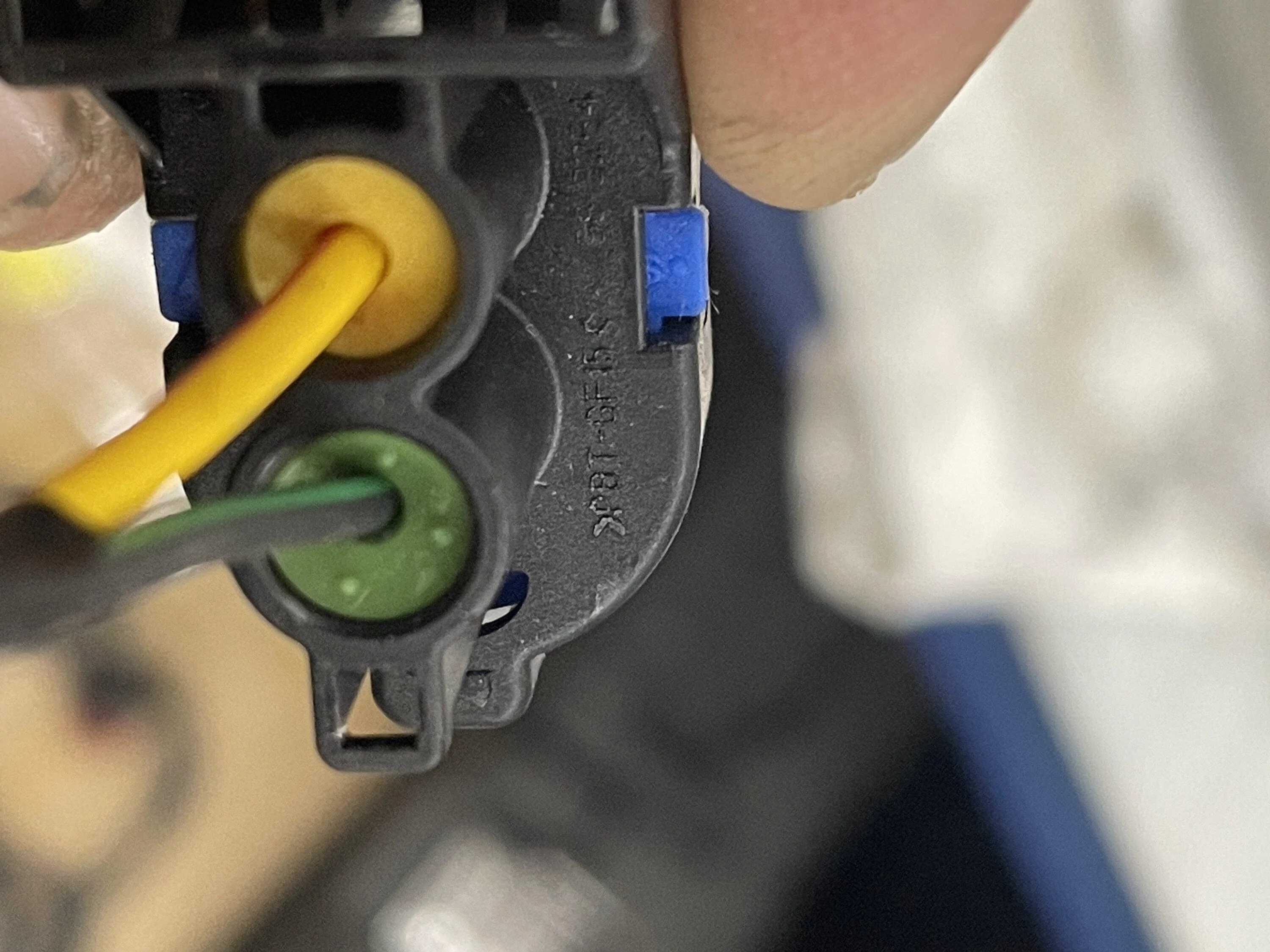

I have my factory fogs and pig tails sitting at home on the shelf, will grab a picture later today.

i just got off the phone with diode dynamics. they are saying it is an h11 plug in that goes to the back of the factory fog lamps on the capable bumper. thanks for the help

It's an H11. This is the harness you'll want:
SS3 without back-lighting: https://www.4x4truckleds.com/diode-dynamics-deutsch-dt-adapter-wires-h11-h8-h9-800-881-pair/
SSC1/SSC2/SS3 with back-lighting: https://www.4x4truckleds.com/diode-...wires-w-backlight-tap-h11-h8-h9-880-881-pair/
