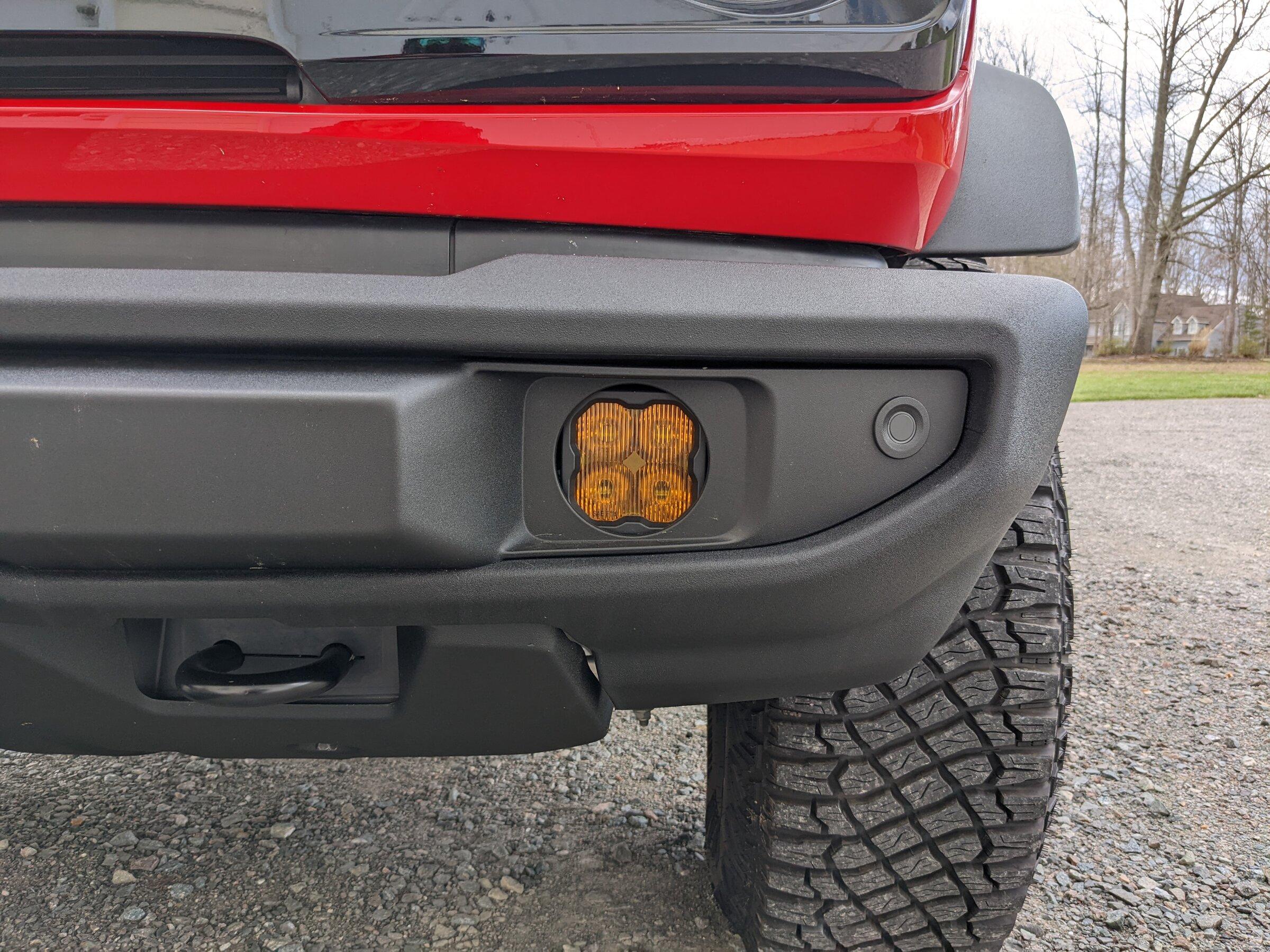

Just to build on this, here is the SS3 max on the standard bumper

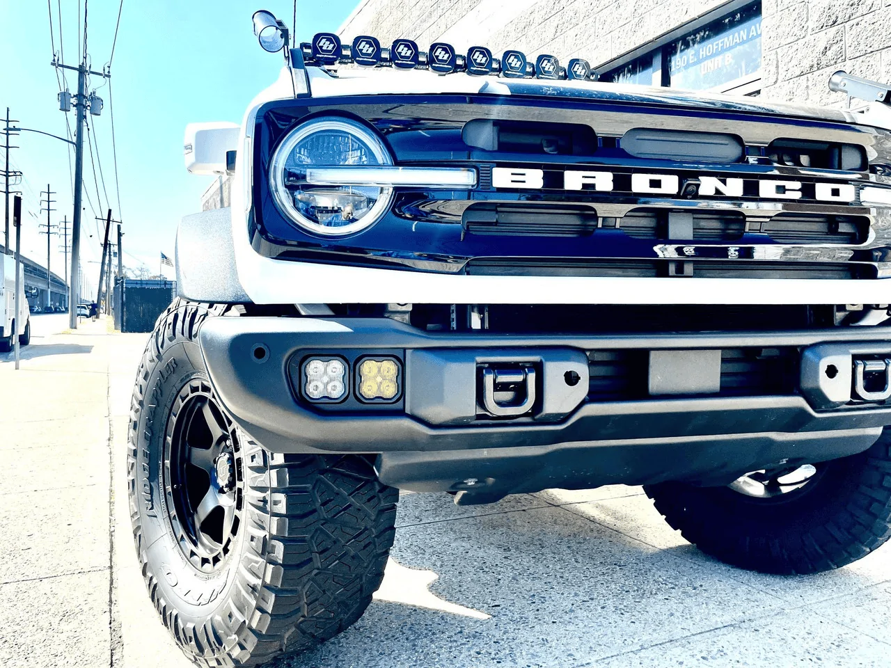

Rehashing the old post since we have a product now...
https://www.4x4truckleds.com/diode-...brackets-for-2021-ford-bronco-capable-bumper/
Our brackets are made here on Long Island from stainless steel and powder coated black. It's a solid 1 piece design for the bracket and they allow you to aim the lights however you need to based on the patterns you select
