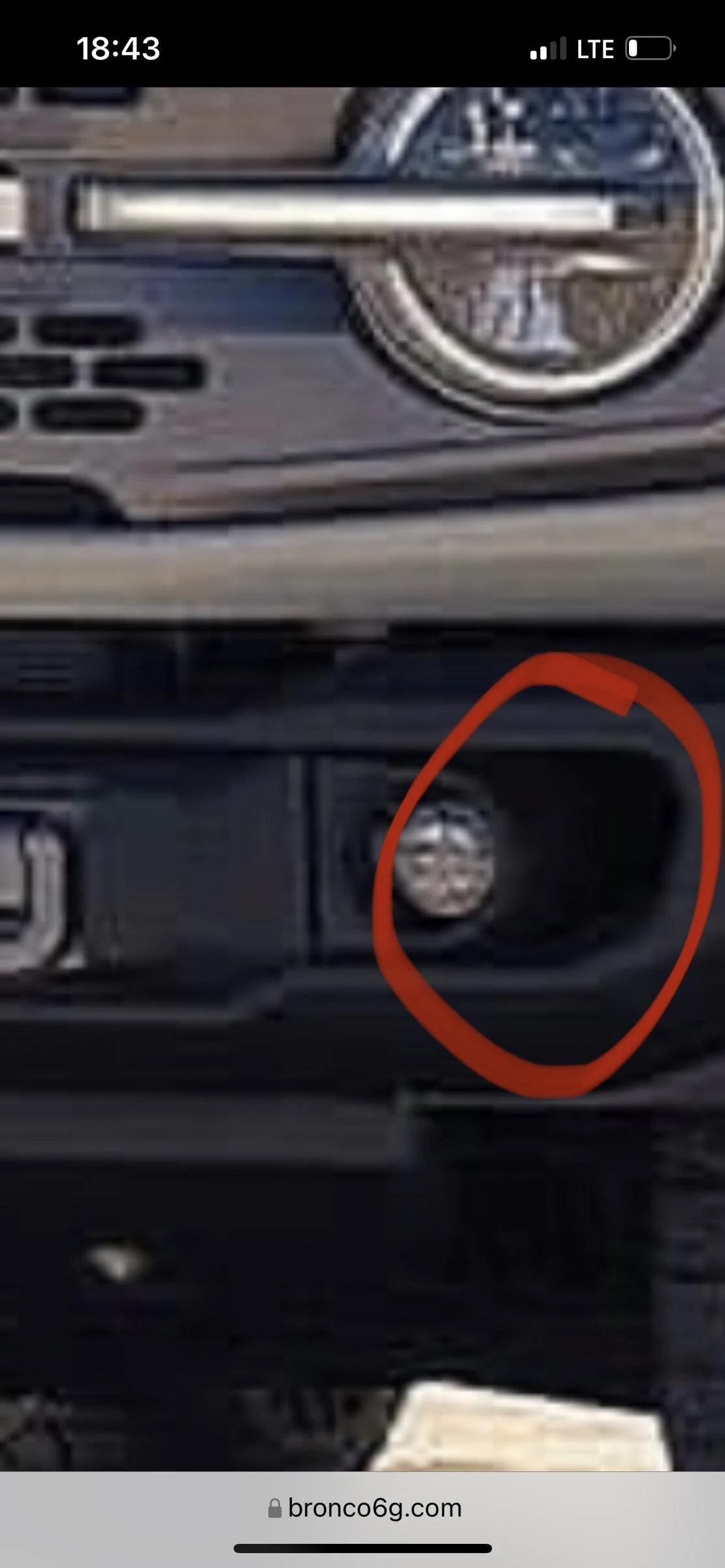

First company to make a light bar that fits that 2inch gap circled in red below, with proper mounting brackets gets my money.
Ford Bronco Capable Bumper Light Bar 75BCFDD5-6556-4BCC-A858-5588C998DB5D
And first company that makes another fog light to fit in here gets my money:

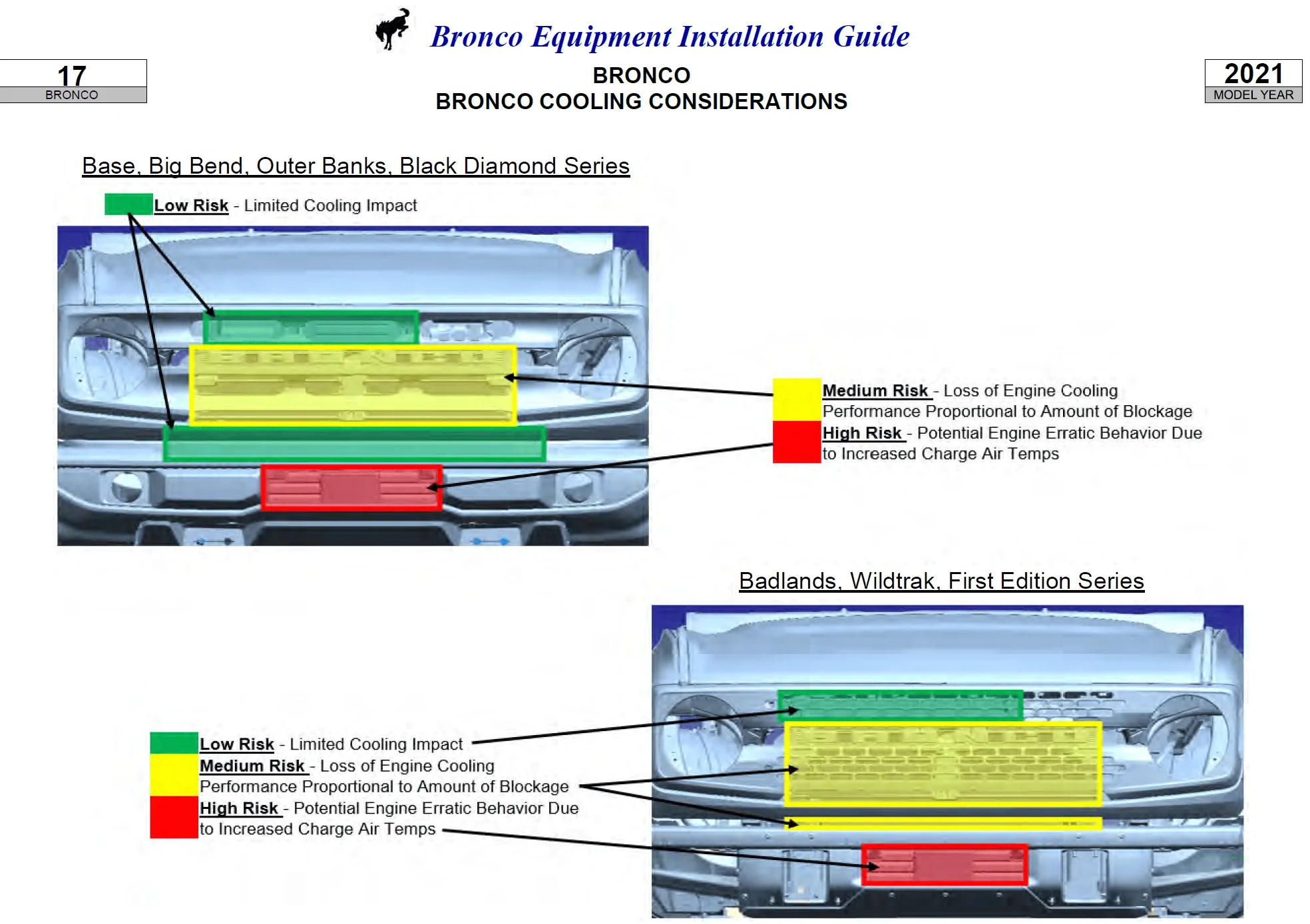

I was wanting that too, but not sure anymore. Passing along the graphic someone shared with me.
Ford Bronco Capable Bumper Light Bar Capable fo
I am getting the Black Diamond and the green gap between the bumper and grill is 2" wide (from another post). The Baja Design s8 lightbar is 1 3/4 wide. This is what I am planning to put in there. I hope it works.
