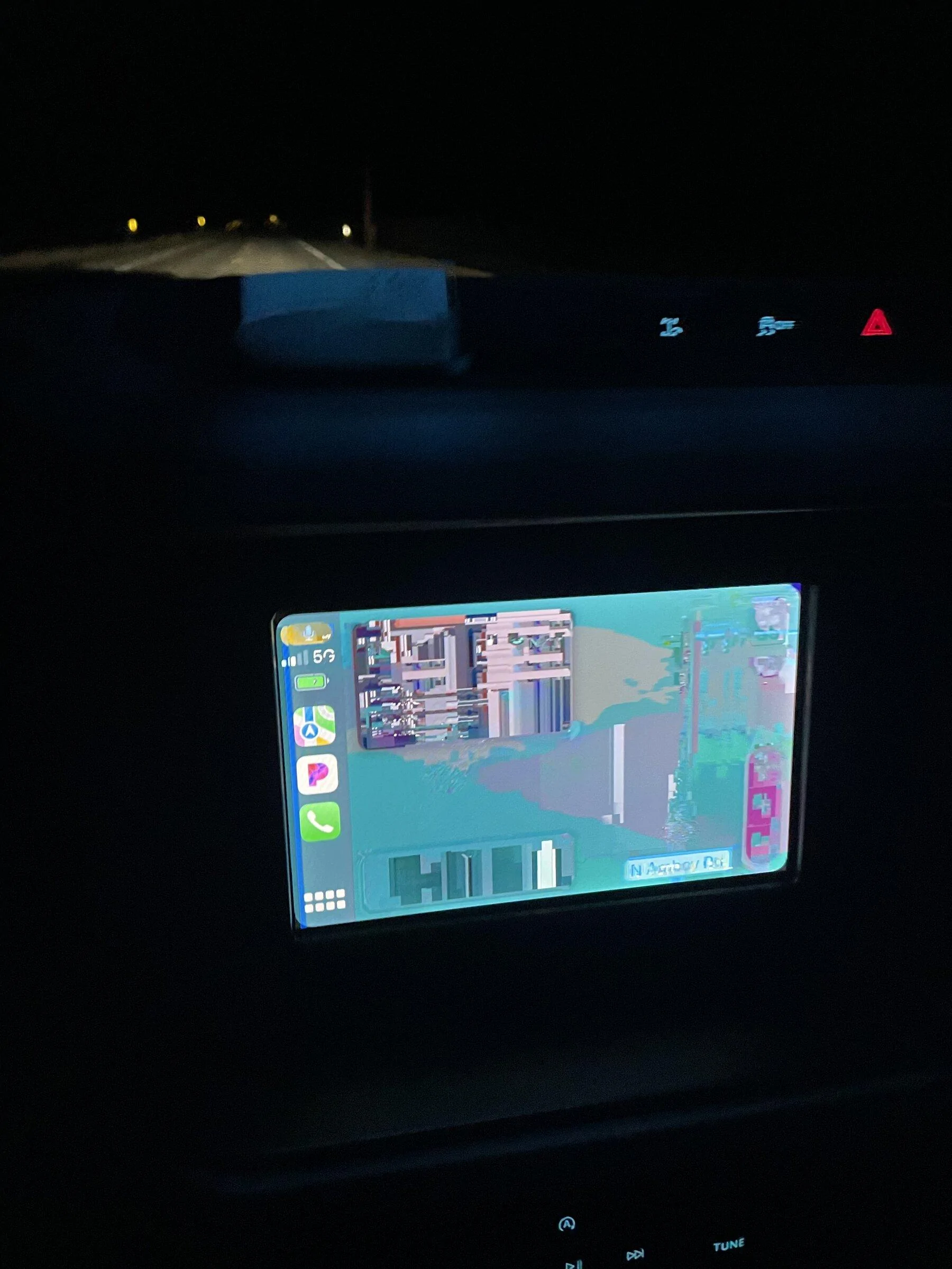

Tonight I took the Bronco (had it since Thursday / 400 miles on it) on the first roadtrip of a little over 4 hours.
I was using Apple Maps for directions via wireless Carplay but at about the 100 mile mark, the display became totally corrupted.
Ford Bronco Carplay Display Corruption 5DBB30F7-7043-4556-8018-10C5871144C3
Tapping App Icons _seemed_ to still work, but hard to tell. Using the tuner to change Sirius stations and then tapping the displayed banner allowed me to get back to Sync where everything still worked/looked fine. The audio directions from Apple Maps kept working as did the small next turn visual cue in the instrument display.
I pulled over and tried to disconnect Carplay from the iPhone but it never disconnected. Turned the truck off and restarted and Carplay connects before I can stop it and the display is still messed up.
Anybody seen this or know a fix or some way to reset the Carplay display system? In the morning Iā€™ll ā€œforgetā€ the Sync system from the phone and try to connect anew but I donā€™t have any other ideasā€¦

Try restarting the phone, as well as the entire vehicle. If issues persist, take it in to you dealer.
Wow, either restarting the phone and/or letting the truck sit turned off for half an hour did the trick. Nice call šŸ‘ Now to see if it returnsā€¦

How hot did your phone get?
I've seen lesser corruption on other vehicles, and I put the phone in front of a vent to reduce the error. Not saying it's the same, just maybe.

I had a similar problem after less than 12 hours of owning the vehicle. It turns out it was the APIM (computer that controls the accessory modules and Sync 4). The problem turns out to be a software glitch that is actually 'bricking' the APIM itself. When this happens, the entire APIM has to be replaced. Problem right now...they are NOT shipping out a new APIM until they get new software. Supposedly the software update was supposed to go out to the two suppliers of this APIM yesterday (12/12) (weird that it is on a Sunday) but after the software update they are supposed to be able to ship out new APIM to fix mine. Checked today though (12/13) and they still do not have a status on when they can ship out an APIM. Only was told they have 200 that need to be shipped and no ETA was available on mine till possibly later this week.
So there you have it. I have had my Bronco less than one day and it has been in the shop ever since waiting on the above. Yippee.
