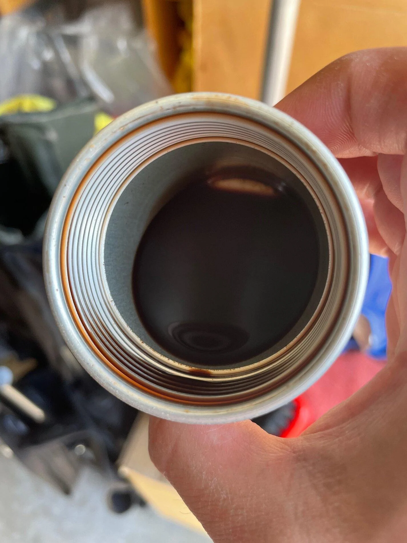

I run a catch on my Raptor. The 3.5 has direct and port injection. I emptied mine last week after 6500 miles.
I am def running one on the 2.7.
Ford Bronco Catch can install 1624133479386
JEEZ .... thats' exactly why I want to install one ASAP .... which brand is this one? any pros and cons? would you buy the same one again or change?

JLT. I ran one on my 2013 raptor and running one on my current raptor. NA engines are not bad but turbo engines have a lot of blow by. I am sure JLT will make one for the bronco
