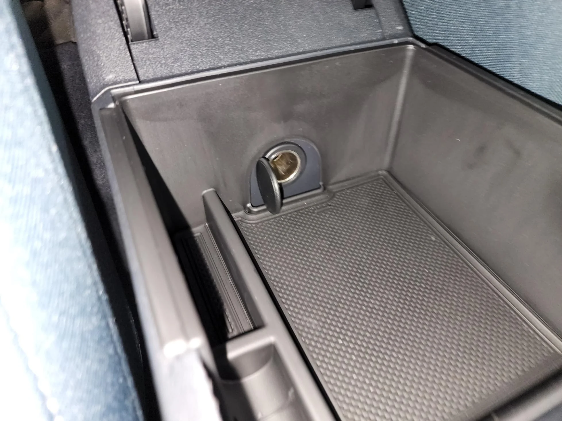

Hi all,
Search the threads for an answer but couldn’t find anything. Before I have dealership tear apart the Bronco interior, looking to see if anyone has any suggestions.
The interior center console “cigarette” lighter port outlet is inoperative (see photo below). I tried several car charger adapters but none work. However, adapters do work in the cargo area power outlet. Also the rear seat lower power receptacles and USB outlets are functioning and powered.
If it is a fuse problem I was unable to isolate (i.e. find) which one it was.
Any thoughts on getting it to power up?
UPDATE: "Fuse 32 was blown." Dealer installed "GU5Z 14526 F" Fuse. Problem fixed.
Ford Bronco Center Console Interior Power Outlet Inoperative center console outlet

Do you have the ignition on? I’m not sure I’ve tried with it off.
Side note what insert is that? Looks nice.

Hi all,
I use that port to power a small refrigerator/freezer and here is what I discovered: First, the port doesn’t activate until the vehicle is running. Secondly, it becomes disabled about 30 minutes after the vehicle has been powered off regardless of a load being applied or not.
Last, it seems to be very sensitive to how the 12 volt plug is inserted into the recepticle. You have to make sure the plug is fully inserted and give it a slight twist to ensure it is engaged.
I mention the above because I too thought it wasn’t working at first attempt to use it.
Yeah, I read gleaned that from various posts in my search on this issue. If only I could test it myself. :LOL:
Yeah, I did this as well. Fully inserted and twisted. Even more so than the outlet in the cargo compartment. Nothing.
