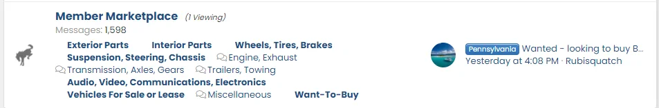

Drew5150, thanks for posting this project, its interesting to see whats what! Is there a site for swapping, selling parts? Id maybe like to buy a set of Badlands stock wheels for my OBX from someone upgrading their Badlands.
Could always start here on B6G itself...
