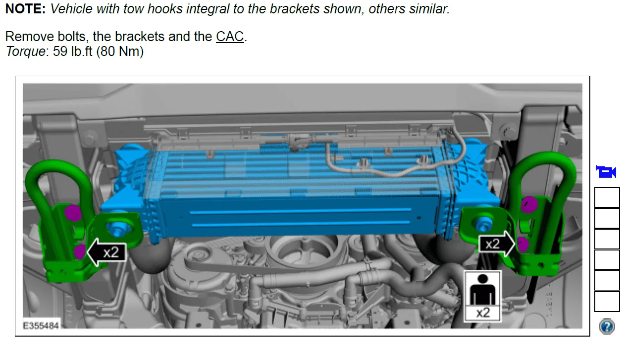

Your latest PDF doesn't show any lower intercooler brackets that I can see, either for mod or non-mod bumpers.
The front tow section PDF you posted *does* show some lower brackets (green) - at least for non-mod bumpers - because of how the hooks are integrated.
Ford Bronco Changed out standard bumper for Heavy-Duty Modular Bumper. 1632148367960
In any case, gaining P/Ns for the hookless lower intercooler brackets needed for swapping from a standard to a mod bumper would be handy as more people wind up doing this sort of thing.

OP ... I am so confused. Do you have any pics of the bracket before you cut the tow hooks?
I assume if I need to replace the Intercooler, I would unbolt that bracket that contains the tow hooks correct? If yes why did you just not unbolt the entire bracket?
