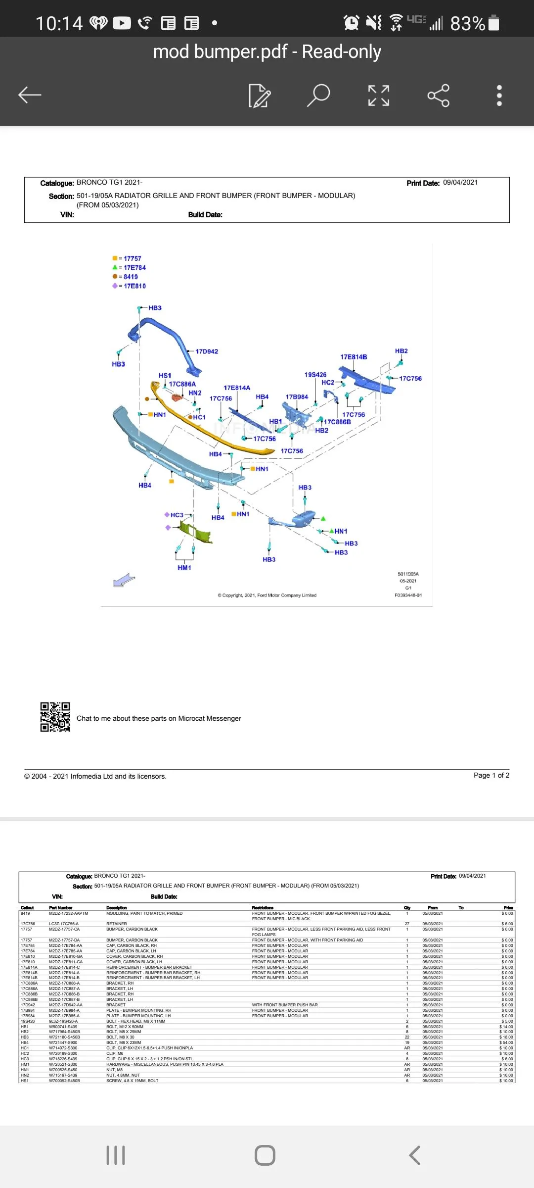

Might just pop off the plastic one tonight and see how it lines up. Did you come across a diagram for the MOD bumper? I purchased one from a member locally but everything is just in a single box without anything labeled.
You can use existing frame plate, and all 6 bolts from standard bumper. Once you pull standard bumper off you will see how it all works. If you have any questions when you get into it text me 4408649779. Happy to help, can walk you through it.
Reuse 17C886B and HB1 same part for both bumpers!

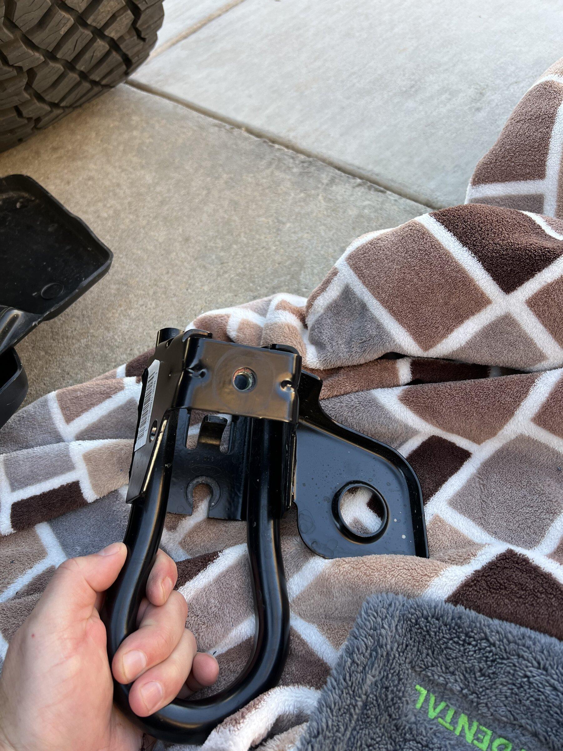

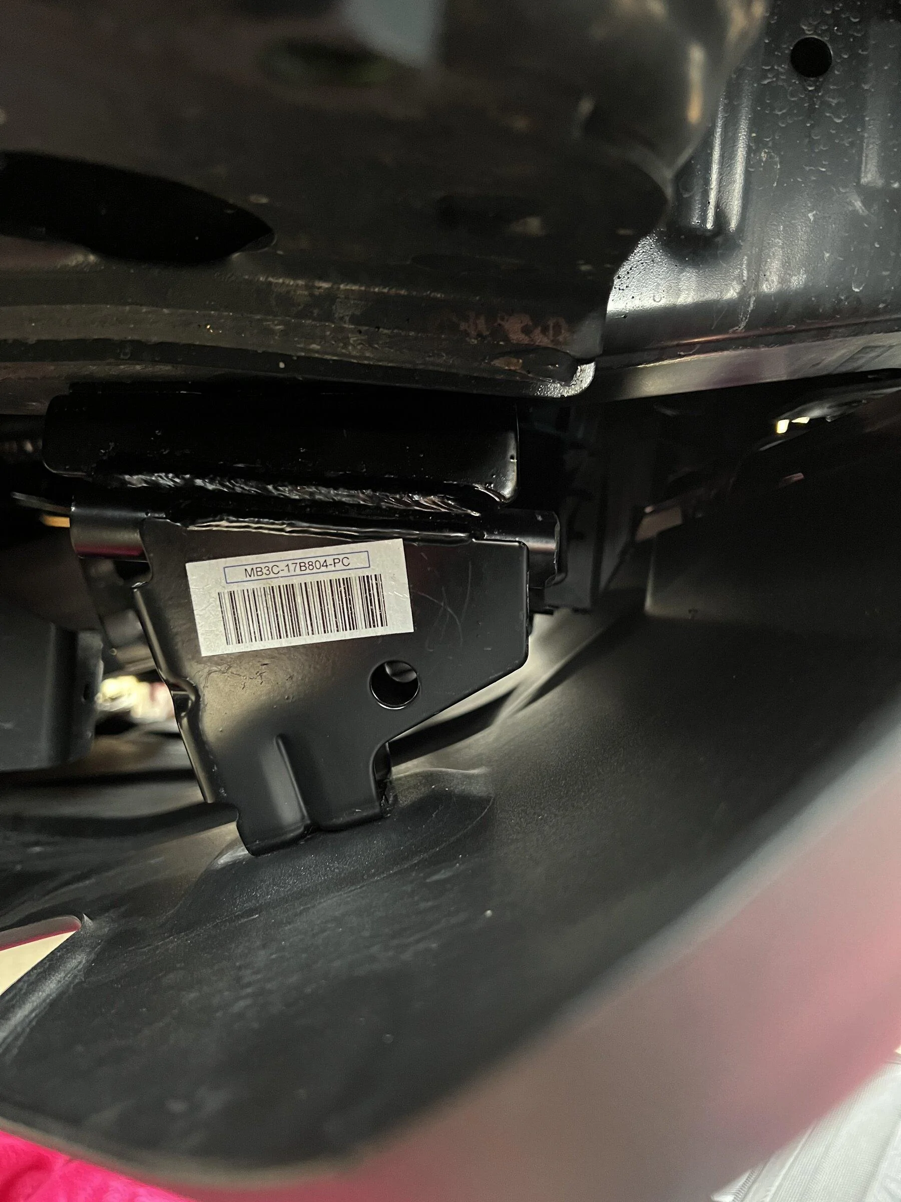

If you are going from standard to mod, could you use jack stands / jack to hold intercooler in place, remove brackets w/ D ring, and install brackets w/o D ring?
I cut my standard tow hooks off with a grinder. I would think you could use a jack stand to do one at a time.

Cooler bracket's, part numbers without hook please?
