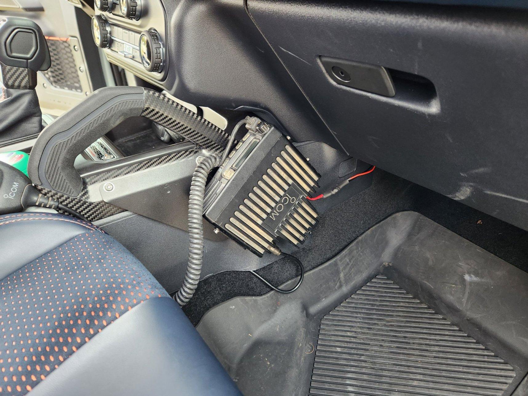

The Rugged Radio Bracket works perfect.

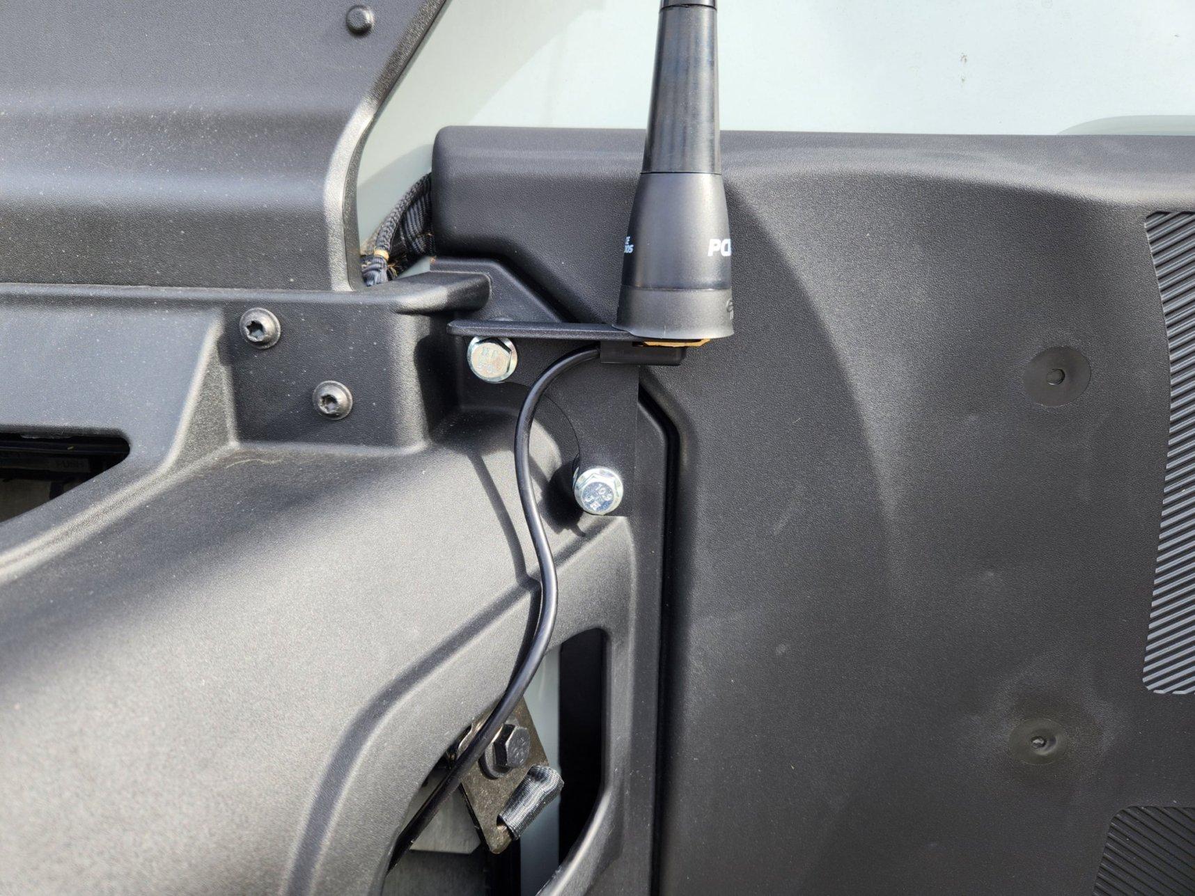

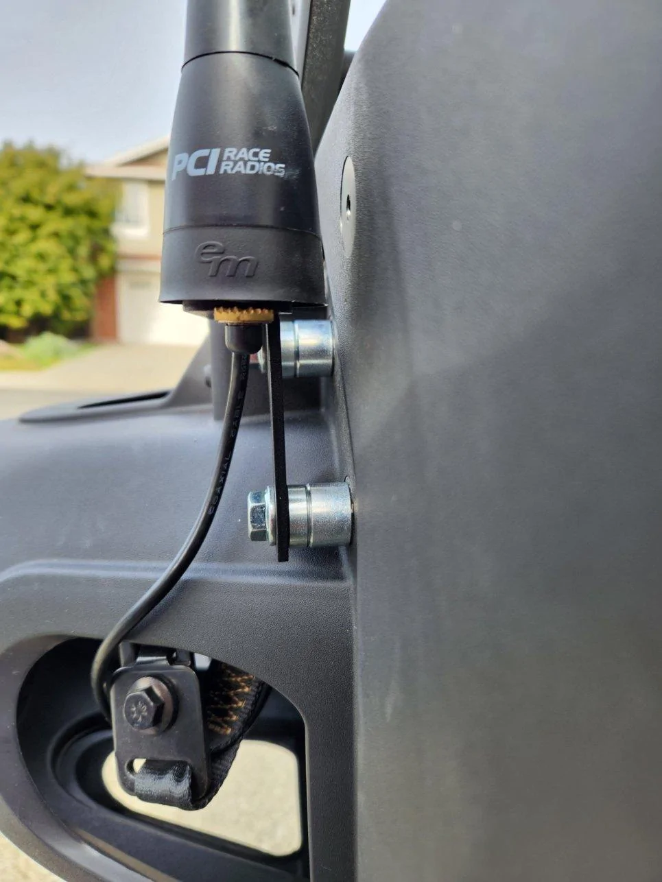

The JCR Antenna Mount had issues but I think they are specific to the Raptor. Since the Raptor has the upgraded rear door when you mount the bracket flush it has a "slight" bend to it. If you only were going to use this bracket for a flag I'm sure it would be fine however it left no room for an Antenna to actually mount. After a few trips to the hardware store I ended up getting some spacers and throwing them on there, which worked like a charm. The total spacer is probably about 3/4". It touches the tire but has not bend from the contact.

Radio Bracket.
Ford Bronco Chase Radio - Icom Race Radio installation 94Z5OLJ3THKb7gvzFJLVkA
Side view on Antenna Mount and Spacers.
Ford Bronco Chase Radio - Icom Race Radio installation WJr1gXA_SWSlQxK28YkFww
Rear view of Mount.
Ford Bronco Chase Radio - Icom Race Radio installation PrzA_XMkSlOhGcUQFlIho

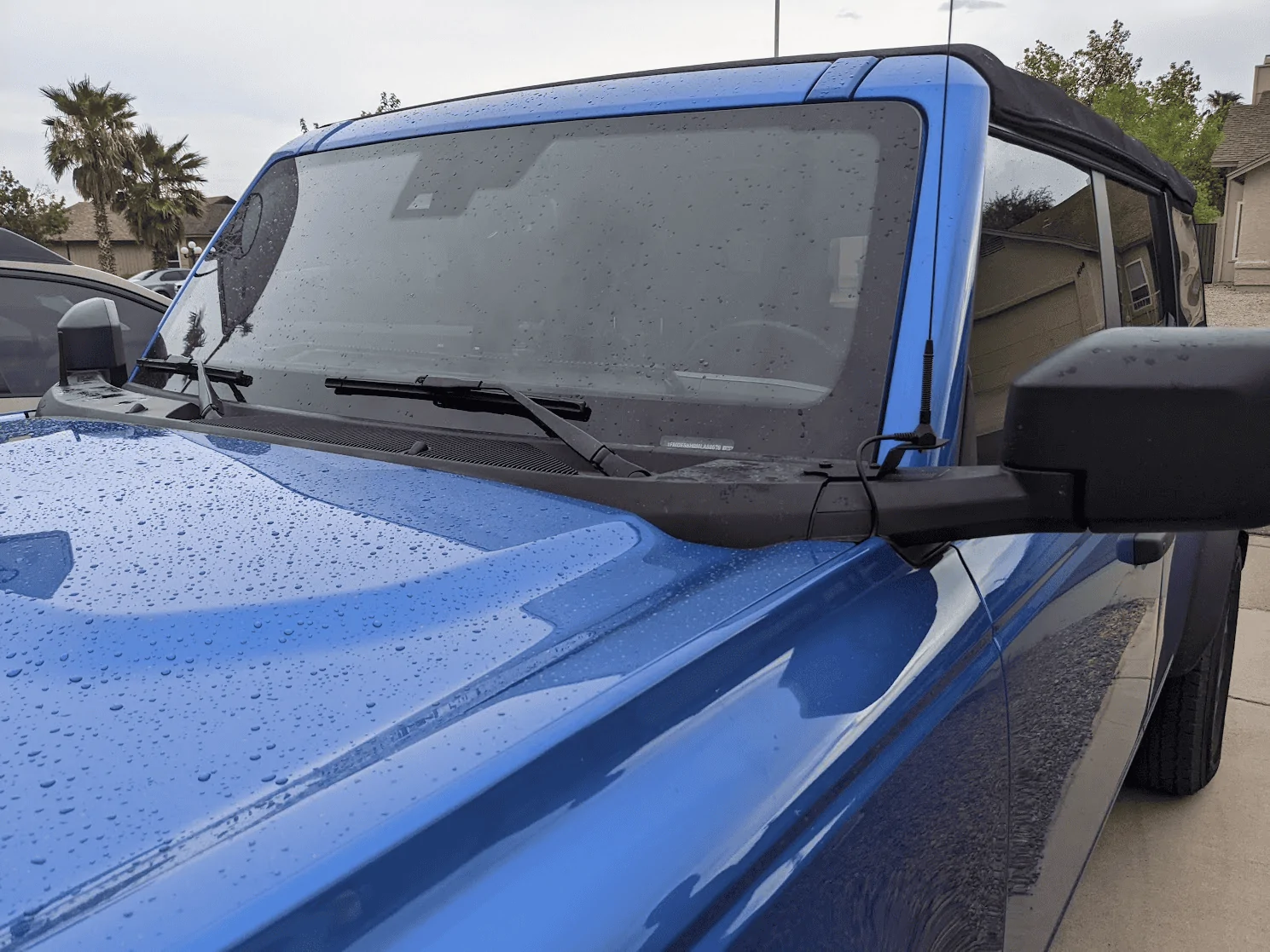

Ran the antenna and power leads through the firewall grommet though, and mounted the antenna up front with a ditch light mount
Ford Bronco Chase Radio - Icom Race Radio installation 1676844626107
