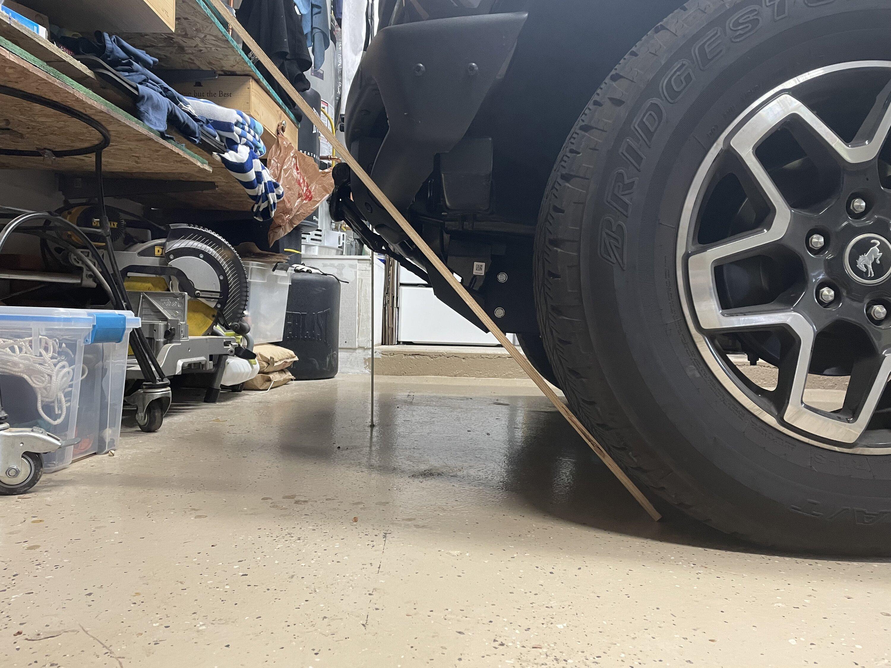

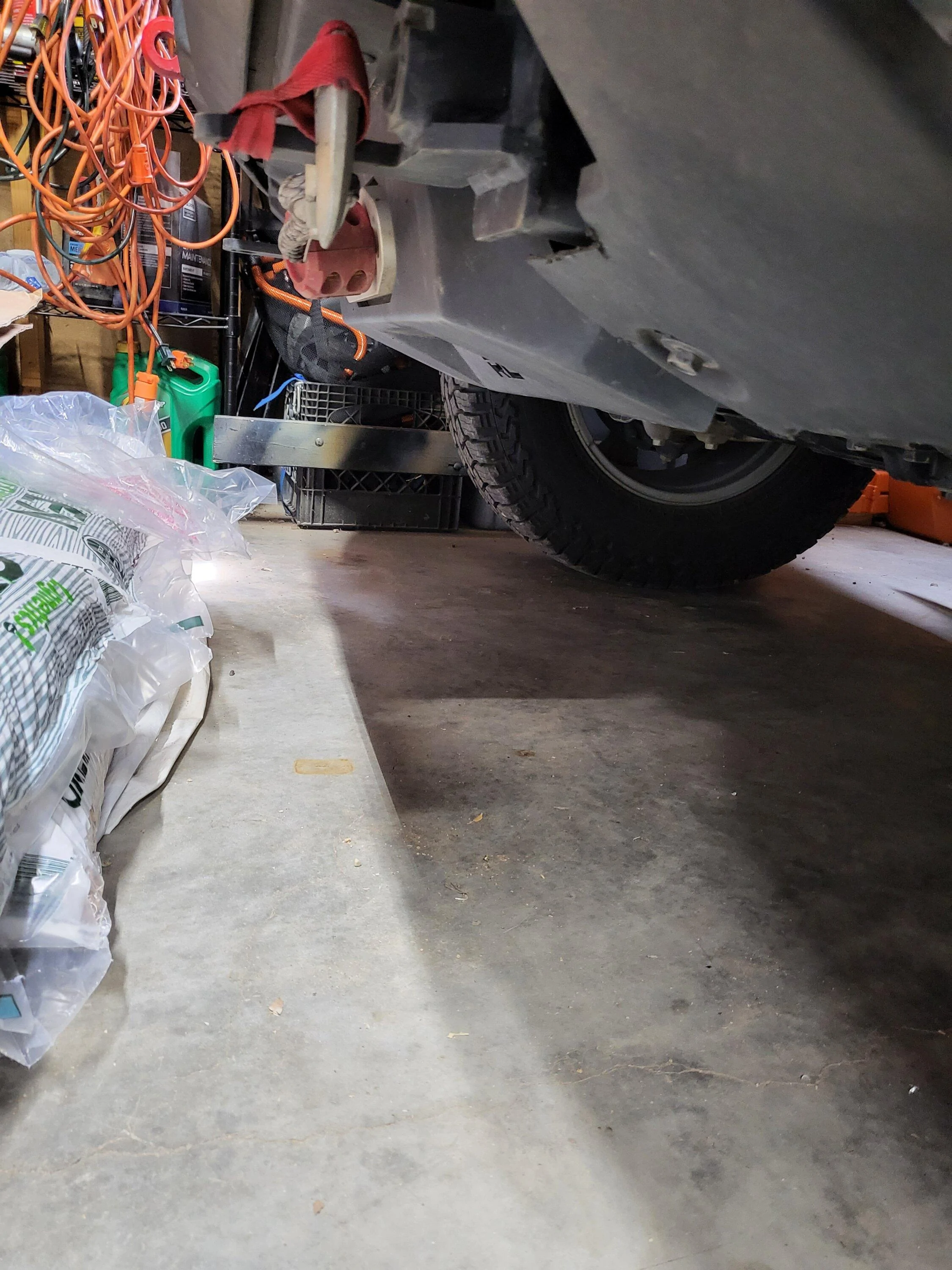

Hang on, just installed mine on a Standard Badlands MT.
The winch cradle is even with the plate under the oil pan and the winch bash plate doesn't go any lower than that. I think it sticks out a bit further at some lower points and may give a slightly less steep of an approach angle in places but it's not an easy direct comparison.
I was expecting to lose a lot and was pleasantly surprised at how little it seemed to appear different or any worse.
Squatch
4,128
16,644
Miami
I don't feel it really lowered anything by an appreciable amount.
Ford Bronco Clearance after installing winch? IMG_20230521_094103_719
Ford Bronco Clearance after installing winch? received_622142516517667
Smittybilt X20 Gen3 12K winch w/Bluetooth fit just fine. I got that so I don't have to use a corded remote. I just flick the upfitter switch to the solenoid and the winch is energized (Bluetooth receiver switch always set to on) and I just turn on the remote I keep in the center console and it's glorious.
