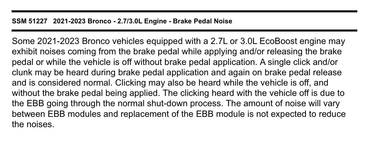

Ducati1098
3,693
7,360
Midwest
2022 Bronco Wildtrak, 2012 Ford Fusion
Ford Bronco Clicking sounds when braking IMG_1062
