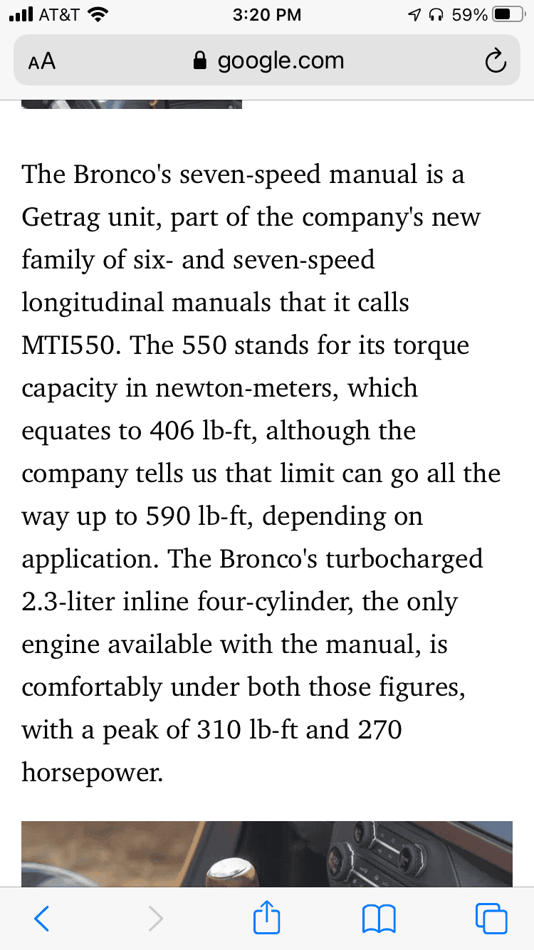

I found this from car and drive
Ford Bronco Clutch rating C0D6FAD1-75EE-4EDF-AA92-8E3234C50394
RunningJerk
RunningJerk
Jan 23, 2021
46
NW Ohio
2017 VW GTI
Thats the for the transmission, not the clutch, though. I’ll use my current car, a VW GTI as an example. My transmission can handle 4-500+ hp but my clutch can handle 270ish ft/lbs Of torque before it starts to slip. Before I get excited about the possibility of a tune with the MT I want to make sure it doesn’t involve pondering having to upgrade other items immediately just to handle the additional torque!
