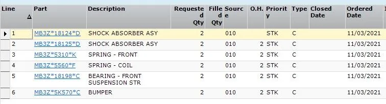

I think this was a better option, same price as the Sasquatch package shocks and springs:
This is what I am going to be rocking on my 2 door OBX, if I ever get it. They took less than a week to get in. Best part, in addition to the 0.67" lift, is I will gain 10.7% more front and 14.6% more rear suspension articulation.
Not bad for a $1300
