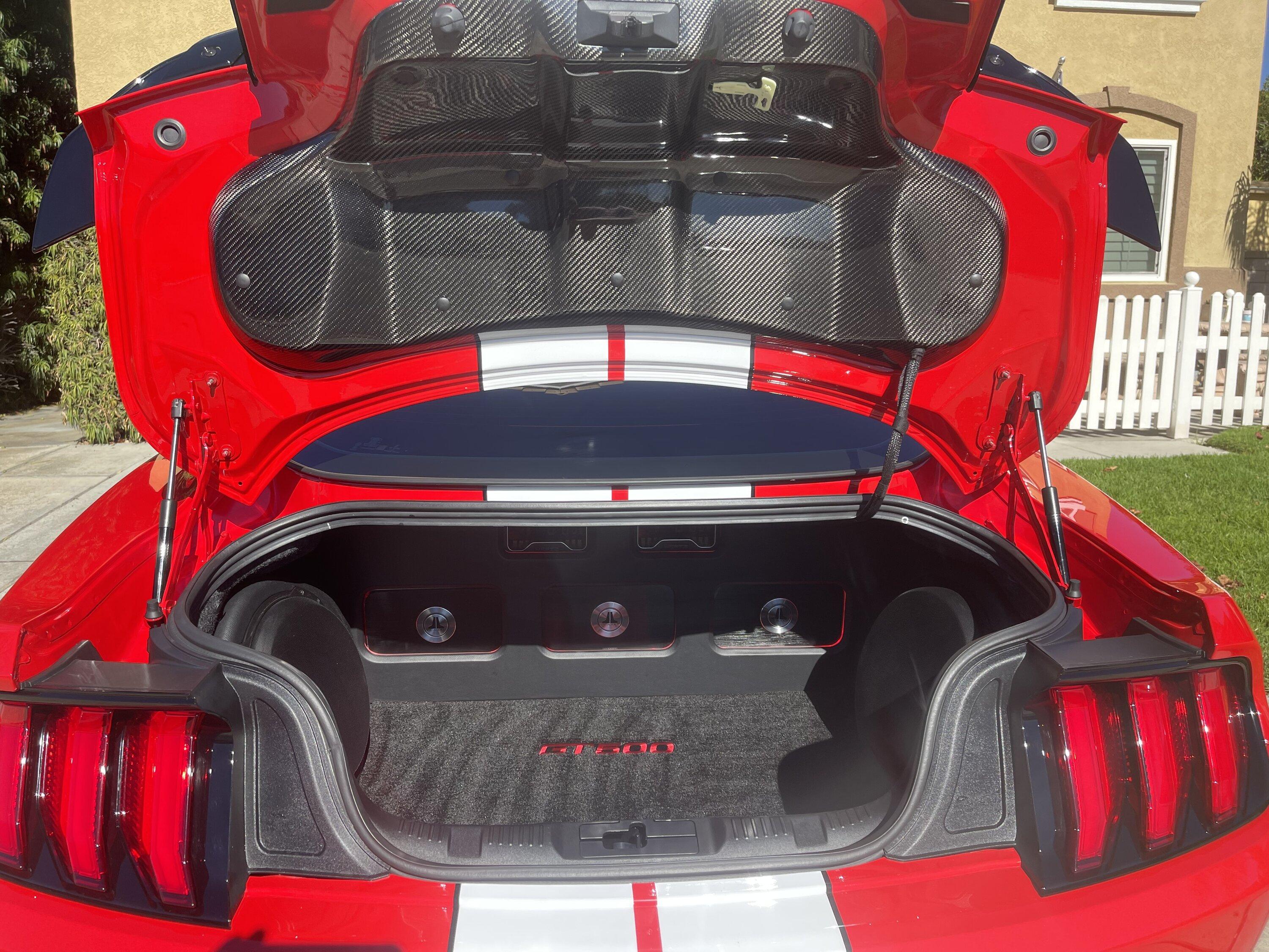

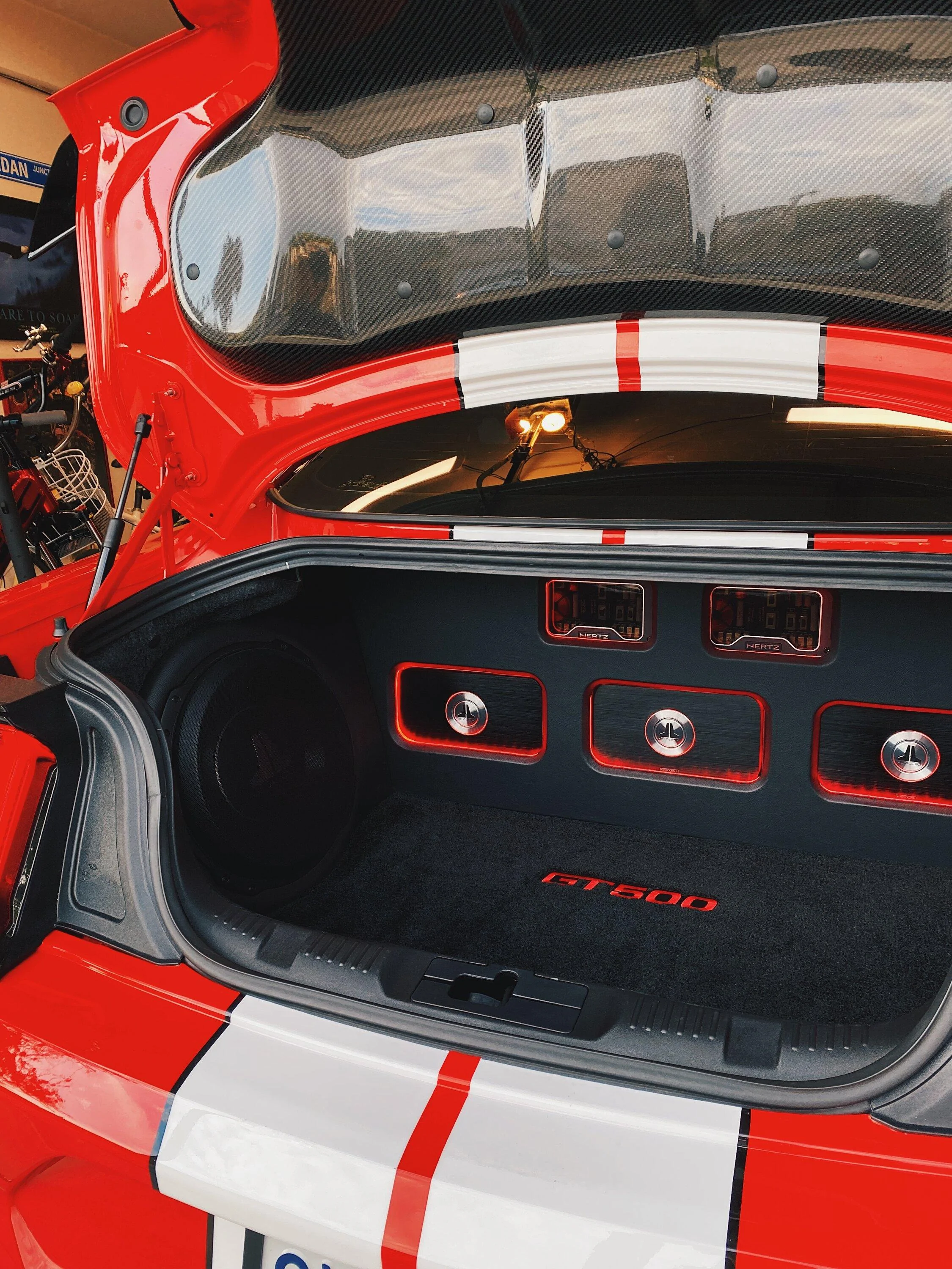

I just added a complete audio system in my new GT500 about a year ago and I went a little overboard with that project😂
