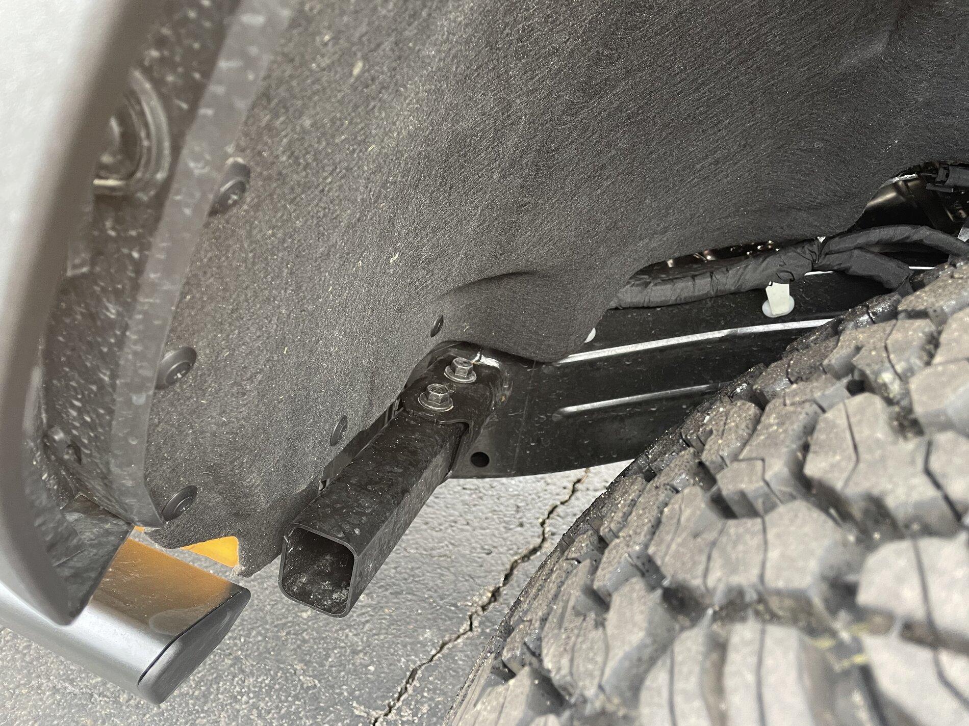

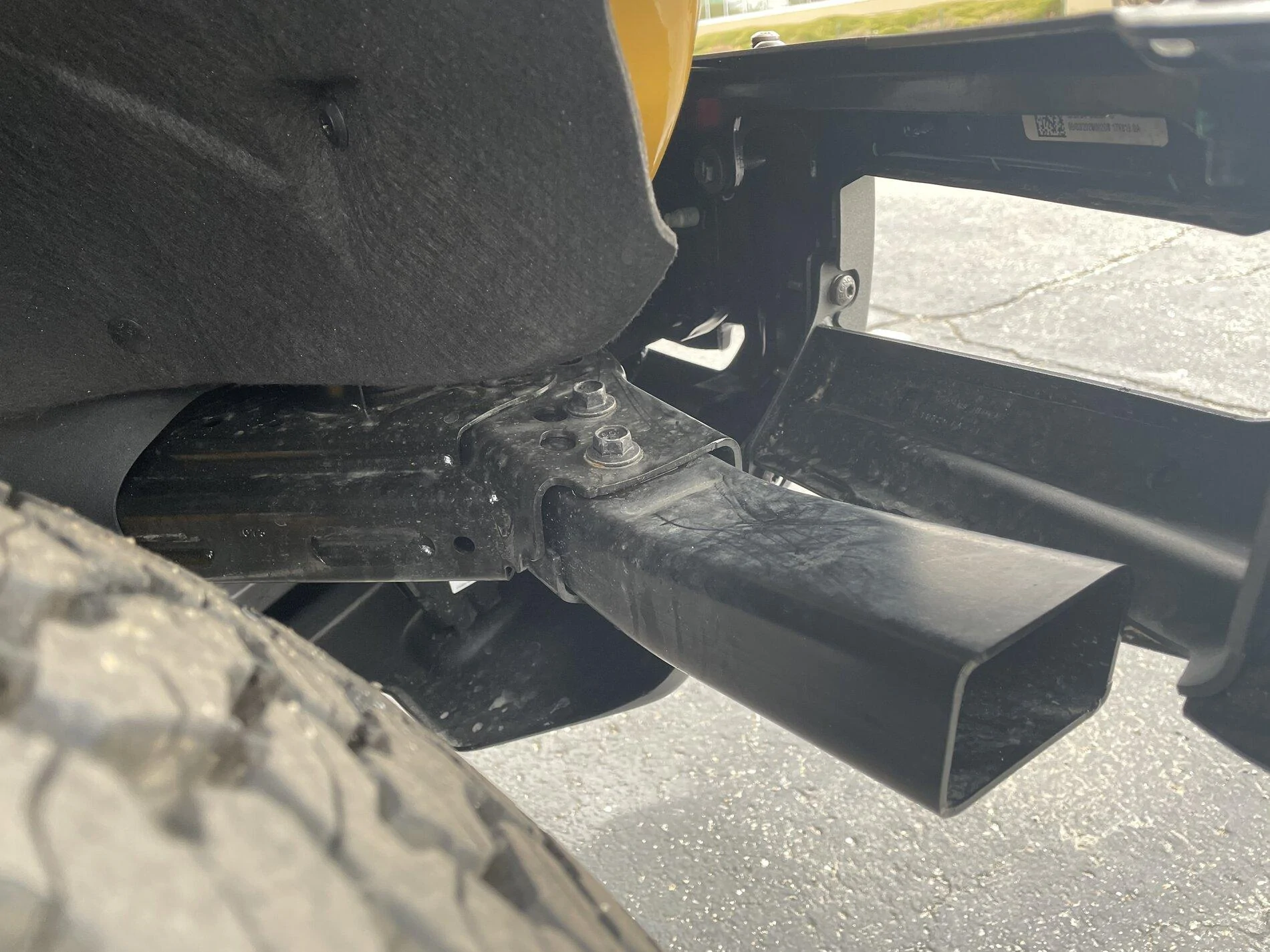

What I can tell you, is that they are bolt on and will be easy to remove if you need more clearance for larger tires. I took these pictures a couple of months ago of the front and rear crash bars in the front wheel well. This is on a Badlands with standard wheels and tires.

Not an expert here and I had the same questions, what was explained to me is that they are very useful in traffic accidents in protecting the cab by keeping the wheels from being pushed up and in. But they can be removed for rock crawling or if you chose to add larger tires again not an expert

Those pics give me the impression that 33's should fit Black Diamond no problem. At least front to back. I guess the issue might be if the different suspension on the Badlands makes a difference at all. I'm new to this, so let me know if I'm not thinking about this correctly. I've seen the big write-up thread about this topic, but the measurements seemed like the fit on a Black Diamond would be much tighter.
Would the upgraded Badlands suspension really make this much of a difference?

Great post and pics. Best pictures I’ve seen of these things so far! Gets rid of all the guessing.
I would guess 33’s will fit, but you may need a leveling kit or larger bump stops to keep them from rubbing the fender flares at full flex and wheels/wheel spacers that will allow you to turn the larger tires to full lock without rubbing.
This is the same thing that needs to be done on the Jeep JK’s when upgrading to 33’s from the factory tires. I couldn’t tell you with the JL’s, but I bet it’s the same. Pretty simple and not too expensive.
