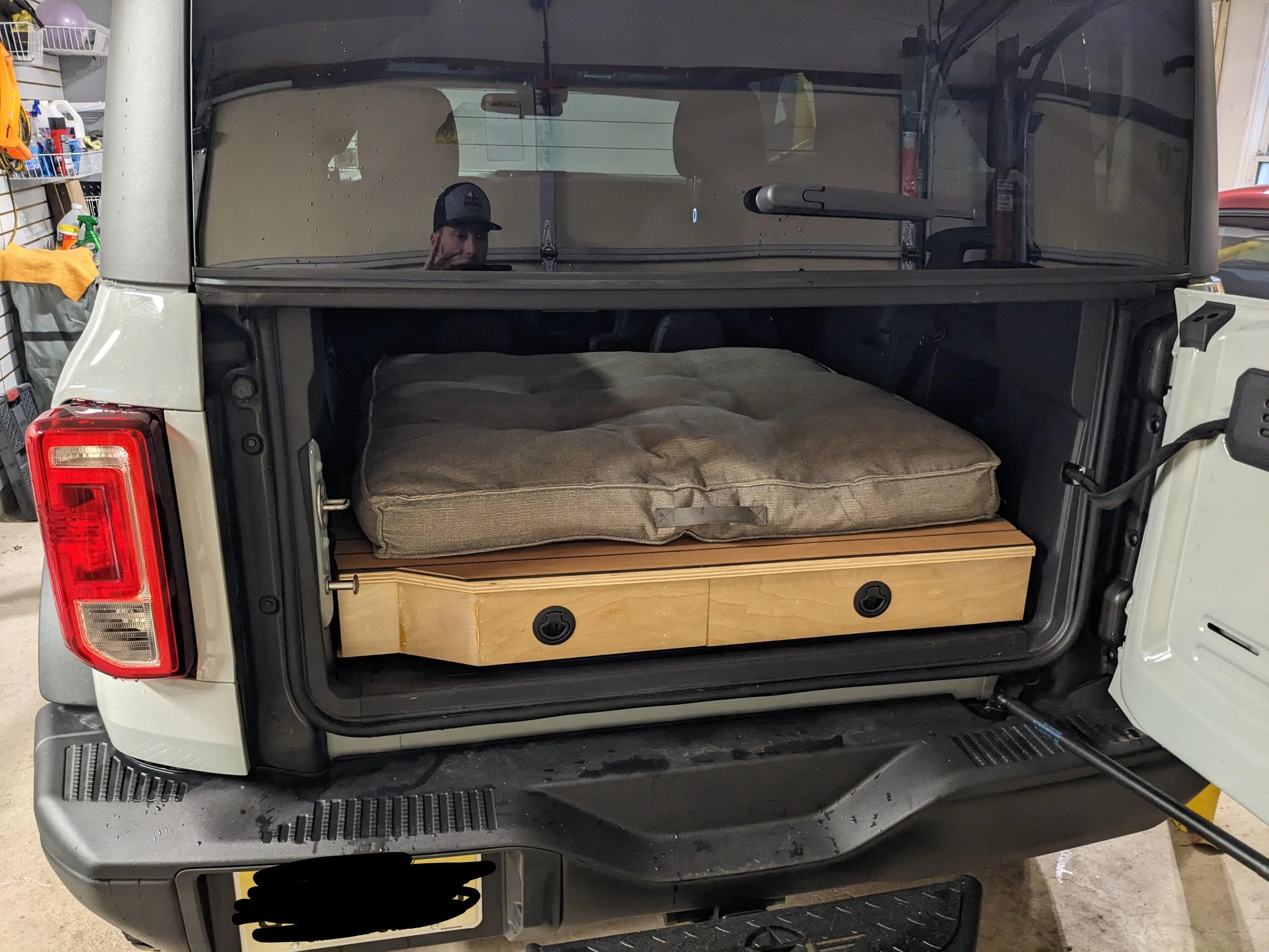

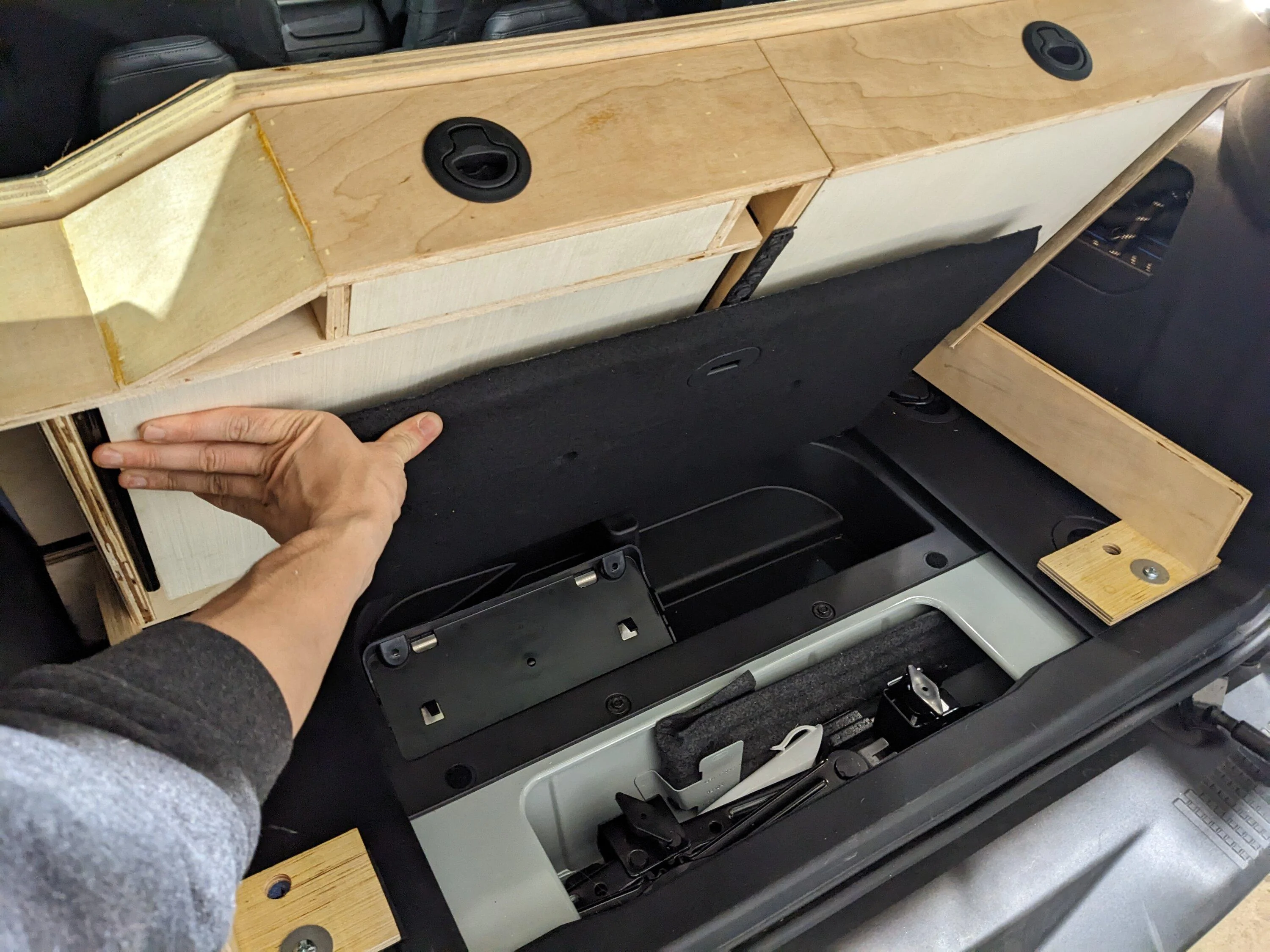

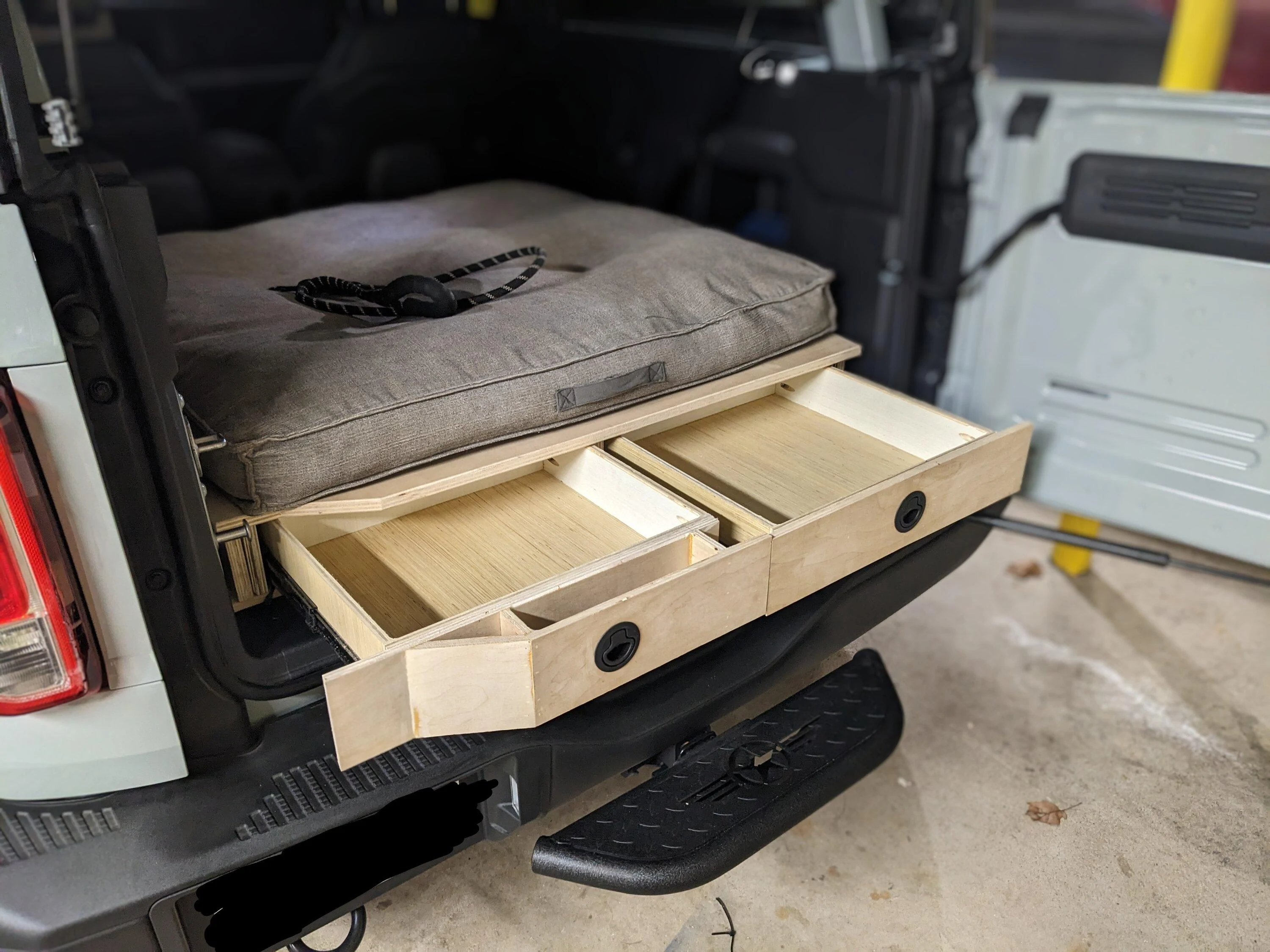

I know there has been some pictures put up of other owners making a storage platform for their broncos. I did something a little different by including drawer storage that still allows access to the factory storage. I have some pictures below but also click the link for a video on my youtube page!

Excellent work! Hey if you ever decide to sell a kit let me know!
Thank you for the support! I may consider selling plans if it becomes a popular request. I'll keep you in mind!

Thanks! There is a real need for the two-door crowd. There are several vendors that sell 4-door solutions however not one has a two-door platform (and the drawers are even more useful).

I'm very interested in building this for my 2-door. Can the rear seats flip up with that installed?

I'm looking to build my platform slightly taller so that I can cover the rear seats as well, but this is a very nice design and build. Great job!
I originally was going to make a flip top to make a full platform. When I flipped up the rear seats it would fold on top of the main platform. I decided against this because I wanted a soft durable flooring to go on top of the platform. None the less, you can't feel any gaps with the dog bed on top and the rear seat protectors work great as a substitute.

I was thinking about the gaps around the outside and front of the rear seats. I have the impression that there won't be enough support for the weight of my 100 lb Labrador, with a bedding type of cover.
I have a 80lb Husky/German Sheppard and we have been using the platform for close to a month regularly. We have no issues at all with her or multiple dogs being in the back. I built it with 3/4" cabinet quality plywood because I knew it would be plenty strong. Hope that helps you out!
