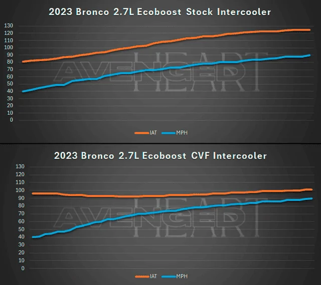

Did you lose any power once the pipes were heat soaked?
The biggest thing to cause heat soak, is the dang stock intercooler. That thing just does not like to keep things cool even without mods.
I was seeing temps jump almost 40⁰F from a 40-90mph with the stock intercooler and then installed the CVF intercooler and the temperature literally went backwards during another 40-90mph pull. So I recommend getting the CVF hot/cold pipes and intercooler as a complete package if you want to see real results against heat soak.
