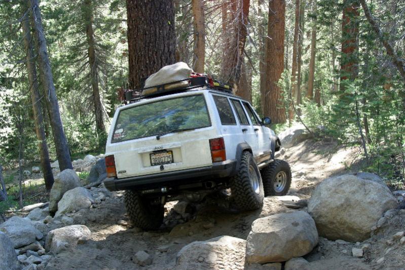

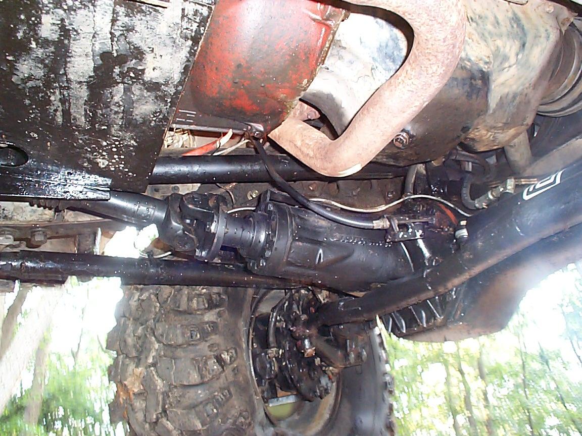

Personally I would like a 31+ spline 9" especially with the deep gearing as a 9" gains pinon/ring gear contact as the gears get deeper. My 76 Bronco had 28 spline 9" & my XJ ended up with a custom Currie 31 Spline 9". Anyone see a trend :p

Shame the high pinion 9's are so much, I've been spoiled with that, especially front that keeps my driveshaft out of the way and allows rear steer, on front axle.
