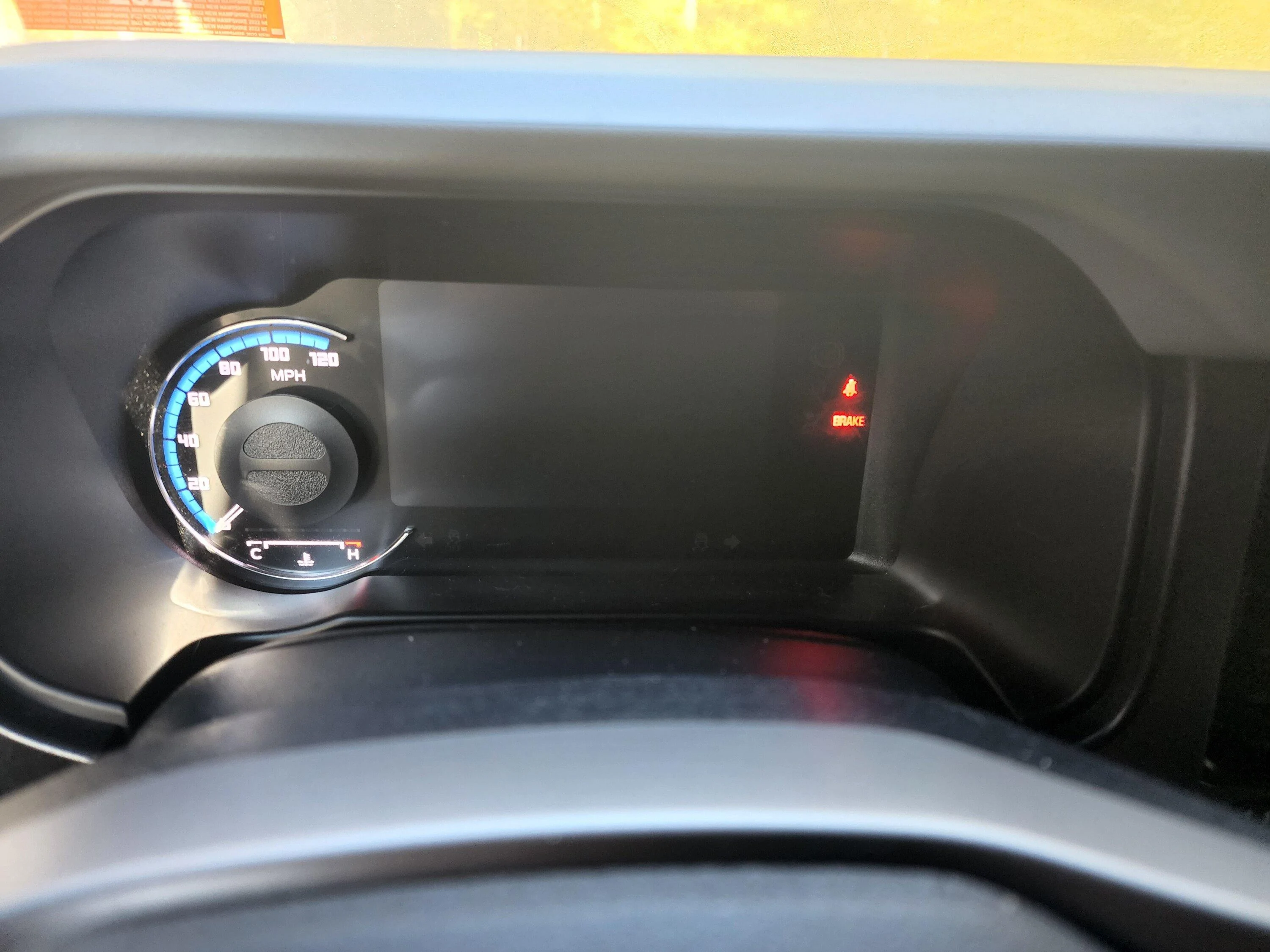

I've had the Bronco since Jan. I have almost 20k miles. For the past month the dash has been blacking out every day. I have brought it to Ford and they continue to not "see" and it's not throwing a code. Dealership has called Ford. Getting annoyed. I've seen others say it's the cluster. They don't want to replace it yet.
Hey there! I can look into your Bronco’s dashboard concerns on my end if you’d like. Will you send us a private message with your VIN and dealership info?

Hi there! Mind DM'ing me your VIN? I'd like to look at your VHR and OTA dashboard. It's likely the cluster but want to see if there's anything obvious that could be causing it.

I also got my Bronco in January and am experiencing the same issue. I’ve noticed it’s affected by temperature. I had problems off and on in the Spring - always in the morning and always when the temperature was below 54 degrees. It worked fine all summer, but now that the mornings are cool, it is happening again (same as before - below 54 degrees). We’ve tried checking all the connections, fuses, disconnecting the battery, and nothing has corrected the problem. I’m curious to hear what you find out - I’ll be taking mine in for an oil change in the next few weeks and planned to have them take a look. I just worry they won’t be able to recreate the problem because it only ever happens in the early morning.
