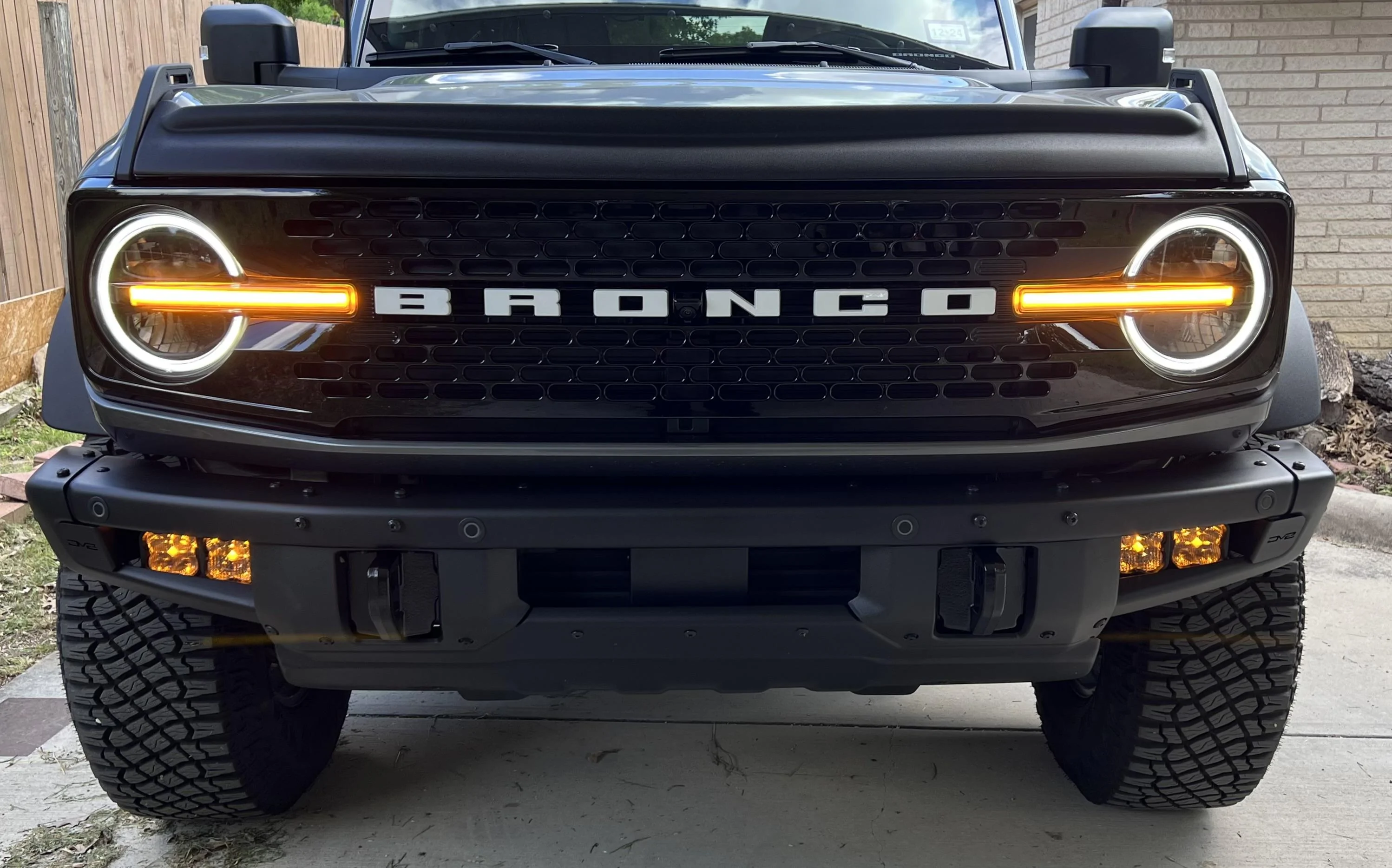

Yup did the forscan mod myself, think it looks a LOT better this way.
So this is what it looks like when the lamps are on "auto"? Is there a way to have JUST the orange bars come on without the white? Or, so that when you turn on the "parking lamps" (on the switch just above auto) you would get just the orange bars? That's what I want to try and do... You are right, though. What you did is already a big improvement!
No, what you see above is what you get. And when the headlights come on they revert back to white… and no, there’s no way to override that. Although you can do it in the asbuilt its simpler to do it in the plain text.
BdyCM Right (left) Front Turn Lamp Usage:
Old Value = Turn Only
New Value = Turn and DRL

following now, I didn';t realize i could do this, and if you can do just the bars, ill be booting up Forscan this weekend.
Yea unfortunately only the bars. But for what they are they’re pretty bright. It would be cool if we could do the ring too

Change the first 2 bytes of line 726-43-01 to "0101". They will be amber until the headlights come on then change to white. The halos are not capable of being amber. The only reason the horizontal bar can be is because it uses amber already for the turn signals. However you could go with Morimoto, Alpha Rex, Oracle or even factory Raptor lights for an amber halo.
No, I understand the bars are the only part that have the ability to be yellow. Unless you have the raptor headlights. I was just trying to see if you could illuminate the orange bars without illuminating the rings at all.
I used option 4 (DRL, turn, and position) but on mine they stayed orange even when the headlights were on. only issue I found was they didn't flash when turn signals were used. Did you have the same issue? I tried the other options as well, and they all did this. The only time I can get them to flash is when set to "turn only"
I’ve not tried them with option 4 as when I was doing some research I’d seen other folks saying they lost turn signal functionality as well. Mine has been working perfectly for quite some time now set to Turn + DRL (blinks correctly w/ turn signal) but yeah they still revert to white when the lights come on
