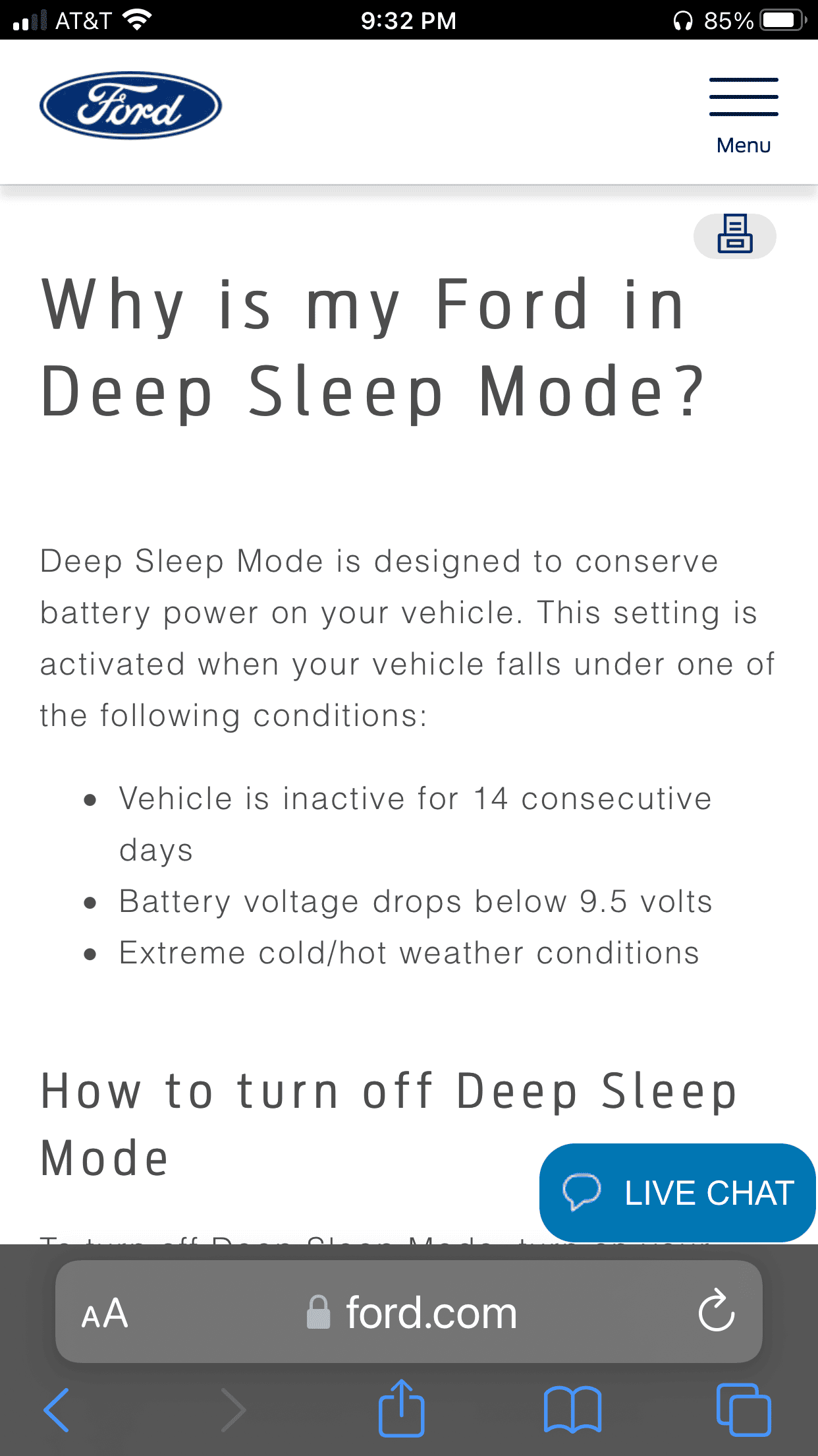

I checked info on Deep sleep mode. Here’s what Ford says:
Ford Bronco Deep Sleep Mode 646851A3-0C1A-461A-A46A-8C0F223859A0
None of these conditions apply to me. As a matter of fact, I just got back from a trip and all gauges were normal. Apparently it can just come on randomly 🤨
