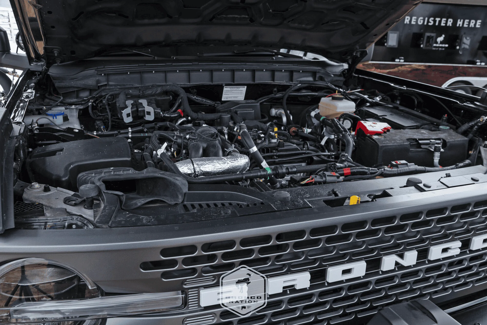

It’s relatively easy to extend the diff breathers/transmission/transfer case breathers on your own. Air intake is from the fender well I’m pretty sure. I’m sure someone will make a snorkel eventually. It would be prudent to apply dielectric grease to electrical connectors under the vehicle (axles, transfer case plugs, etc) if one’s going to be doing deep water crossings on the regular

A lot of times it’s best to relocate breathers. Toyotas I have had all needed to be relocated, despite the FJ claiming 27” fording depth. It’s an easy afternoon job, I think it was $100 or so for a pre-made kit. It’s cheap insurance agains water getting in.
