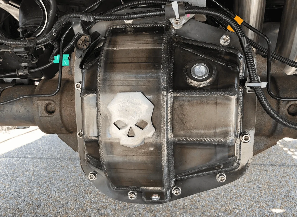

you don't need to relocate the breathers. on my Raptor, the rear diff breather is routed and sits right under the bed. In order to get above it you would have to submerge the entire back tire. Doing this means you are way past what is recommended.

Invest in your $$ in a rear diff that can be easily drained and refilled without removing the diff cover. The oem diff cover does not have a drain so if you are the type who reg submerges your diff then replace the oem one. This is what I have on my Raptor.

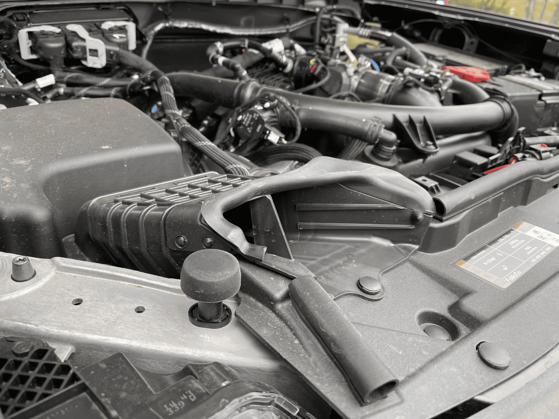

I asked where the vents were for said components at the event on the 10th and have not heard back. This is a big deal to me.
Air inlet is right side under the hood as shown in the pic. They told us the inlet tube from the opening to the air filter box has a purposely built in drop and valve to allow water to drain before it turns into a hydro lock problem. I'm sure there are limitations to how much water it can take before it's unable to keep up but there is an additional layer built into the system.

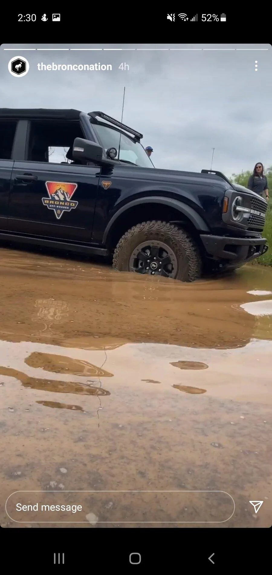

Can't upload the video but the guides basically said you need to go fast enough to create a bow wave which creates a trough so not as much water get's into the engine bay area. Too fast and you are pushing water over the hood and creating a situation where water enters the air intake or fuse/smart junction box. I know this is nothing new for folks with experience but makes sense but it allows us to educate customers that have little or no experience, like myself. Last thing anyone wants is explain is why the engine is locked up after driving it like they do in the commercials.
