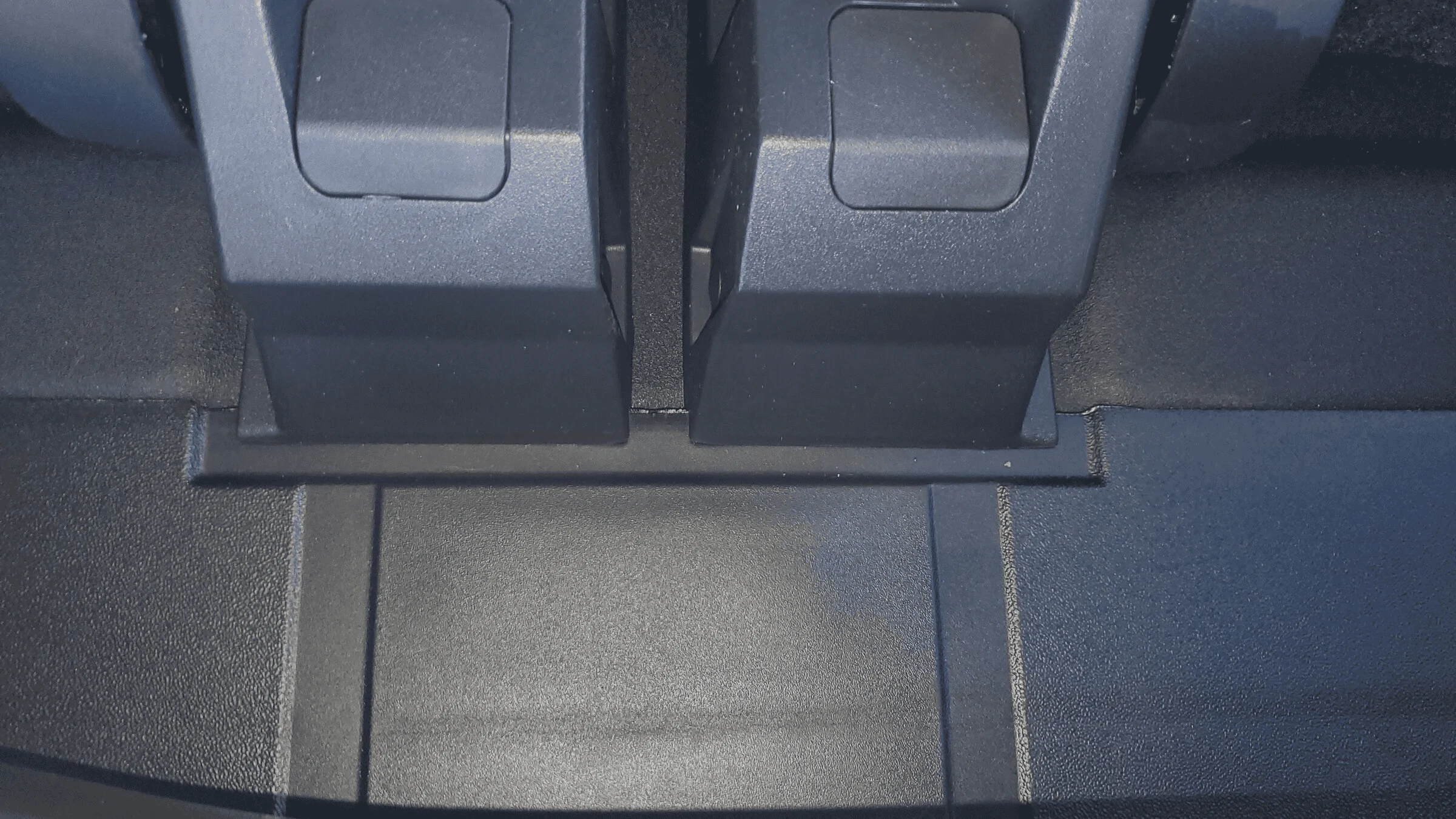

Here is one for the cargo area with wash out flooring (this is a 2-door Badlands).
Cargo floor installed incorrectly at factory and not flush at the seats. The center of the cargo floor has a noticeable hump and is raised about 0.5 inch (it is really difficult to capture this in a photo, so I circled it in red). Here is what mine looks like:
Ford Bronco DELIVERY CHECKLIST  (OCD Version) for Expectant Bronco Owners 1645205125630
Notice the thin black recessed area of the floor is "caught" on the seat brackets and can't be pushed down any further.

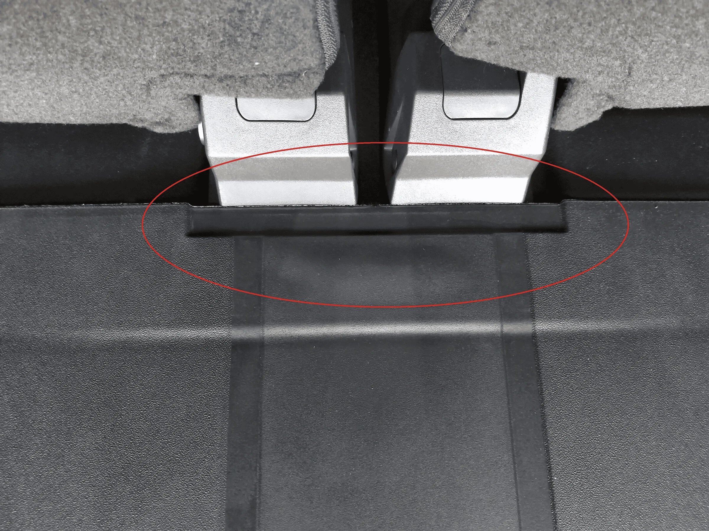

It should be under the seat brackets like this:
Ford Bronco DELIVERY CHECKLIST  (OCD Version) for Expectant Bronco Owners 1645205424920
Thanks to @flip in this post, he provided the instructions for removing the "loadspace floor covering".
Thanks, added.

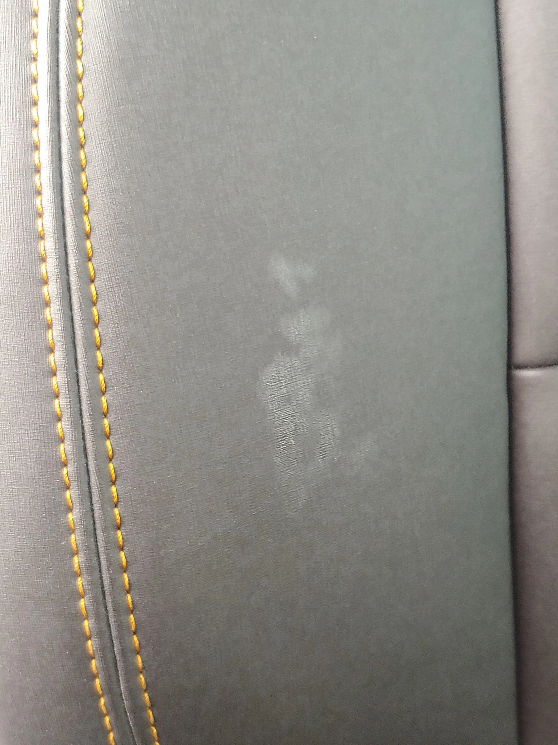

@Cat, I forgot to mention this earlier, but maybe something to add to the list. I didn't catch it until after I left the dealership. I think it's a chemical reaction, it won't come off.
Ford Bronco DELIVERY CHECKLIST  (OCD Version) for Expectant Bronco Owners 20220202_082710
Thats a shame.
Inspecting the seats is an item on the OCD.
Thanks for posting the pic here.
