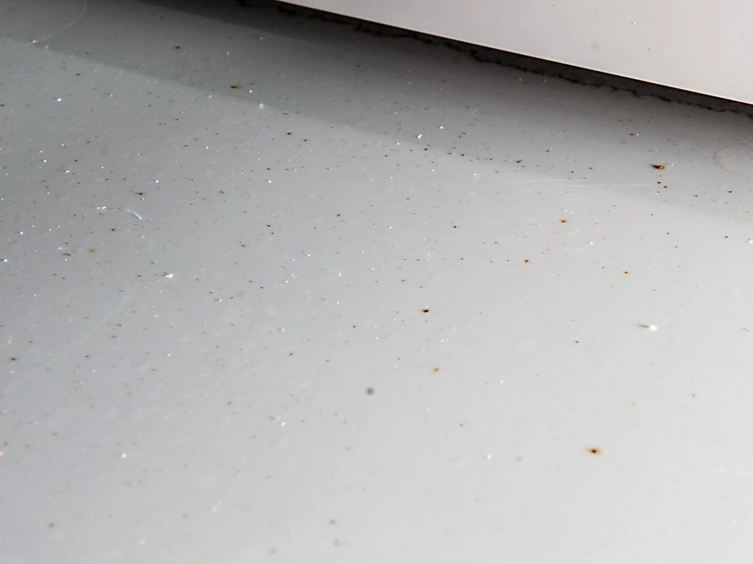

Here's what it would look like, it's much more visible on white vehicles
There are specific soap products that remove iron and help with that. Also specific soaps that give you a "clean slate" and remove any wax, polish, etc.. Then clay, compound (if needed), polish, glaze*, seal*, wax*. Or swap steps w/ * for ceramic if so inclined. So for example in the right order...

A must is to inspect for rail dust which is small brown/orange specs on the paint which lead to rust. But don't have the dealer fix it because they will destroy your paint in the process, take it to a professional detailer or do it yourself. To remove it you need a clay bar, some kind of lube like a quick detailer. That combo should remove it but I'd recommend trying an iron remover product as it will not scratch the paint like a clay bar will. After the clay bar you will likely need paint correction, the rail dust has been fairly common on ford vehicles, also paint overspray which leaves the paint feeling rough. That also needs to be clayed.
A full paint correction when the car is new is a smart first step, glad you pointed it out. Don't forget to first shampoo, then use the Iron X spray to release the metals, then clay bar, polish, and apply a sealant.

Even when new, there are a lot of crap on your paint even when fresh off the truck. A paint correction removes all of the ferrous metals from brake dust mostly, but also rust, rail dust (metal), as well as dirt, etc.
You can't usually see it immediately, but if you wash your car this weekend, dry it, then put a cheap plastic bag on your hand and run over the hood. You'll notice it'll catch even though the car looks clean; that's the ferrous metal from the streets.
