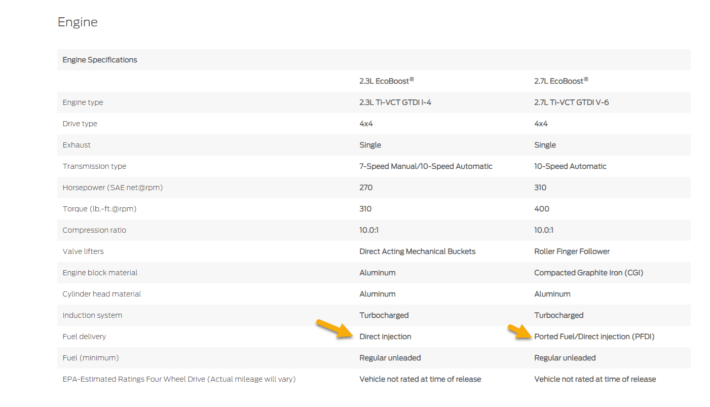

I really want to know this also. From my research in the past about my older 3.5L Explorer Sport, the more modern ecoboost's fixed this by adding both Direct, and Port injection. The 2.7 in the bronco says it has both, but the 2.3 only says it has the one..... why the heck didn't they add both? I don't know anything about engines, so maybe the 2.3 just doesn't suffer the buildup?

Well yes, 2.7 doesn't BECAUSE of the improvements made, but I was wondering if they didn't think the 2.3 would suffer the same buildup, hence why they left it at only Direct injection?

some info on the 2.7
https://www.motorreviewer.com/engine.php?engine_id=146
info on the 2.3
https://www.motorreviewer.com/engine.php?engine_id=135
and info on the 2.0 which the 2.3 is based
https://www.motorreviewer.com/engine.php?engine_id=134
based on the links above for the 2.3 and 2.0...it does NOT appear to have "dual" fuel injection like the 2.7...a review of the emission / EGR system on the 4 cylinder engine may provide a clue???
CRC the aftermarket chemical/cleaner company has a product that they claim will clean deposits, but I don't think it is "Ford" approved...
biggest issue on the 4 cylinder that I remember is the head gasket failing ( Focus ST) ...by now, Ford should have fixed the head gasket issue...hth
